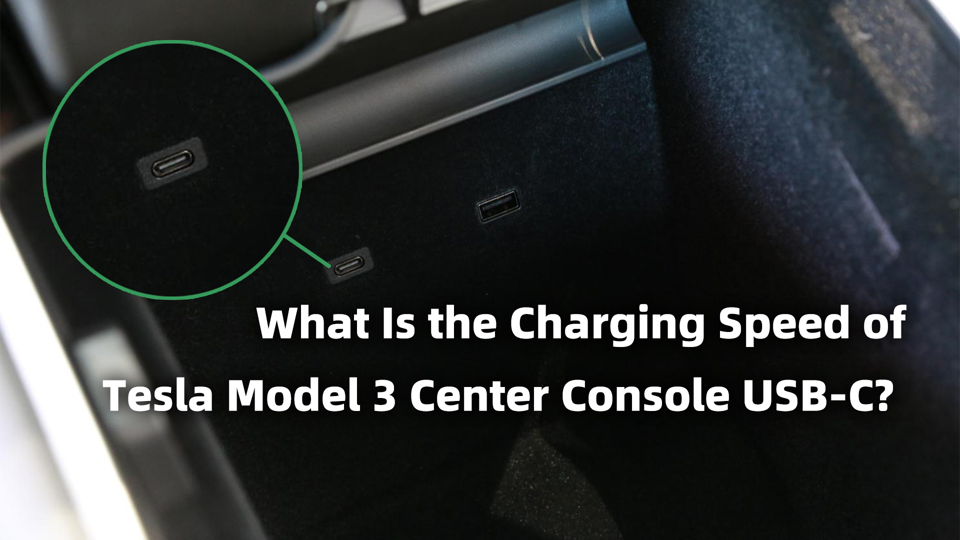

Speaking of the charging performance of Tesla EVs, both the Model Y and Model 3 can charge at Tesla's Supercharger network, which offers fast and convenient charging across the country. As for the included USB-C port, we conducted a compatibility 100 test for the more expensive version - Model Y - about a month ago, and it successfully passed our test.
What Is the Charging Speed of Tesla Model 3 Center Console USB-C? - ChargerLAB Compatibility 100-Chargerlab
And recently, we also presented a compatibility 100 test video for the Tesla model 3. Now, we will provide a detailed textual description, including more data, to give everyone a clearer understanding of the charging compatibility of this EV.
First, the USB-C of the Tesla Model 3 center console supports PD3.0 and DCP charging protocol. And it has only two fixed PDOs of 5V3A and 9V3A.
