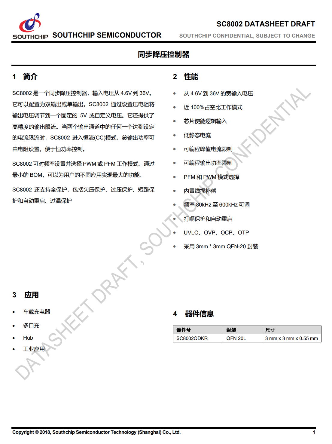

The synchronous buck controller is also from Southchip. Model is SC8002. It can be used as a dual or single output, and the input voltage can be from 4.6V to 36V.
Here is all the information about Southchip SC8002.
