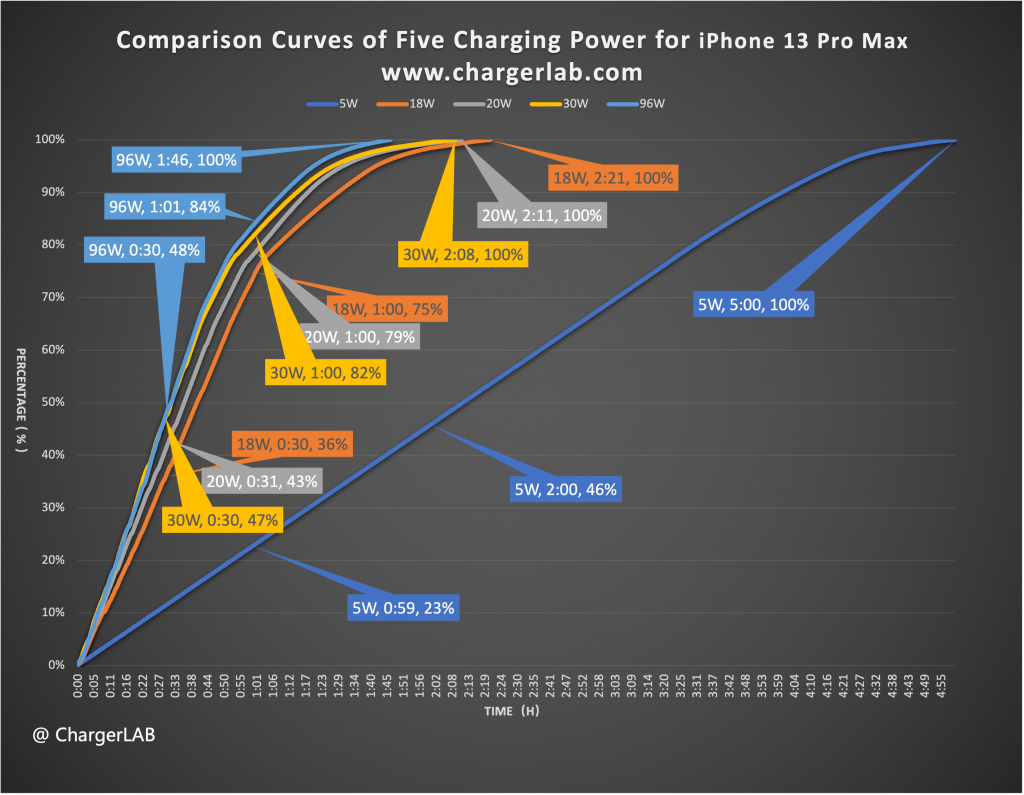

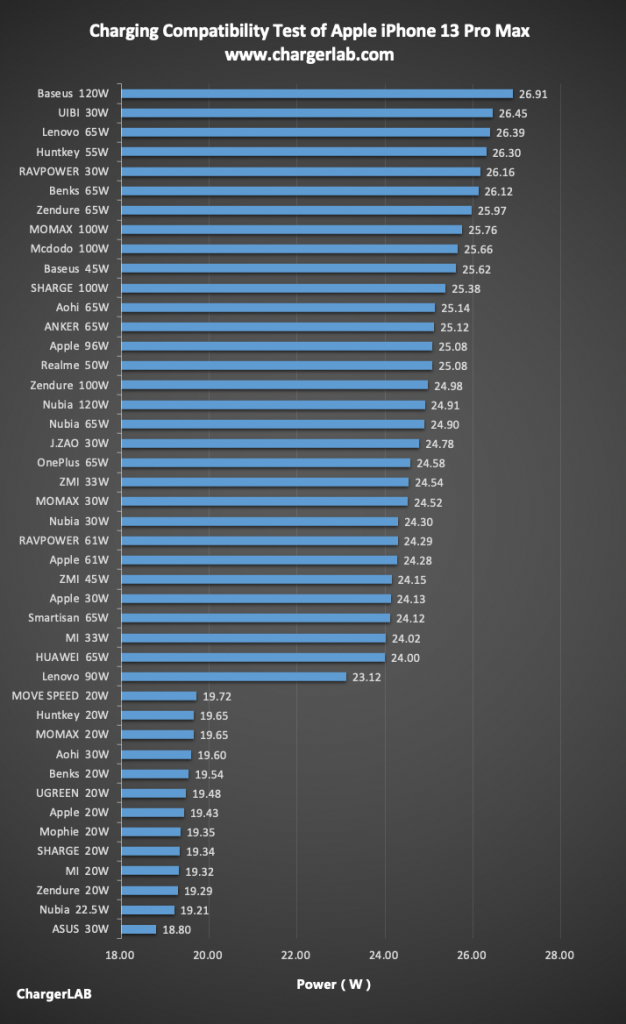

As soon as we got the latest iPhone 13 Pro Max, we have done tons of charging tests on it, and please feel free to choose the part you're interested in.
ChargerLAB found that the peak charging power of the latest iPhone 13 Pro Max has reached 27W. So for this model, a 30W charger will be a good choice.
Up to 27W | Charging Compatibility Test of Apple iPhone 13 Pro Max (20W-100W)-Chargerlab
This model has the largest battery capacitor among all iPhone 13 series. So, it also has the longest charging time. After our testing, we found the 96W is the fastest charger to fully charge the iPhone 13 Pro Max.
Considering the large size of 96W, 30W is the better option to carry around.
