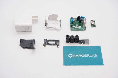

Now that we have completed our unboxing and testing of this charger, it's time to take apart the device and examine its internal components and structure.
Ultra-Slim & GaN | Teardown of Baseus 65W Charger (CCGAN65C5-UT)-Chargerlab
Next, let's use the spudger to pry along the gap of the input end.
The input module is inserted here and is connected to the input wires through white and purple wires.
Next, remove the small cover on the output end.
But we cannot take it out and have to get help from "cutting machine."
Finally, we can see the entire PCBA module.
And disconnect the input module from the main PCB.

All components are placed horizontally to reduce the thickness.
And the largest component, the transformer, is placed in the hollow of the PCB, the thermal pad is pasted around the transformer for heat dissipation.
First, let's take a look at the front of the PCBA module. In the bottom left corner, we have the AC input end, which includes a fuse, NTC thermistor, safety X2 capacitor, and common mode choke, among other components. In the top left corner, we can see the high-voltage filtering capacitor, located right next to the planar transformer. On the right side, there is the secondary buck circuit, consisting of two inductors, filtering capacitor, and USB-A and USB-C sockets.
On the backside, there are the bridge rectifier, GaN IC, synchronous rectification controller, and buck chip.
ChargerLAB found it adopts QR flyback topology and is equipped with a synchronous rectification circuit to output the fixed voltage, then, the output circuit and protocol chip control the output power. Next, let’s introduce all components inside, starting from the input end.

One last look at all the components of this Baseus 65W Ultra-Slim GaN Charger.
Thanks to the planar transformer and compact design of internal components, it can fit into your pocket easily. Unlike most PD chargers, the USB-A port provides up to 60W output power. With the other USB-C port, it can charge your primary device and some accessories at the same time when you're traveling.
