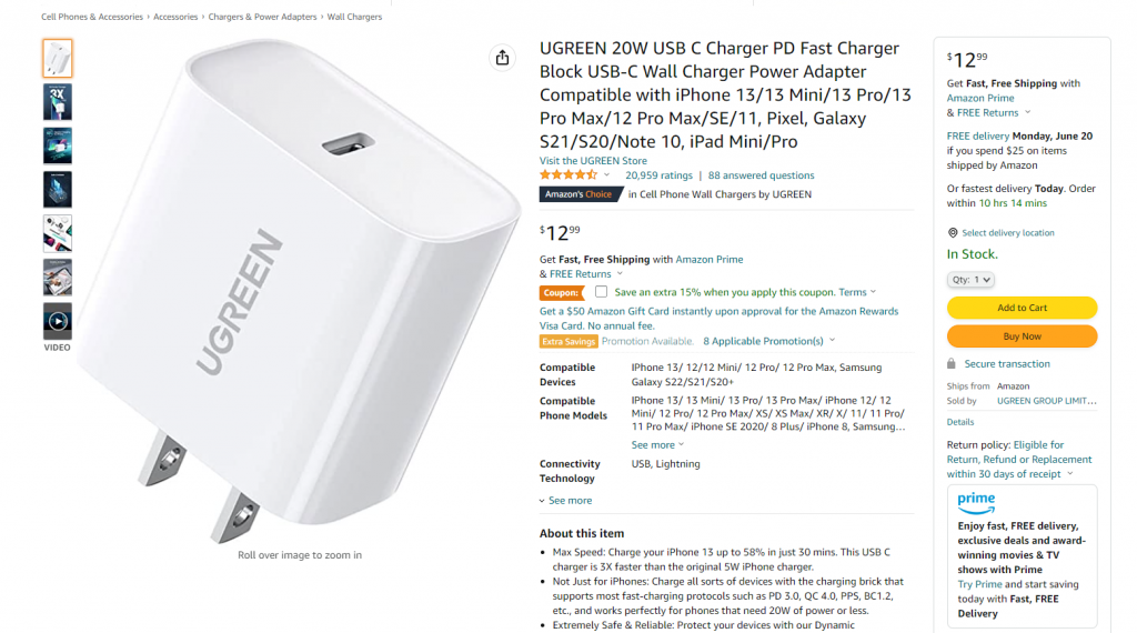

Today we will take a look at the Amazon PD charger list. One impressive product on the Wall Charger list is the UGREEN 20W USB-C fast charger.
From the product page, we know that the UGREEN 20W USB-C fast charger has received 20959 reviews and has a 4.7-star rating out of 5 stars, making it one of the top products in its category.

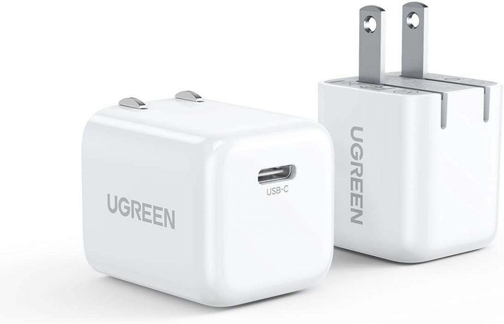

UGREEN 20W USB-C fast charger has a single USB-C port, which slightly concaves. UGREEN logo is printed on a glossy surface, and the PC flame retardant casing keeps with the other UGREEN chargers.

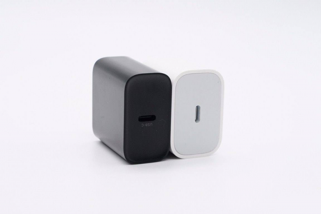

Its size is 43.13 X 42.48 X 23.56 mm (1.69 X 1.67 X 0.92 inches), close to the Apple 20W charger. It supports input of 100-240V 50/60Hz and multiple protection measures, like over-temperature, short-circuit, lightning, and over-current protection.

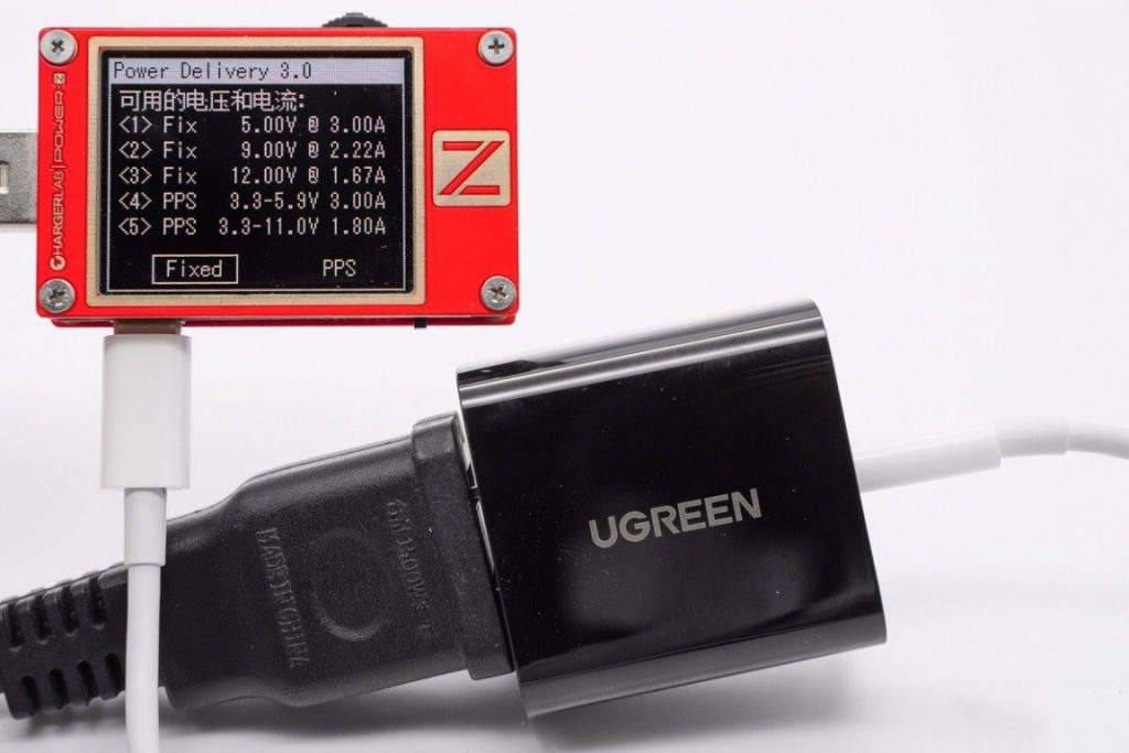

The ChargerLAB POWER-Z KT002 shows that the charger is based on the USB PD3.0 fast charging protocol. It supports three fixed PDOs of 5V3A / 9V2.22A / 12V1.67A and two PPS of 3.3-5.9V / 3.3-11V1.8A.

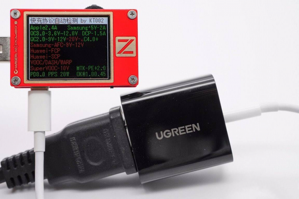

In addition to the USB PD fast charging protocol, it also supports Apple2.4A, Samsung 5V2A, DCP, QC3.0, QC2.0, MTK PE+2.0 and other common protocols, suitable for old and new devices.
