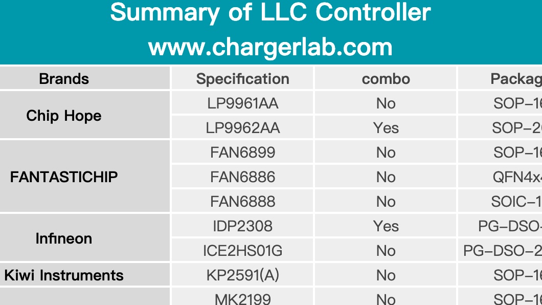

ChargerLAB has compiled several popular PFC + LLC combo controllers available in the market, as listed below. Let's now delve into the parameters and features of each controller.
Twenty LLC Controllers for High-Power E-Bike Chargers: ChargerLAB Analysis-Chargerlab
The following manufacturers are listed alphabetically.
