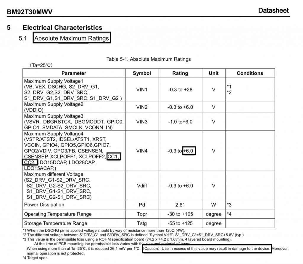

It appears that the Switch uses an M92T36 Power Delivery chip - and that's the part that most frequently burns out after use of third-party charging equipment.
Though the exact data-sheet of the M92T36 isn’t available publicly, the M92T30 made by ROHM and seem to only differ only by operating voltage. In the specs, the absolute max voltage rating for the Configuration Channel (CC) pin to be 6 volts. This means voltage traveling through the CC at more than 6 volts can and will fry the M92T36 chip.

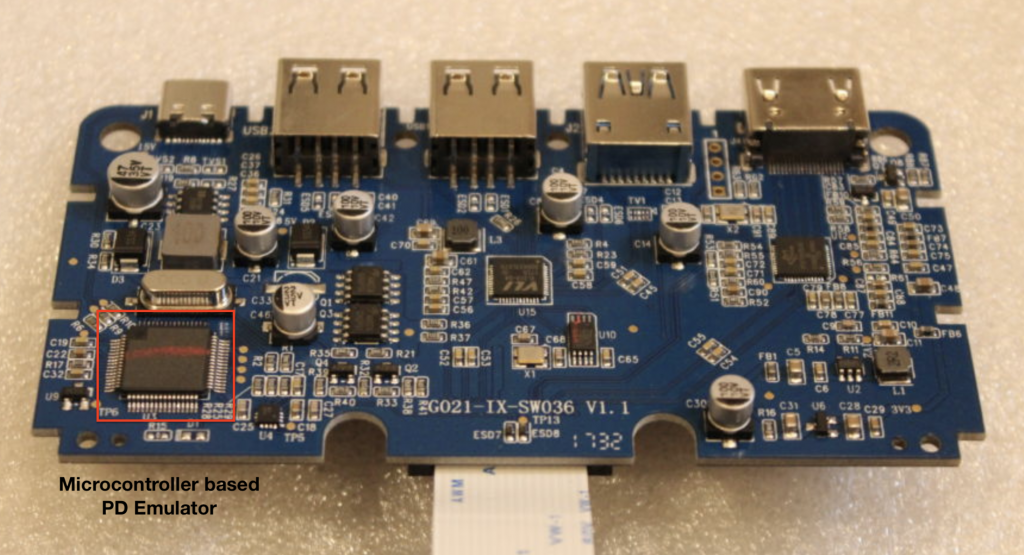

While a wide variety of third-party chargers and cables have been linked to Switch bricking, the most common complaints seem to center on a third-party dock made by Nyko. Like many cheap USB-C chargers, the Nyko dock does not actually have a dedicated PD controller; it instead implements the PD protocol using a general-purpose microcontroller - and that microcontroller was sending 9V to the Switch over the CC pin, exceeding the absolute maximum voltage rating by 50%, and killed the M92T36 inside the Switch.
