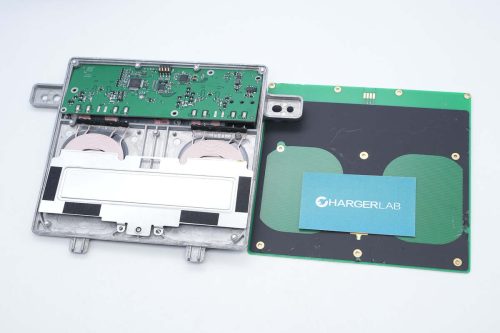

Teardown of Tesla Wireless Phone Charger (WC5)-Chargerlab
First, unscrew the fixing screws of the aluminum alloy shell and remove the panel.
The shielding plate is fixed by stamping, and there is an NFC coil in the area corresponding to the wireless charging.
The shield plate is printed with TESLA.
Remove the shielding plate, there is a metal shielding cover and wireless charging coils inside.
There is cushioning foam and NFC coil contacts on the back of the shield.
The metal shielding cover has a hole to expose the NFC coil contacts.
Buffer foam is arranged inside the shielding cover and the shielding plate.
Remove the shielding cover and the PCBA module is fixed with screws.
There are two wireless charging coils on the left and right.
Each charging position has two coils stacked together to increase the charging area.
The PCBA module is fixed with screws.
Unscrew the fixing screws of the PCBA module.
There are pink potting compounds at the location of the heat-generating components, which dissipate heat through the aluminum alloy shell.
One side of the PCBA module is soldered with the wireless charging master control chip, NFC communication chip, MCU, and LIN and CAN communication chip.
The other side of the PCBA module has a power socket, a synchronous buck converter, two wireless charging power stage chips, a buck inductor, and a filter capacitor.
Well, those are all components of the Tesla Wireless Phone Charger.
Here is the component list of the Tesla Wireless Phone Charger for your convenience.
The panel of the Tesla WC5 wireless phone charger is made of leather material, with an aluminum alloy shell inside to enhance heat dissipation, and is assembled with clips and screws. The module has two wireless charging positions, separated by a protrusion, supporting the charging of two phones at the same time.
After taking it apart, we found it uses the NXP MWCT22C3AVLH master control chip and the MPS MPQ4272 synchronous buck converter to power two MPQ4280 full-bridge power chips. The module uses automotive-grade components and is made of solid and reliable materials.
