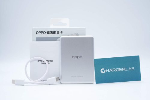

The box contains the power bank, a dual USB-C cable, and some documents.
The connectors of the cable are made of flame-retardant PC.

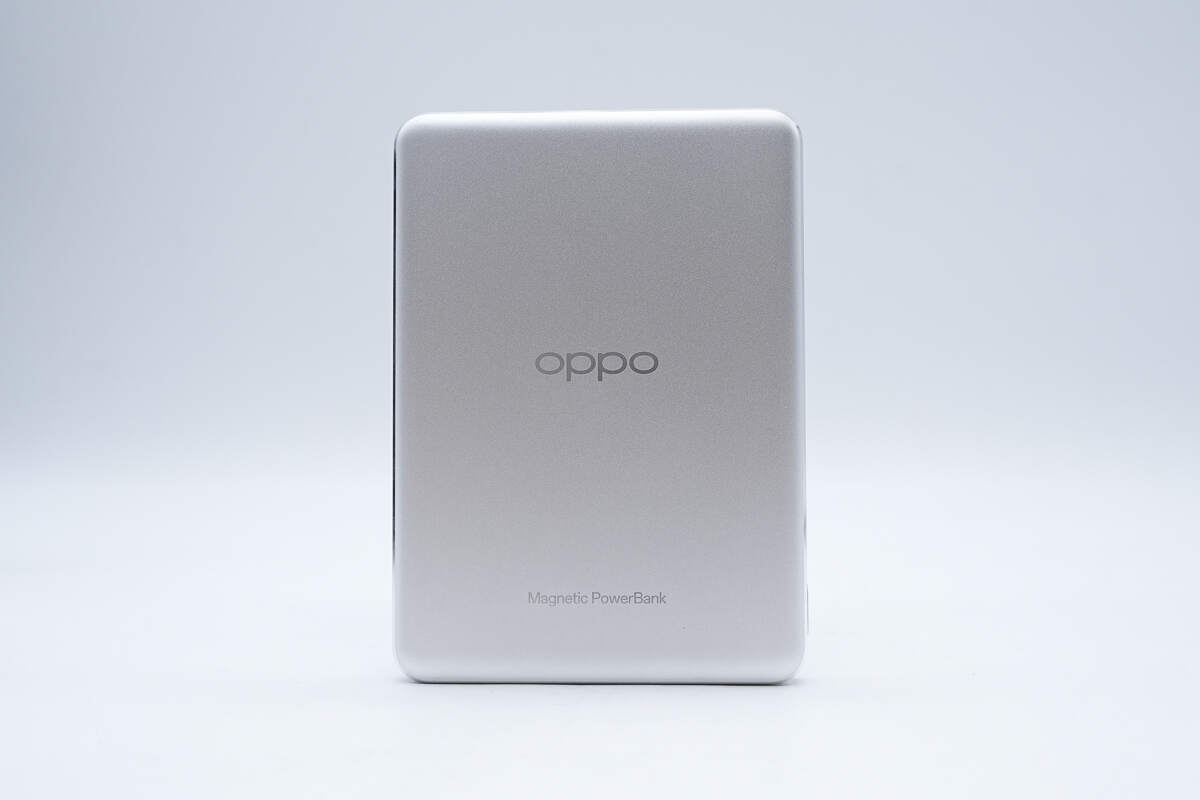

The power bank is silver in color and its shell is made of aluminum alloy.
The round raised area on the front is the wireless charging area.
The OPPO logo is laser engraved on the back.
The switch button is on the right.
The indicator lights are at the bottom.

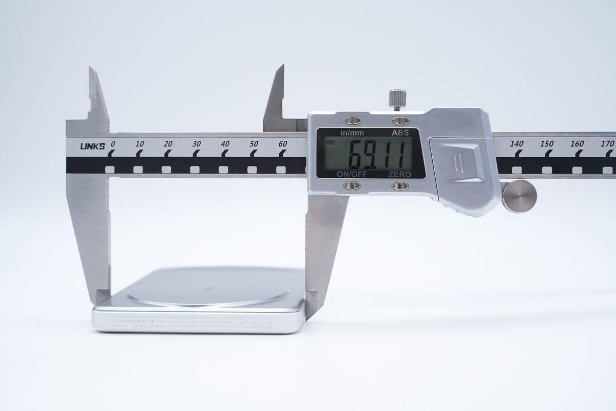

The length is about 96.19 mm (3.79 inches).
The width is about 69.11 mm (2.72 inches).
The thickness is about 10.36 mm (0.41 inches).

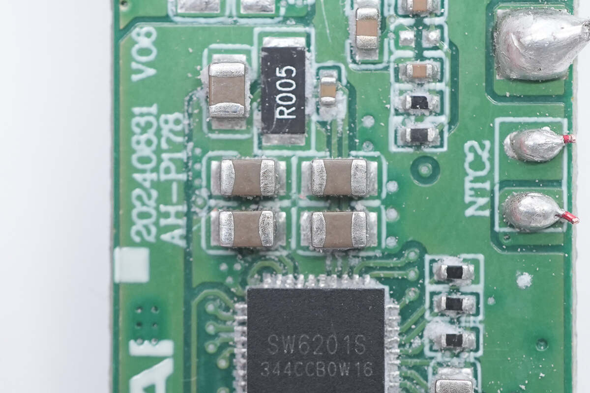

Clean off the potting compound. There are four resonant capacitors, a wireless power transmitter, and a wireless charging master control chip on the back.
The master control chip is from iSmartWare. This is a highly integrated multi-protocol bidirectional fast charging power bank dedicated all-in-one chip. It integrates 5A high-efficiency switch charging, 22.5W high-efficiency synchronous boost output, and multiple fast charging protocols such as PPS, PD, QC, AFC, FCP, PE, and SFCP. Model is SW6201S.
There is the information about iSmartWare SW6201S.
The alloy inductor is used to improve conversion efficiency. 2.2μH.
