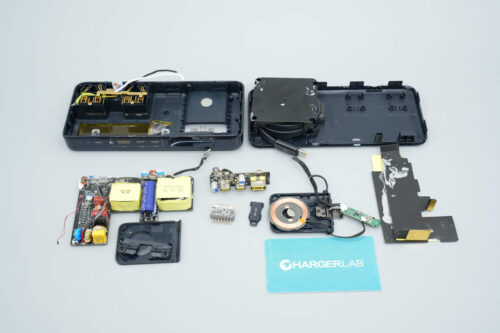

The Mercedes-Benz V-Class original 36W charger looks like a general car charger, but actually, it isn't.
It is a part of the car itself, which connects to the power by its metal plug instead of a cigarette lighter. ChargerLAB has gotten it, and we will take it apart.
Schottky diode: SS54
Filter Solid Capacitor for Input: Yunxing Electronic (100μF 35V)
Buck Protocol IC for USB-A: iSmartWare SW3521
Buck Output Filtering Solid Capacitor: Yunxing Electronic (25V 220μF)
Buck Protocol IC for USB-C: iSmartWare SW3522
Solid Filter Capacitor: Yunxing Electronic (25V 220μF)
