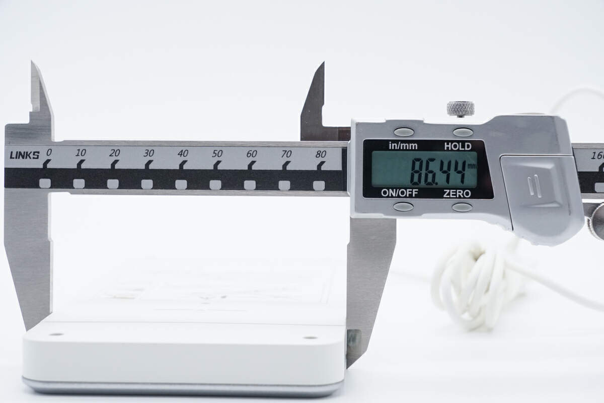

The width is about 86mm (3.39 inches).
Teardown of IKEA SJÖMÄRKE Wireless Charger (E2018SJÖMÄRKE)-Chargerlab
