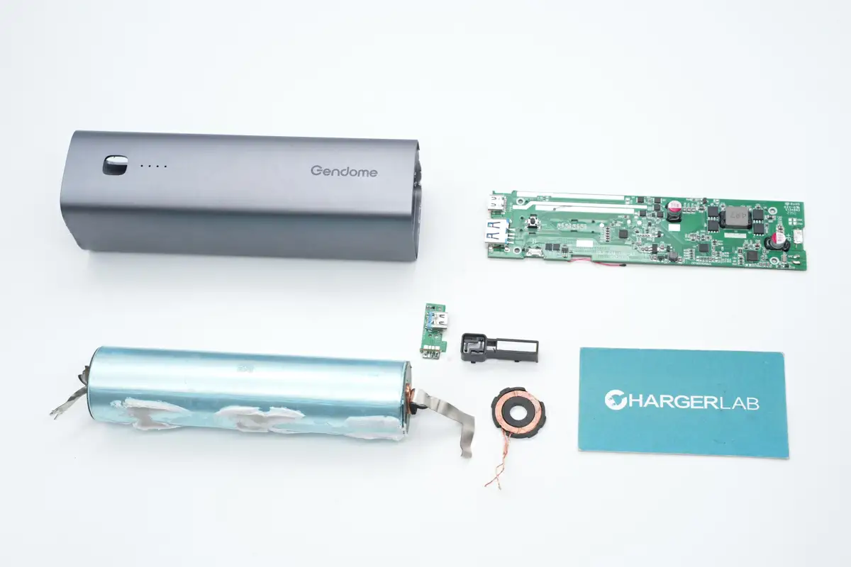

After the product's appearance, let's start to take it apart.
First, remove the cover of the wireless charging panel.
Inside the cover are the fixing screws and the wireless charging coil.
The wireless charging coil is wound with Litz wire.
There are the screws for fixing.
Unscrew the fixing screws and push out the internal movement.
The PCBA module is fixed inside the plastic frame.
The battery is also fixed inside the plastic frame and cushioned with foam.
The PCBA module is fixed to the frame by screws.
This is the screw that fixes the PCBA module.
The wireless charging coil is connected by soldering.
Unscrew the fixing screws, separate the connection between the battery and the PCBA module, and remove the battery and the PCBA module from the frame.
The USB-C and USB-A sockets, power detection button, protocol chip, VBUS MOSFET, synchronous buck-boost circuit, and wireless charging chip are on the front of the PCBA module.
A thermistor is soldered on the back to detect the battery temperature.
The buck-boost chip is from SouthChip. It integrates an I2C port and supports input and output voltage ranges of 2.5-36V. It has under-voltage protection, overvoltage protection, and overcurrent protection. Model is SC8815.
Here is the information about SouthChip SC8815.
This is the alloy inductor and synchronous buck-boost MOSFETs.
The MOSFET of the battery side is from Tuofeng and adopts PDFNWB5 x 6-8L package. Model is TF025N06NG. 60V 2.5mΩ.
The two MOSFETs at the output end are of the same model.
The specification of the capacitor for input filtering is 100μF 16V.
The specifications of the solid capacitor for output filtering are the same.
The master control chip for wireless charging is from Injoinic. It is compatible with the latest WPC, Qi, and V1.3 standards, and supports 5W, Apple 7.5W, Samsung 10W, and 15W wireless charging. Model is IP6829.
Here is the information about Injoinic IP6829.
The protocol chip is from Chipsea. It has a built-in 8-bit RISC core, built-in 32K*16-bit FLASH, and built-in 2K SRAM. It supports fast charging protocols such as QC4, SCP, FCP, and AFC. Model is CSU3AF10.
These five VBUS MOSFETs are from Yieternal and adopt PDFN3333 package. Model is ET6303. -30V 8.5mΩ.
These four LED lights are used to indicate the remaining battery capacity.
The SMD button is used for power detection.
The battery protection chip marked with 12AB is from Hong Kang.
These two battery protection MOSFETs are marked with L2030.
The boost chip marked with Y5UH is from Microne.
This is the boost inductor. 22μH.
The regulated MOSFET used to regulate the output voltage is from Microne. Model is ME6203. 3.3V.
This is a thermistor used to detect the battery temperature.
Here is the blue USB-C socket.
The USB-A socket is also blue.
A thermal pad is pasted on the inside of the plastic frame at the position corresponding to the PCBA module.
The battery is glued inside the frame.
The positive terminal of the battery is connected with a nickel sheet.
The negative terminal of the battery is also connected with a nickel sheet. The blue plastic film pasted on the explosion-proof valve indicates the negative terminal.
The length of the battery is about 140 mm (5.51 inches).
The diameter of the battery is about 33 mm (1.3 inches), and it is a 33140 battery.
The battery is marked with 15AH and 48Wh. The battery type is LFP and the rated voltage is 3.2V.
Well, those are all components of the Gendome 15000mAh 20W Power Bank.
It has two USB-C ports and a USB-A port, supporting 20W output and 18W input. There is a magnetic wireless charging area on one end. It adopts an aluminum alloy case for a long lifespan and the battery capacity is 15000mAh.
After taking it apart, we found it adopts a 33140 LFP battery. The PCBA module and battery are fixed in the plastic frame. The buck-boost chip is from SouthChip and the protocol chip is from Chipsea. The battery is equipped with a thermistor for temperature detection. The interior is compact and equipped with comprehensive safety measures.
