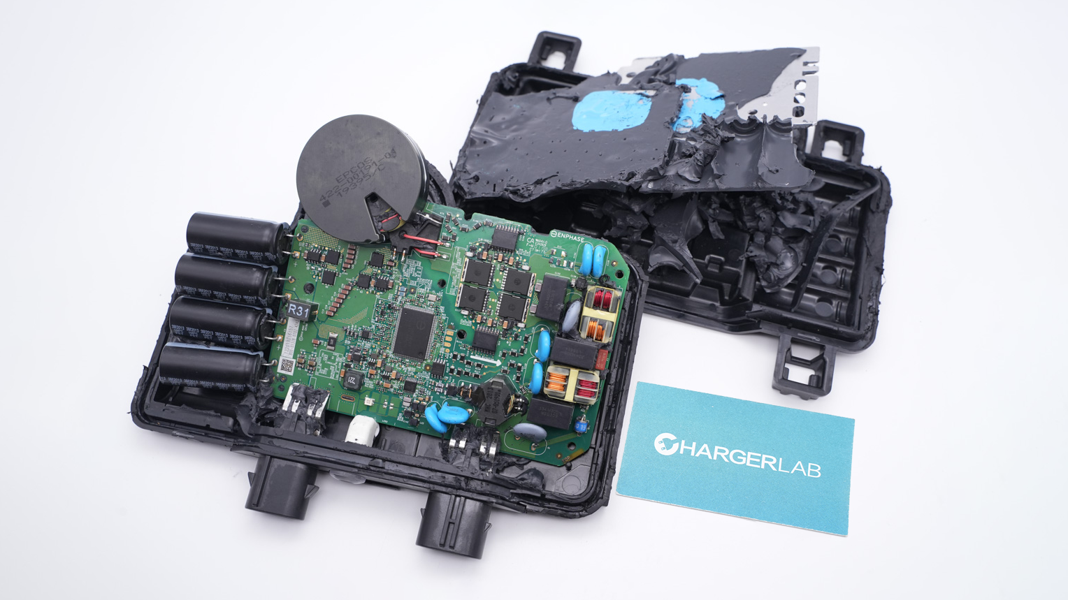

Use a spudger to pry along the gap.
Then heat it up with a heat gun.
Remove the case.
It's filled with massive black silicone adhesives for sealing and heat dissipation.
Clean up the adhesives.
Then, let's introduce the major components.
They are four capacitors on the left, and the inverter transformer is at the top. The low-voltage MOSFET for boosting and the corresponding driver are on the bottom, and two circuits for output filtering and power line communication are on the right.

Take out the entire module, then you can see a black aluminum heat sink on the back.
And no components on the back.
