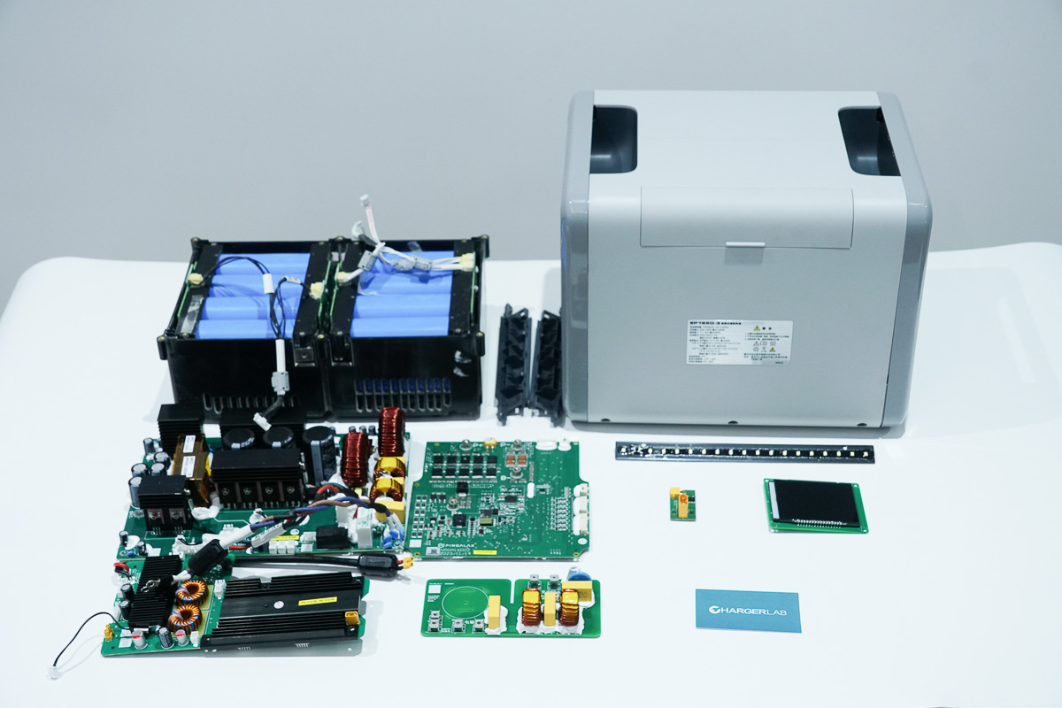

After the product's appearance, let's start to take it apart.
Teardown of EHOM EP1650 Portable Power Station (EP1650-3)-Chargerlab
First, remove the side bracket fixed by clips.
Unscrew the fixing screws and remove the side cover.
The battery pack and cooling fans are fixed inside the case.
The AC output wires are connected via connectors.
The ground wire has a magnetic ring for anti-interference.
The two cooling fans are fixed with screws.
Remove the side bracket on the other side.
The side cover is fixed with screws.
Unscrew the screws and remove the side cover.
This side also has the battery pack and cooling fan.
The cooling fan is fixed with screws.
Unscrew the fixing screws on both sides of the case.
Take out the battery pack and bidirectional inverter module from the case.
The connecting wire passes through the magnetic ring to suppress high-frequency interference.
The input protection PCB and the fast charging output PCB are fixed on the case.
There are overload protector, varistor, safety X2 capacitor and common mode choke on the AC input protection PCB and EMI PCB.
The filter inductor is fixed with zip ties.
There are two heat sinks, inductors and the filter capacitor on the back of the fast-charging PCB. Both heat sinks are equipped with thermistors to detect temperature rise.
Here is the XT30 connector for the battery pack.
The fuse marked with 477 is from Betterfuse. 20A.
Here are the input wires connected to the DC input ports.
Here are the communications connectors that connect to the battery pack.
The MLCC capacitors for input filtering are connected in parallel.
The TVS marked with C70 is used for overvoltage protection.
These two MOSFETs are used for power supply control.
Here are two diodes.
One of the synchronous buck-boost chips is from RENESAS. It supports a working voltage of 60V and is used to charge the built-in battery. Model is ISL81601.
These four MOSFETs of the synchronous buck-boost chip are from PCsemic.
The other synchronous buck-boost chip is also from RENESAS. It is used for buck control. Model is ISL81601.
Here are the two buck MOSFETs.
The heat sink for the MOSFETs has a thermistor on the side.
These two inductors are wounded with magnetic rings and they're also insulated with bakelite.
These two electrolytic capacitors for input filtering are from CapXon. 100μF 100V.
There is also an electrolytic capacitor for input filtering with the same specifications.
The solid capacitor is from Winner. 100μF 100V.
There is another solid capacitor. 220μF 35V.
The MCU is from GigaDevic. Its frequency reaches 120MHz. It has a built-in Cortex-M4 core with 256KB FLASH and 48KB SRAM. Model is GD32F303RCT6.
This is the 8.000MHz crystal oscillator.
The buck chip is marked with A6163K.
Here is the SMD buck inductor. 15μH.
The wireless communication module is from ESPRESSIF. Model is ESP32-C3-MINI-1.
These two chips for transceivers are from MORNSUN. They are used for RS-485 communication to communicate with the battery pack. Model is SCM3406ASA.
The 8-channel switch used for signal acquisition switching is from Runic. Model is RS2251.
The Op-Amp used for signal acquisition and amplification is from Runic. Model is RS8552.
Both two buck controllers of the two USB-C ports are from iSmartWare. They support charging of any USB-C and USB-A ports and dual-port independent current limiting. Model is SW3516P.
The buck controller integrates a 5A high-efficiency synchronous buck converter. It supports PPS, PD, QC, AFC, FCP, SCP, PE, SFCP, and other fast-charging protocols. It can output up to PD 100W. It also supports CC/CV modes.
Here is all the information about the iSmartWare SW3516P.
There are two synchronous buck MOSFETs.
The heat sink of the buck inductor is glued on.
The sampling resistor is used to detect the output current. 5mΩ.
Here are two USB-C sockets.
There are two TVSs between the two USB-C sockets for electrostatic protection.
Here is the buck circuit of the USB-A ports.
The buck controller of the USB-A ports is also from iSmartWare. It integrates a 3.5A high-efficiency synchronous rectifier buck converter. It supports CC/CV modes. It supports PPS, PD, QC, AFC, FCP, SCP, PE, SFCP, and other fast-charging protocols. Model is SW3526.
Here is all the information about the iSmartWare SW3526.
Here is the buck inductor. 22μH.
The TVS is used for overvoltage protection.
There are three USB-A sockets.
The synchronous buck controller of the car port is from RENESAS. It supports a working voltage of 40V. Model is ISL81401.
There are two buck MOSFETs.
There is a button next to the buck inductor for DC output control. And there is an LED indicator light on the right side to indicate the output status.
The buck chip is from Silicon. It integrates MOSFET inside. It supports 5.5-100V input voltage and 2A output current. Model is SCT2A25.
There is the buck inductor. 47μH.
The back of the synchronous buck MOSFET is covered with a large heat sink.
This is the connector of the display.
This is the connector of the light bar.
These are the connectors of the thermistors.
This is also a connector of the thermistor.
This is the socket of the car port.
The buzzer is used for reminder.
The LCD is soldered on the front of the display module.
The driver chip and socket are on the back of the display module.
The driver chip is from i-Core. Model is CS1621.
Here is the socket of the display.
Unscrew the screws and open the bidirectional inverter module casing.
The fans are connected via these connectors.
The PCB of the inverter module is fixed inside the casing with screws. The components are reinforced with potting compound.
The AC input wires are connected by soldering.
Disconnect the cooling fans from the PCBA module and separate the upper cover of the inverter module.
The fan is from RUNDA. Model is RS7015B12VH-RA. 12V 0.26A.
The two fans on the other side are the same as the previous one.
Unscrew the fixing screws and separate the battery pack and bidirectional inverter module.
There are capacitors, MOSFET, transformer, filter inductor, safety X2 capacitor, common mode inductor, relay, and varistor on the front of the PCBA module.
Two MCUs are on the back of the PCBA module for primary and secondary control respectively, and the MOSFETs corresponding to the primary and secondary sides are driven by isolated drivers.
The MCU used for DC side control comes from GigaDevice. Its frequency can reach 120MHz. It has a built-in Cortex-M4 core with 512KB FLASH and 64KB SRAM. Model is GD32F303CET6.
There is the 8.000MHz crystal oscillator.
The MCU for AC control is the same as the previous one.
The three digital isolators used between the two MCUs are from NOVOSENSE. Model is NSi8221.
The six isolation drivers corresponding to the MOSFETs come from NOVOSENSE. Model is NSi6602BD.
This is the fuse of the DC side. 100A.
The sampling resistor is used to detect DC current. 0.5mΩ.
Here are the five electrolytic capacitors on the DC input.
These five electrolytic capacitors for input filtering from CapXon are connected in parallel. 1000μF 63V.
There is buck circuit at the input end.
The buck chip is from Silicon. It is used to power the drive. Model is SCT2A25.
These two primary MOSFETs are from PCsemic. There are insulating pads between them and the heat sink.
The other two MOSFETs are the same as the first two.
The magnetic core of the transformer is insulated by tape.
The magnetic core of the resonant inductor is insulated by tape.
These two resonant capacitors are reinforced with glue.
The filter capacitors are from CapXon. There are heat sinks on both sides of the filter capacitors, and the heat sink is also equipped with a thermistor for temperature detection. 330μF 500V.
Four MOSFETs are fixed on the heat sink.
The MOSFET is from PCsemic. Two on the left are marked with GEANGFD.
The two on the right are printed with RBANGFD.
There are also four MOSFETs on the other heat sink.
This is the cement resistor. 100Ω.
The relay is from SongChuan. The contact capacity is 12A and the coil voltage is 12V. Model is 507-2AH-F-C.
The relay is from SongChuan. The contact capacity is 17A and the coil voltage is 12V. Model is 507H-1AH-F-S.
This relay is also from SongChuan. The contact capacity is 16A and the coil voltage is 12V. Model is 210H-2AH-F-C.
There is the current transformer.
The blue Y capacitor is from STE.
The current sensor is from SINOMAGS. Model is STK-PL. 20A.
The specification of the filter capacitor is 220μF 35V.
There are two inductors.
There are safety X2 capacitors and common mode chokes.

It has a matte one-piece shell and two hidden handles on both sides of the top. It has LCD, USB ports, and AC inverter output ports on the front, as well as LED lights. It has a built-in LFP battery with a capacity of 1024Wh and supports a two-way inverter input of 1200W and an inverter output of 1650W. Each USB-C port supports fast charging of 100W and is independent from each other.
After taking it apart, we found it adopts a modular design. The interior is mainly composed of fast charging PCB, bidirectional inverter module, battery protection PCB, and battery pack. The power component is from PCsemic. The battery pack is composed of 16 40135 LFP batteries. The battery protection chip is from SinoWealth. The MCU used for communication functions is from GigaDevice.
The bidirectional inverter module uses two MCUs for control and uses an isolated driver for MOSFET driving. The digital isolator is used for communication between two MCUs. The fast-charging PCB is equipped with an MPPT circuit and uses a synchronous buck-boost controller for voltage conversion. The USB ports use two buck protocol chips from iSmartWare.
Each module in the power station is connected by connectors and binding posts to facilitate product assembly. The internal wires pass through the magnetic rings to suppress high-frequency interference. The bidirectional inverter module has a plastic case and is equipped with fans for heat dissipation.
