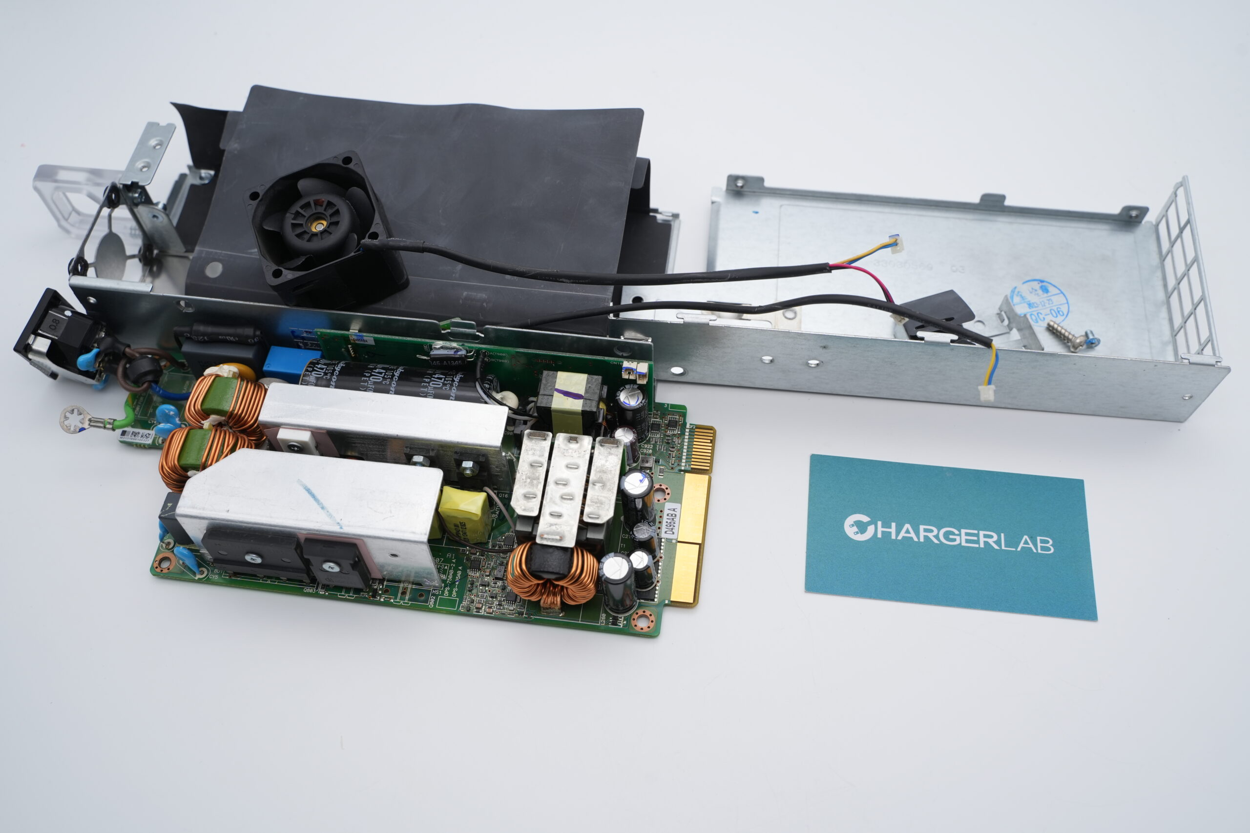

Next, we will take it apart.
Teardown of DELL 495W Platinum Server Power Supply (D495E-S0)-Chargerlab
Unscrew the fixing screws and remove the upper case. The PCBA module is insulated by black mylar sheets.
The PCBA module is fixed on the bottom case by screws.
The ground wire is also fixed with screws.
So is the indicator light PCB.
There is a tiny thermal pad paste on the mylar sheets to dissipate heat for a chip on the PCBA.
As mentioned, there is an AC socket and a fan on the input end.
And there are PCB gold fingers on the output end.
The vertical PCB is insulated by a small mylar sheet.
The wires of the fan and indicator light are connected to this vertical PCB.
The power supply wires of the fan are connected to the main PCB.
Disconnect the fan from the PCBA.
There are fuse, safety X2 capacitor, varistor, common mode choke, inductor, capacitor, and transformer.
The power measurement IC, primary master control chip, master control chip for auxiliary power supply, MOSFET, and sampling resistor are on the back.
