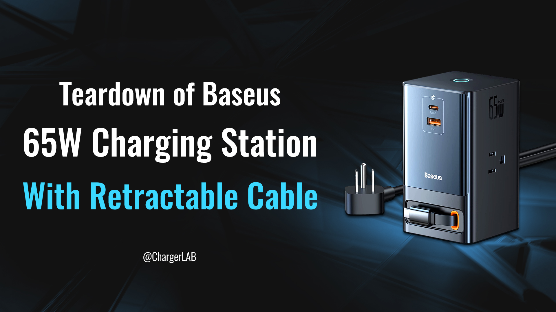

Today, we got another unique product from the PowerCombo series, which is slightly different from other products.
As we can see, it's more like a charging tower than a power strip. And there's a retractable USB-C cable and two USB ports on the front.
Model: CCGAN65-S3ACS
Time-delay Fuse: Better Electronics
NTC Thermistor: Shiheng Electronics
Safety X2 Capacitor: DGCX
Bridge Rectifier: World Industrial WRLSB80M
Electrolytic Capacitor: Yongming, CapXon
Master Control Chip (GaN IC): Southchip SC3057
SMD Y Capacitor: TRX TMY1102M
Optocoupler: EL1018
Synchronous Rectification Controller: Southchip SC3503
Synchronous Rectifier: Ruichips RUH1H80M
Solid Capacitor: CapXon
Protocol Chip: Southchip SC9711
Synchronous Buck MOSFET: Ruichips RUH4040M2
Output VBUS MOSFET: Ruichips RUH4040M2
Buck IC: Bright Power Semiconductor S7132S
MCU: BP0P104
Non-isolated Buck Converter: Lii semiconductor LN8K05A
AC Detection Chip: Hiliwi HLW8032
Relay: Hongfa HF7520
