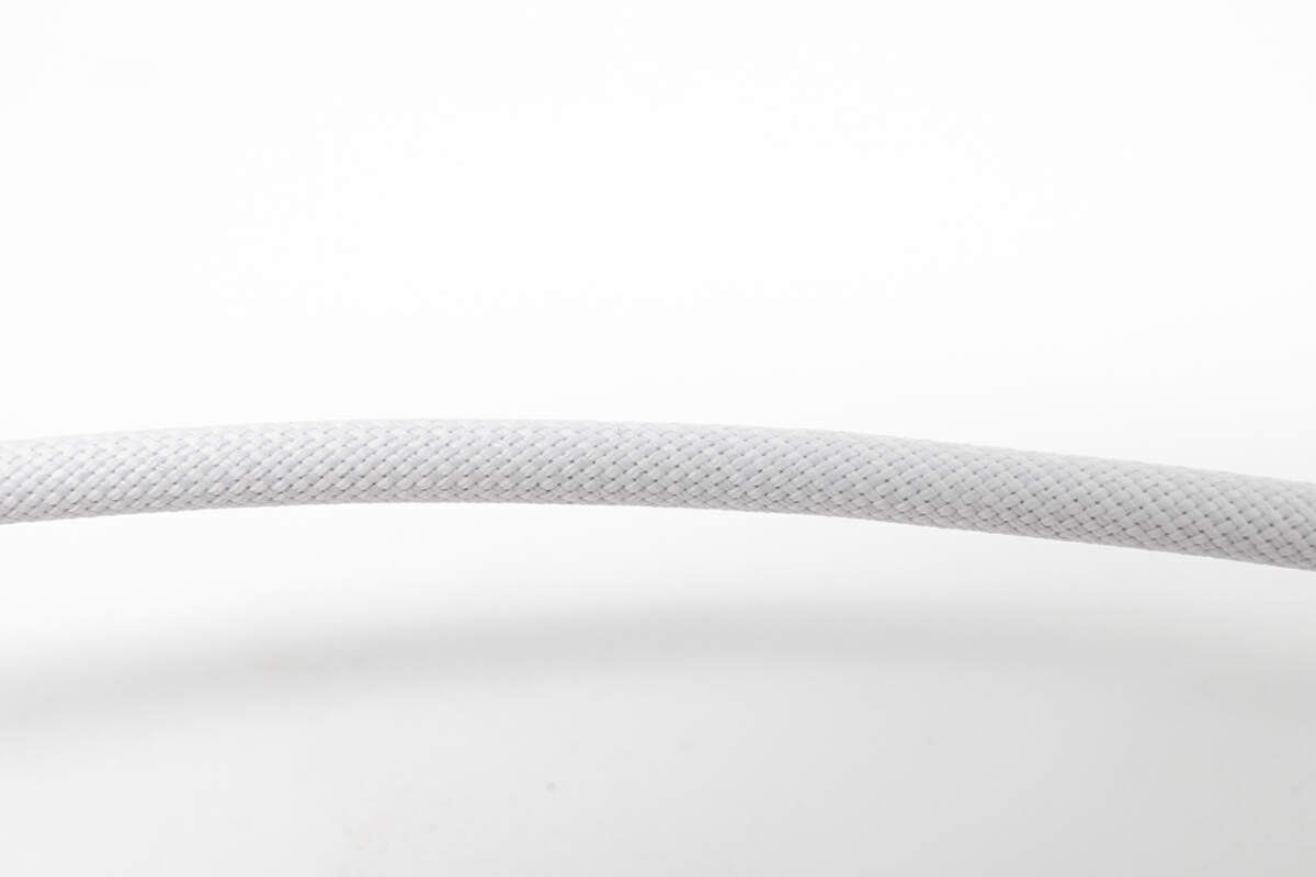

The cable is made with a woven design.
![Teardown of Apple Vision Pro Battery-Chargerlab](https://www.chargerlab.com/wp-content/uploads/2024/07/2024071101511570.jpeg)
The diameter of the cable is about 3.7 mm (0.15 inches).

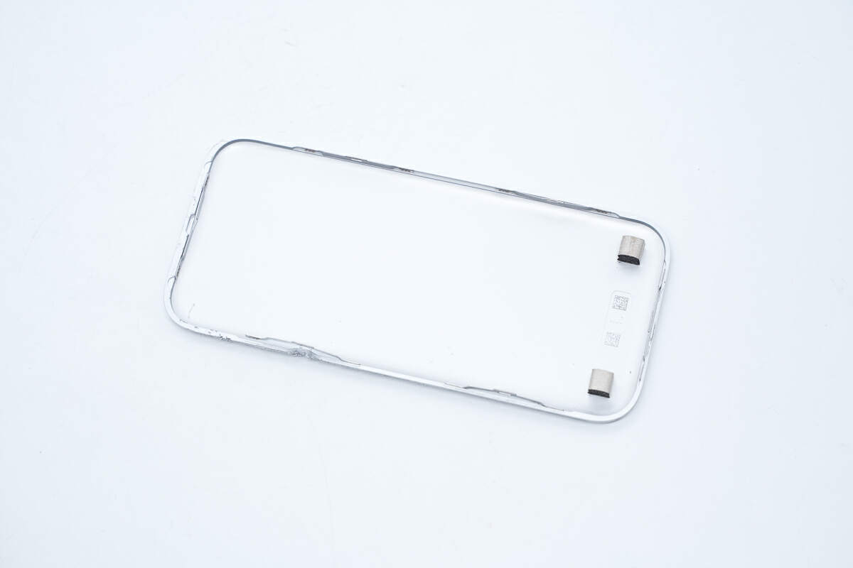

First, pry open the case along the gap. The cover is fixed with tape.
![Teardown of Apple Vision Pro Battery-Chargerlab](https://www.chargerlab.com/wp-content/uploads/2024/07/2024071101511388.jpeg)
Two pieces of conductive cloth are pasted on the inside of the cover at positions corresponding to the internal metal plate for grounding.

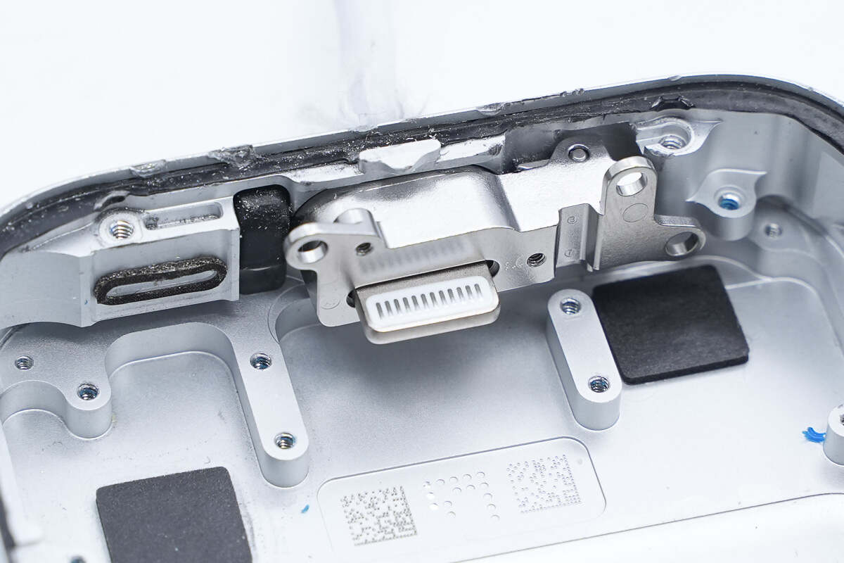

Unscrew the screws and take out the connector and PCBA module.
![Teardown of Apple Vision Pro Battery-Chargerlab](https://www.chargerlab.com/wp-content/uploads/2024/07/2024071101513018-1.jpeg)
There is a widened Lightning plug which has 12 pins.
![Teardown of Apple Vision Pro Battery-Chargerlab](https://www.chargerlab.com/wp-content/uploads/2024/07/2024071101511926.jpeg)
The USB-C socket is sealed with a rubber ring.

This is the pressure plate that secures the USB-C socket and the output cable socket.
![Teardown of Apple Vision Pro Battery-Chargerlab](https://www.chargerlab.com/wp-content/uploads/2024/07/2024071101512880.jpeg)
This is the bracket that holds the connector in place.
![Teardown of Apple Vision Pro Battery-Chargerlab](https://www.chargerlab.com/wp-content/uploads/2024/07/2024071101512372.jpeg)
The USB-C socket is connected via a cable, and the socket has silver contacts.
![Teardown of Apple Vision Pro Battery-Chargerlab](https://www.chargerlab.com/wp-content/uploads/2024/07/2024071101511963.jpeg)
The widened Lightning socket is reinforced with a metal case.
![Teardown of Apple Vision Pro Battery-Chargerlab](https://www.chargerlab.com/wp-content/uploads/2024/07/2024071101512910.jpeg)
There is an Apple logo on the cable.
![Teardown of Apple Vision Pro Battery-Chargerlab](https://www.chargerlab.com/wp-content/uploads/2024/07/2024071101512872.jpeg)
The widened Lightning socket has contacts inside.

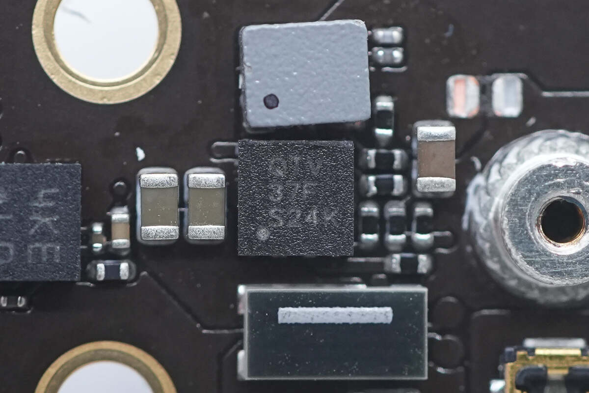

The front of the PCBA module has two synchronous buck converters, a protocol chip, memory, and an MCU.
![Teardown of Apple Vision Pro Battery-Chargerlab](https://www.chargerlab.com/wp-content/uploads/2024/07/2024071101512874.jpeg)
The USB PD controller is from TI. Model is CD3217B13.
![Teardown of Apple Vision Pro Battery-Chargerlab](https://www.chargerlab.com/wp-content/uploads/2024/07/2024071101511882.jpeg)
The synchronous buck converter on the left is from TI and adopts DSBGA24 package. It supports an operating voltage range of 4-15V and a continuous output current of 6A. Model is TPS62180.
![Teardown of Apple Vision Pro Battery-Chargerlab](https://www.chargerlab.com/wp-content/uploads/2024/07/2024071101511893.jpeg)
This is the buck inductor used with it.
![Teardown of Apple Vision Pro Battery-Chargerlab](https://www.chargerlab.com/wp-content/uploads/2024/07/2024071101513021.jpeg)

![Teardown of Apple Vision Pro Battery-Chargerlab](https://www.chargerlab.com/wp-content/uploads/2024/07/2024071101512222.jpeg)
This is the connector of the widened Lightning socket.

![Teardown of Apple Vision Pro Battery-Chargerlab](https://www.chargerlab.com/wp-content/uploads/2024/07/2024071101512742.jpeg)
The synchronous buck converter marked with QTV is from TI and adopts 2*2WSON package. It has an input voltage range of 3-17V and an output current of 1A. It has short circuit protection and overheat protection functions. Model is TPS62160.
