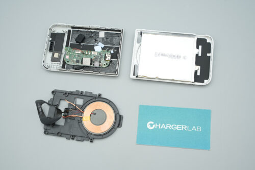

You can even use it to connect to the Ethernet. So that's what we gonna tear down today.
PFC Boost Controller: NXP TEA19162
MOSFET for PFC Boost: Infineon 60C185C7
Diode: STMicroelectronics SMA6F5.0A
Electrolytic capacitor: Rubycon
Primary Controller: NXP TEA19161T
Half-bridge MOSFET: Infineon 60C185C7
Secondary Synchronous Rectification Controller: NXP TEA2095
LLC Synchronous Rectifier: ON Semiconductor NTMFS5C628L
Solid Capacitor: Panasonic SEPF Series
Protocol Chip: Infineon CYPDC1185B2
Output Protection IC: Nexperia PSMN1R0-30YLD
