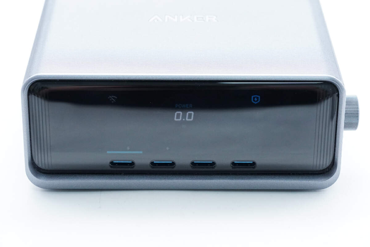

There are 4 USB-C ports and a TFT color screen on the front.

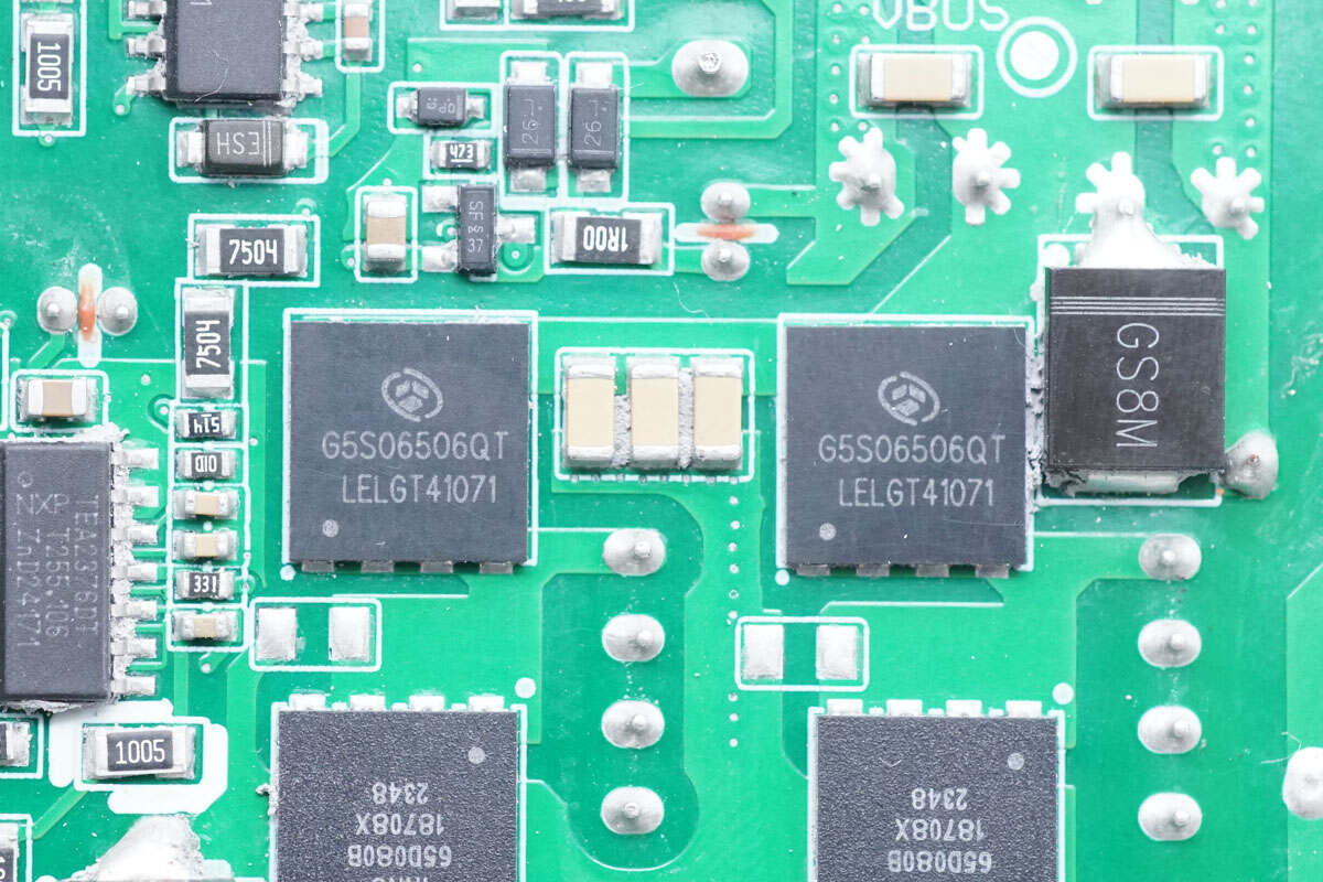

These two PFC rectifiers are from GlobalPower and adopt DFN8*8 package. This is a silicon carbide diode with a withstand voltage of 650V, an operating current of 6A at 136℃, and a maximum operating temperature of 150℃. Model is G5S06506QT.

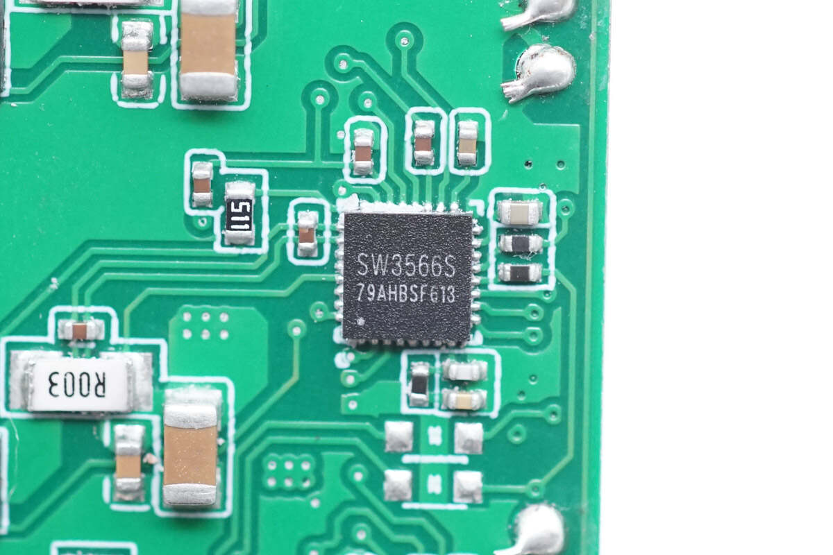

The buck controller of USB-A1 and USB-A2 is from iSmartWare. This is a dual-port SoC with an integrated 7A Buck controller, supporting 140W (28V@5A) power output and supporting multiple fast charging protocols such as PD3.1. Model is SW3566S.
It has a built-in ARM Cortex-M0 core, integrated Type-C interface logic, PD3.1 PHY, UFCS PHY, SCP/AFC PHY, TFCP PHY, and QC/PE/SFCP and other fast charging protocol detection circuits. Only a small number of peripheral devices are needed to form a complete high-performance dual-port fast charging solution.
It integrates CC/CV mode, dual-port management logic, and bus voltage detection and can achieve dual-port buck output with the corresponding buck switch tube and VBUS MOSFET. The chip's built-in buck converter has operating frequencies of 125KH, 180KH, 333KH, and 500KH and supports PWM and PFM working modes. Output current, line loss compensation, and other protection thresholds can be set through the MCU. The built-in ADC can realize data sampling of 9 channels, such as input and output voltage, output current, chip temperature, etc., and supports external MCU for parameter display.
It supports 36V input voltage, maximum output current 7A, built-in soft start, input overvoltage/under voltage protection, output overvoltage/under voltage protection, output overcurrent/short circuit protection, DP/DM/CC overvoltage protection, chip overtemperature protection, external NTC thermistor protection, as well as power limit protection. It adopts QFN4*4-32 package.

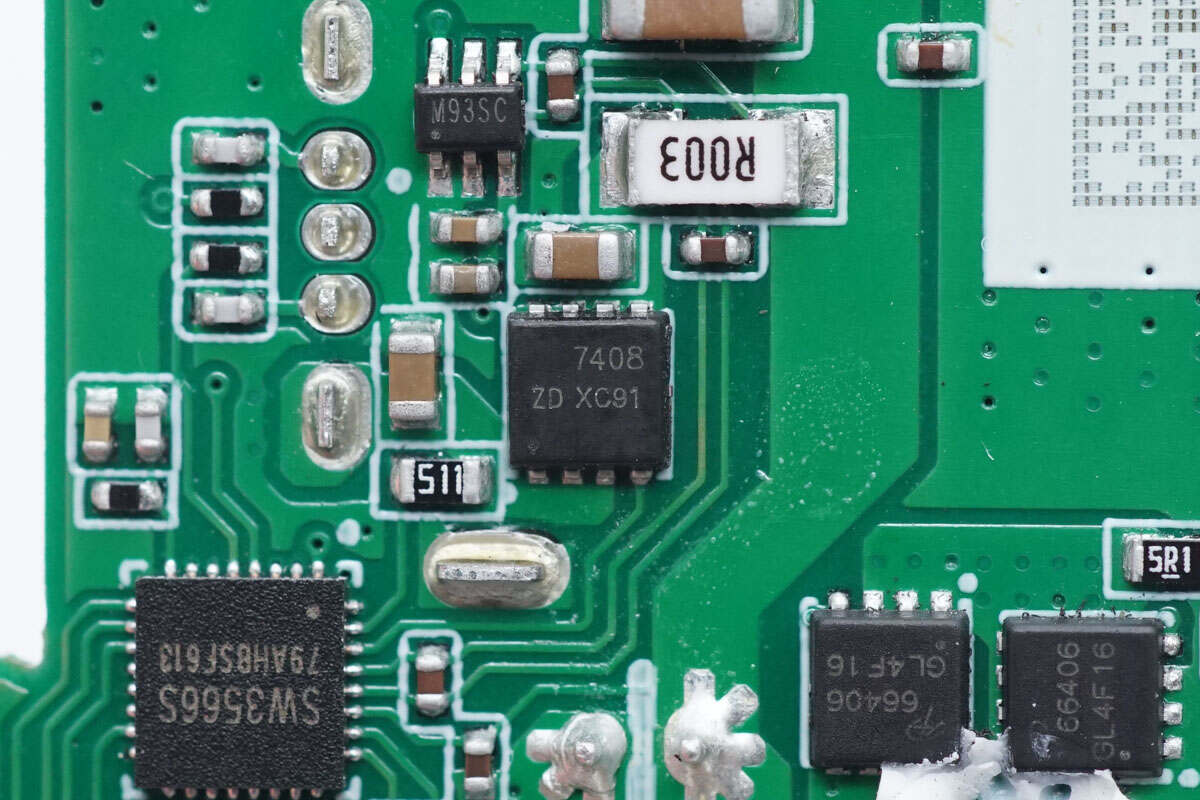

The USB-A1 port output VBUS MOSFET is marked with 7408.
