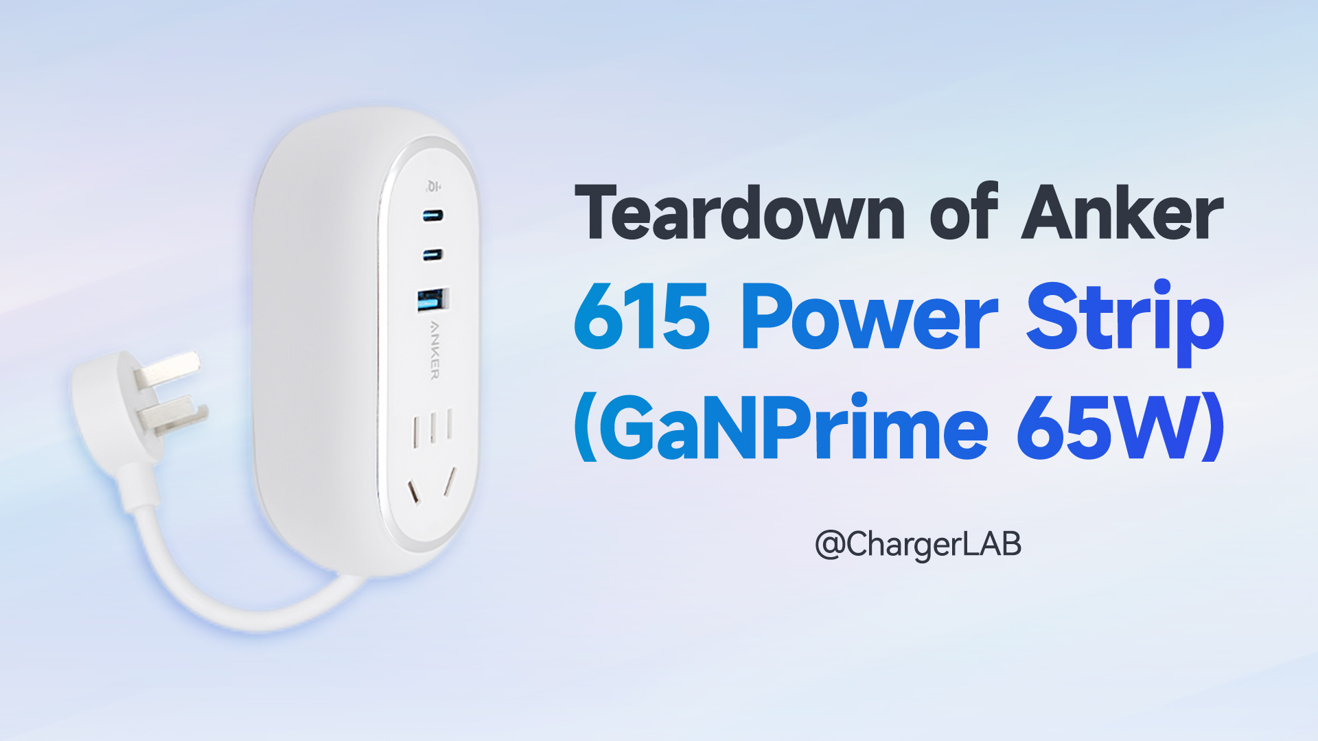

If you have been subscribing to our channel for a long time, you will notice that we have made several videos for the Anker GaNPrime series.
And today, we got a 65W GaN power strip, also from GaNPrime series. The mini design and impressive way to store the power cord can improve desktop utilization. So let's go ahead and check its internal structure.
