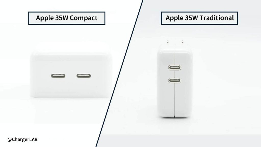

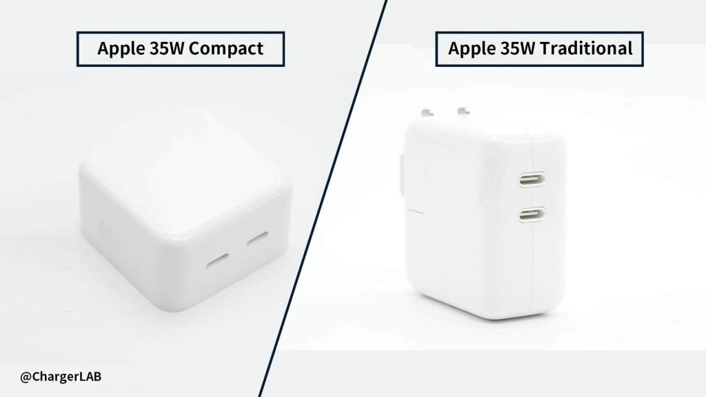

The left charger adopts a new compact design, with a glossy white shell and flat grey bottom, which can fit well into the wall outlet or flat cable socket.
The right one is more traditional, with foldable prongs and a removable module.

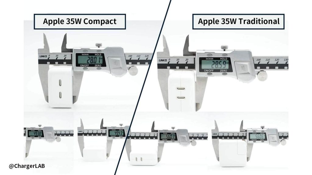

Size / Power Density
Teardown Comparison | Differences between Apple A2579 And A2676 35W Charger-Chargerlab
The size of the compact charger is 49 x 49 x 28mm (1.92 x 1.92 x 1.1 inches), and the power density is about 0.51W/cm³.
The size of the traditional charger is 56 x 56 x 28mm (2.2 x 2.2 x 1.1 inches), and the power density is about 0.39W/cm³. As we can see, it's a little bit larger than the compact version.

Both chargers are equipped with dual USB-C ports. But the arrangement is different, and there are circles of white plastic around the USB-C ports of the traditional one.

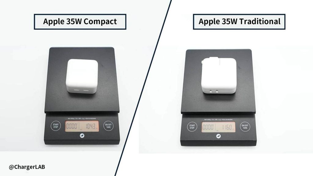

The weight of the compact charger is 104g (3.66oz), slightly lighter than the 116g (4.02oz) of the traditional one.

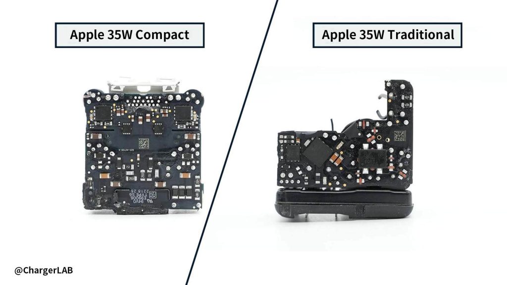

The compact charger has two independent switching power supply circuits corresponding to two independent transformers and output filter capacitors. And the input is powered by a connector to meet Apple's design for multi-country prongs.
The PCBA module of the traditional charger can be divided into an AC-DC circuit and a secondary step-down circuit. The ground wire is fixed with screws, and the transformer is directly soldered to the small buck board. And the small buck board is synchronously rectified and filtered to supply power to the step-down circuit. In addition, a separate plastic shell is used for insulation.
Back
Just like the front of the compact charger, the synchronous rectifier, VBUS switch MOSFET, and other components on the back are symmetrical.
The traditional charger has bridge rectifiers and a primary switch MOSFET on the back.

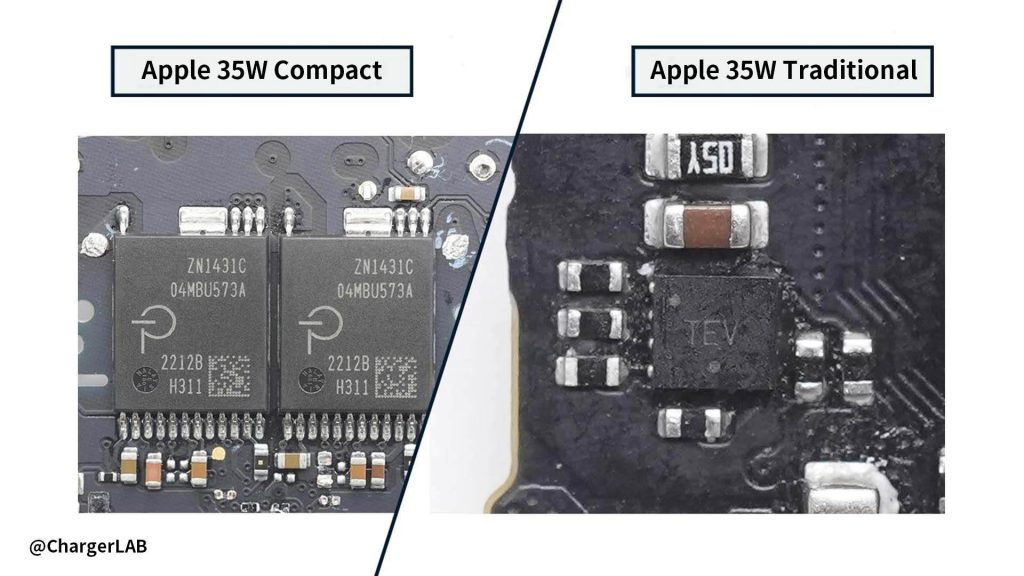

Primary Controller

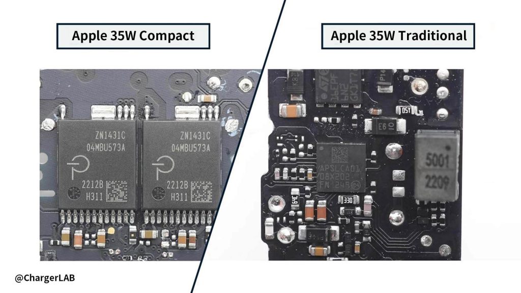

Two master control chips of the compact charger are marked with ZN1431C, the customized models for Apple from PI. They integrate the primary controller, switch transistor, and synchronous rectification controller.
And the master control chip of the traditional charger is Apple’s customized model, marked with APSLCA01, which is also used in Apple 96W and 30W chargers.
Synchronous Rectifier Controller
The synchronous rectifier controller of the compact is integrated into the PI master control chip, and the traditional's is marked with TEV.

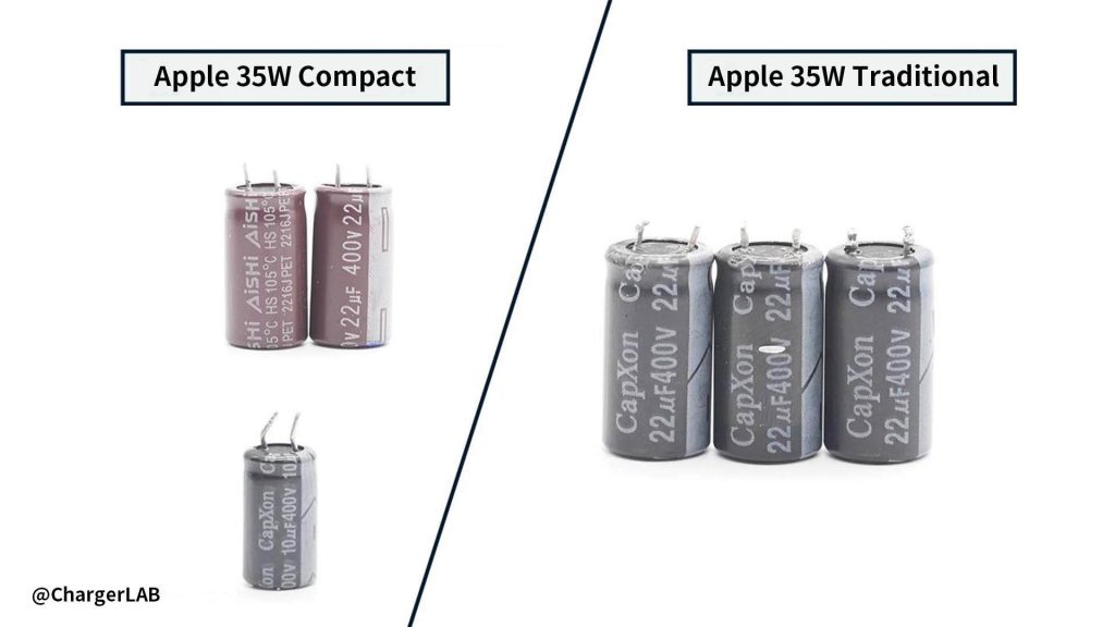

The compact charger has three primary electrolytic capacitors. Two are from AiSHi, 400V 22μF, and the third is from CapXon, 10μF 400V.
And three electrolytic capacitors of the traditional charger are from CapXon, 22μF 400V.

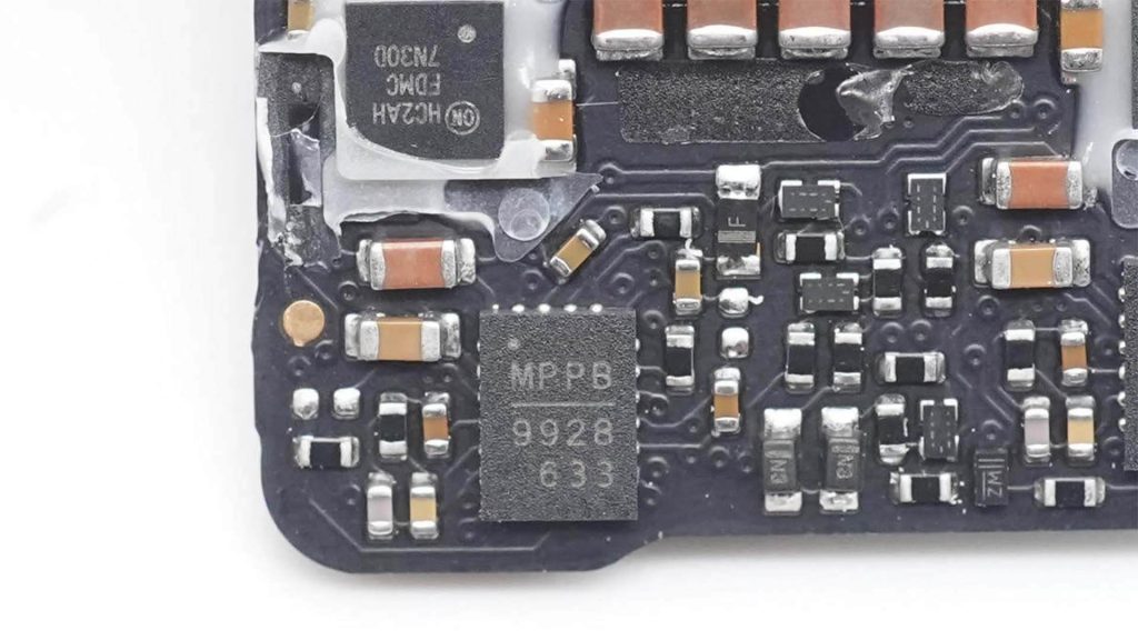

Compared to the compact charger, the traditional charger has two synchronous step-down circuits. So, it's equipped with the synchronous step-down controller from MPS MP9928 and used for step-down control of two USB-C ports, respectively. It integrates the half-bridge NMOS driver and supports the programmable operating frequency. It also has output overvoltage and overheat protection.

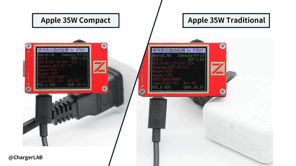

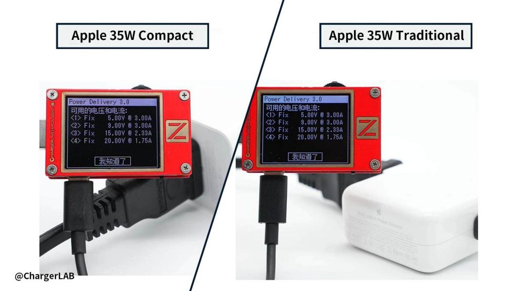

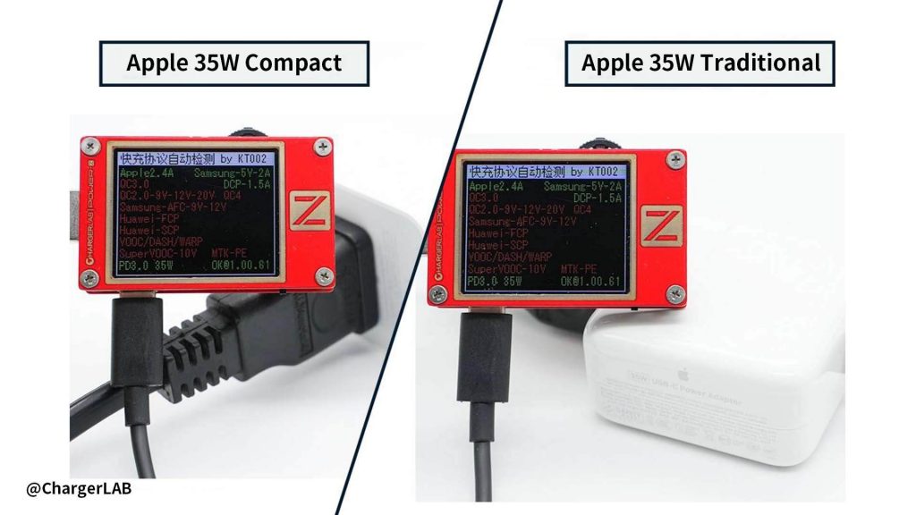

The ChargerLAB POWER-Z KT002 shows both USB-C ports of the two chargers support the same protocols of Apple 2.4A, Samsung 5V2A, DCP and PD3.0.
PDO
Both USB-C ports of the two chargers support the same four fixed PDOs of 5V3A / 9V3A / 15V2.33A / 20V1.75A. Either USB-C1/C2 can support up to 35W output with an intelligent distribution.

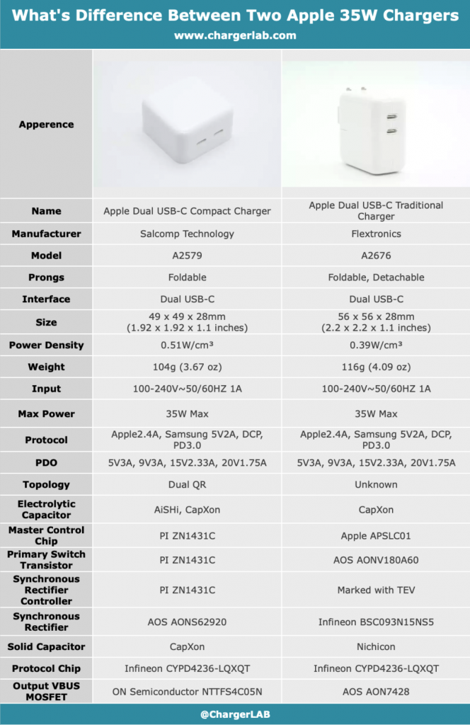

We made a chart for you to compare the differences between those two chargers.
They have many similarities and also many differences. We can only see the difference in appearance from the outside because they have the same power, same USB-C ports, and even the same performance. But if we dig a little deeper, we'll see they're completely different.
The compact charger adopts two switching power supply circuits, while the PCBA module of the traditional charger can be divided into an AC-DC circuit and a secondary step-down circuit.
Since they're the same price, it's up to you to choose the most suitable one.
