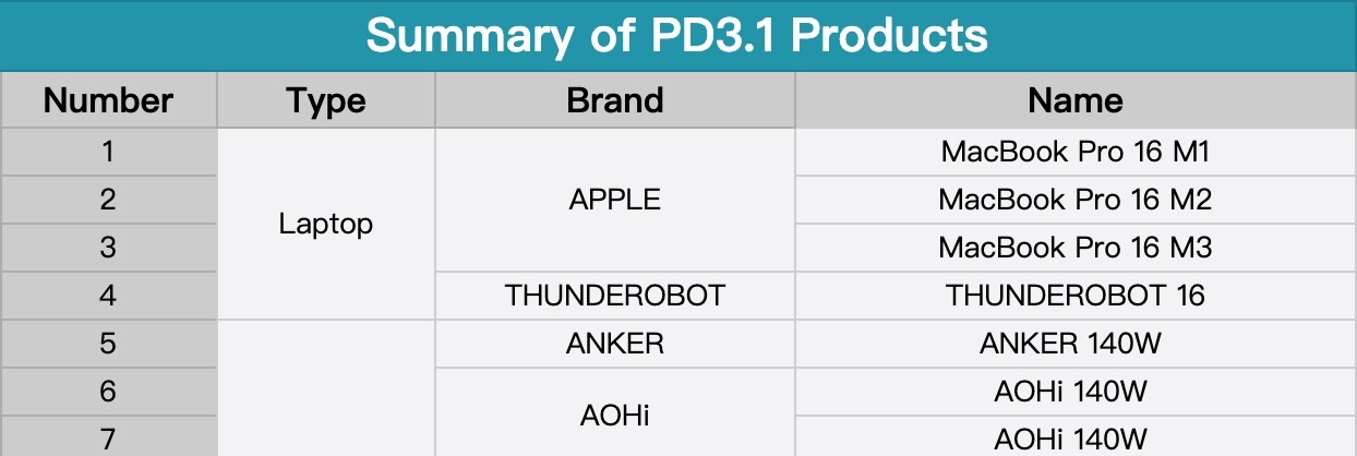

PD3.1 is the protocol specification released by USB-IF in June 2021. The PD3.1 protocol extends the voltage range to 28V, 36V, and 48V, increasing the output power from 100W to 48V/5A 240W, breaking limits for high-speed charging. With this power, not only gaming laptops but also TVs, electric bicycles, and IoT devices can use PD fast charging. ChargerLAB has recently compiled a list of laptops, chargers, power banks, and power strips that support PD3.1.
PD3.1 Products Summary Table
As of May 29, 2024, ChargerLAB has compiled 26 PD3.1 products.
Summary of PD3.1 Products: Laptops, Chargers, Power banks, and Power strips-Chargerlab
Among the products, chargers account for 54%, with 14 models; power banks account for 19%, with 5 models; laptops account for 15%, with 4 models; and power strips account for 12%, with 3 models.
