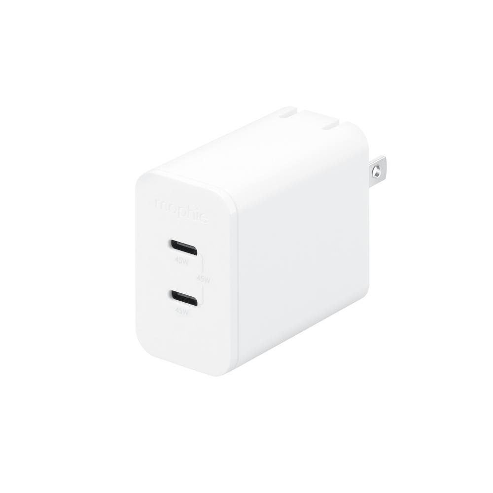

Recently, mophie, a strategic partner of Apple for many years released a 45W dual USB-C port charger, which has passed Apple's certification. It adopts the GaN technology to make it compact and portable with a maximum output power of 45W.
Small but powerful丨mophie launched a speedport 45 2-port GaN wall charger (45W)-Chargerlab
It adopts a white and frosted fire-resistant shell and a smooth and glossy output panel with a rounded edge.

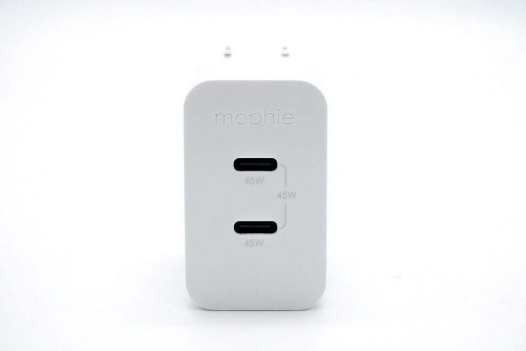

It has two USB-C ports, and either USB-C1/C2 can support up to 45W output separately.

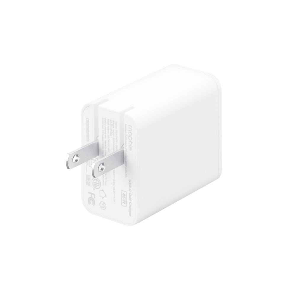

It adopts the foldable prongs so that you can tuck it into your backpack—or even your pocket—for a fast shot of power anywhere you plug in.

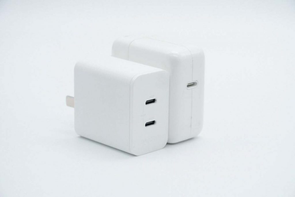

Its size is about 49.36 X 45.99 X 28.04 mm (1.94 X 1.81 X 1.10 inches), with the volume of 63.65cm³ (3.88 in³) and power density of about 0.71W/cm³. And the weight is about 78.3g (2.76oz).
It's smaller than the Apple 30W single-port charger and has two ports to support simultaneous charging of two devices.

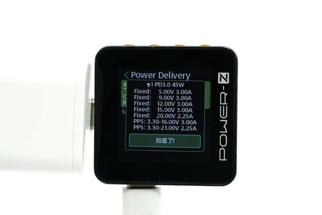

The ChargerLAB POWER-Z KM002C finds that either USB-C1/C2 can support up to 45W output separately.
And the two ports support five fixed PDOs of 5V3A / 9V3A / 12V3A / 15V3A / 20V2.25A and two PPS of 3.3-16V3A / 3.3-21V2.25A.

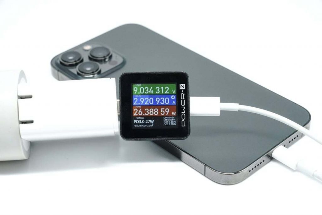

When charging the iPhone 13 Pro Max, it triggers a handshake of 9V PDO with a power of 9.03V 2.92A 26.38W, reaching maximum output power of the phone.

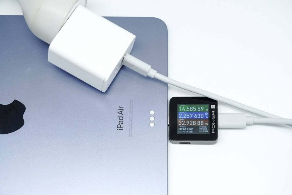

When charging the iPad Air 5, it triggers a handshake of 15V PDO with a power of 14.58V 2.25A 32.92W, reaching maximum output power.

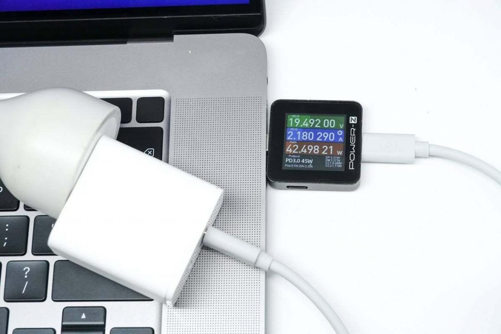

When charging the MacBook Pro 16, it triggers a handshake of 20V PDO with a power of 19.49V 2.18A 42.49W, reaching maximum output power of the charger.

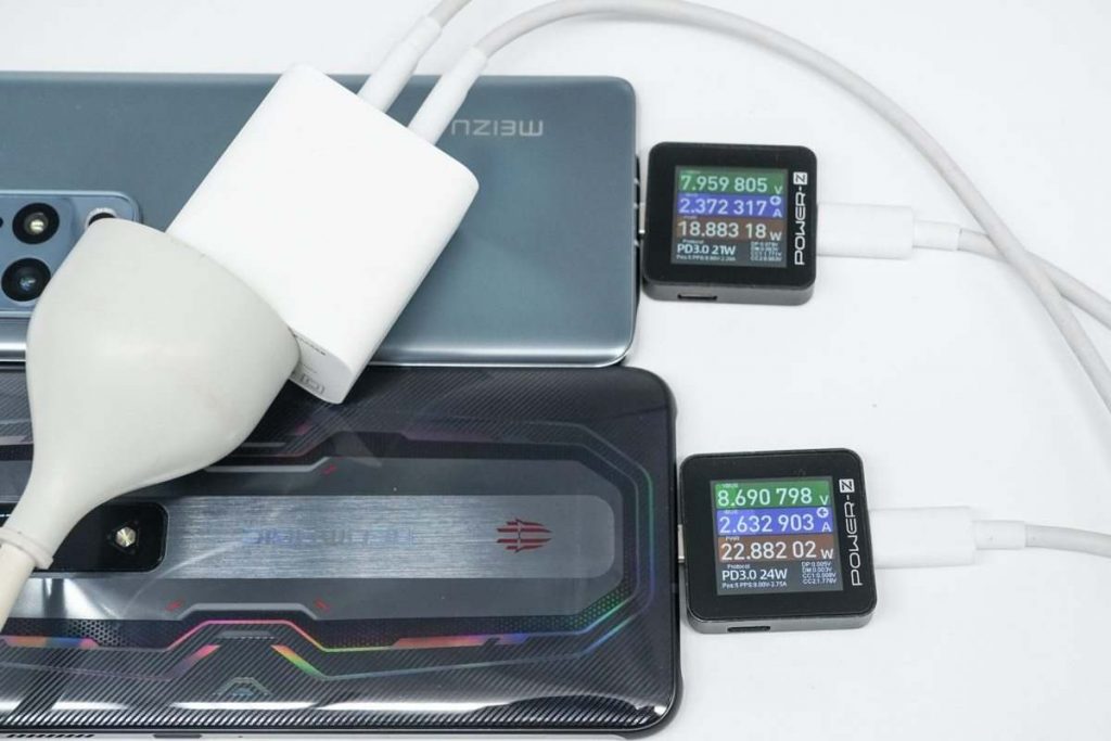

When charging two devices simultaneously, both phones can trigger USB PD, with the power of 7.95V 2.37A 18.88W and 8.69V 2.63A 22.88W, respectively.
The mophie speedport 45 2-port GaN wall charger (45W) has a smaller size than the Apple 30W charger, and its power is higher.
It has two USB-C ports, and either USB-C1/C2 can support up to 45W output separately. And the two ports support five fixed PDOs of 5V3A / 9V3A / 12V3A / 15V3A / 20V2.25A and two PPS of 3.3-16V3A / 3.3-21V2.25A.
