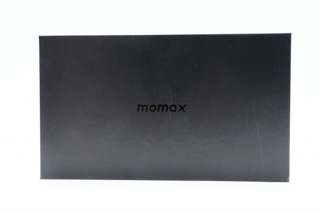

The charging station is packaged in a pure white box. The front of the package is printed with the appearance and the display scenario of the compatible devices; the upper left corner is the product name of MOMAX Airbox; the lower left corner is the mark of supporting Apple Watch Series 1-5; the lower right corner are the Apple MFW certification and Qi wireless charging certification.

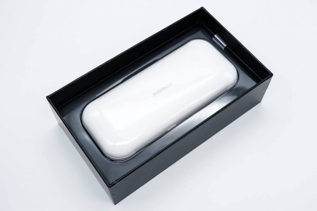

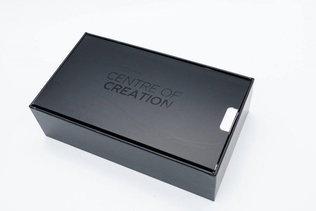

There is a black lid and base box inside the package with the logo of MOMAX on its front.
Review of MOMAX Airbox Charging Station(A Foldable Power Bank)-Chargerlab

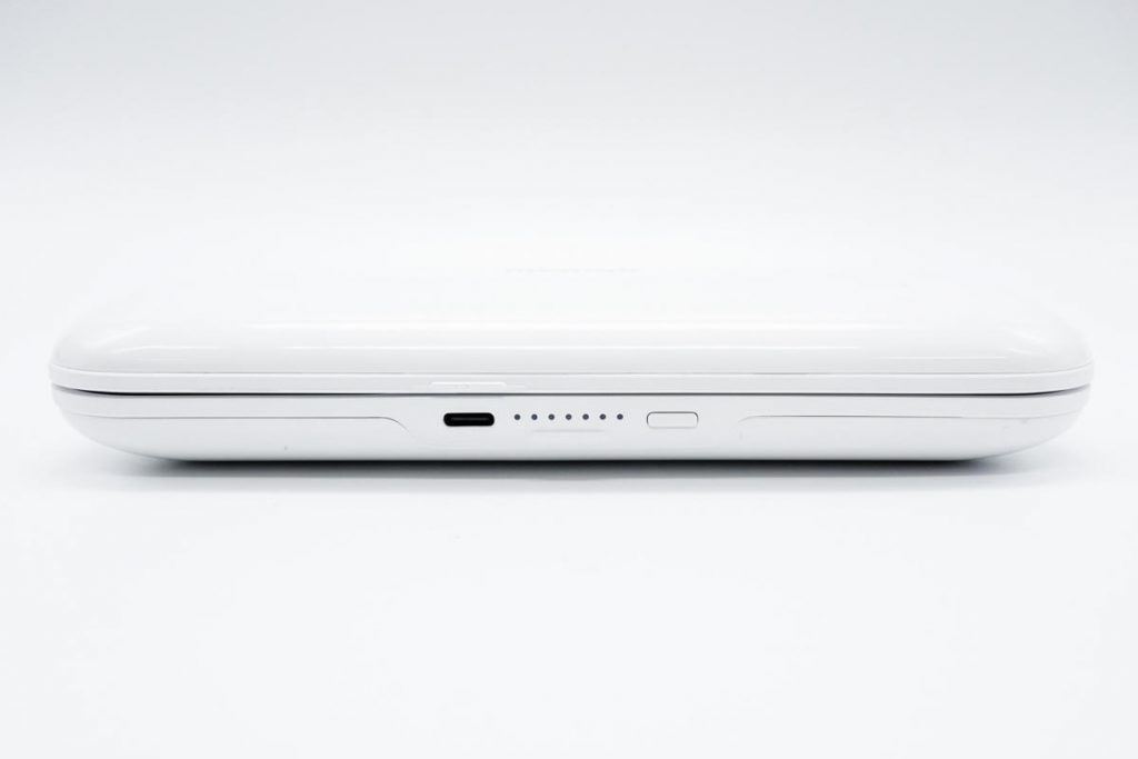

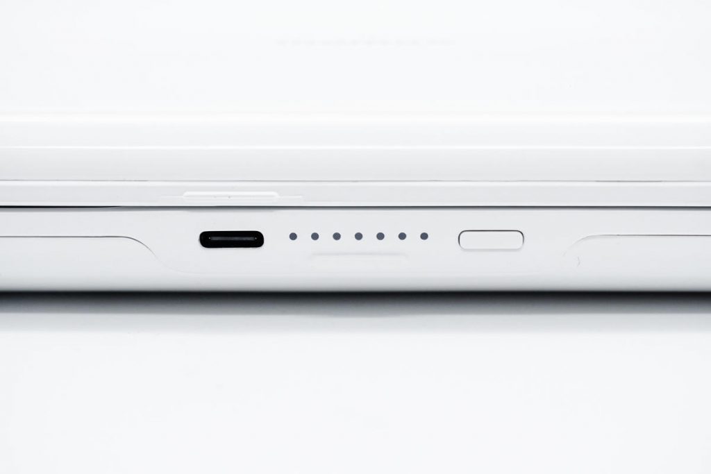

There are a charging port, power switch and LED indicator in the lower part.
The USB-C port can output and be input with a black USB-C receptacle. There are seven LED indicators in the middle. The first green indicator keeps on; the second is the wireless charging orange indicator; the third is the AirPods orange indicator, and the remaining four are white power indicators. On the right side is the power switch button, and a long press will make it close.

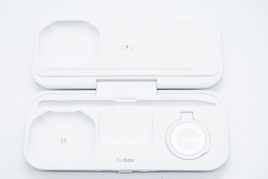

Unfold the Airbox charging station.
The lower left corner is the wireless charging area for AirPods, which can be placed entirely without the case and stored in the station. Above the area is the Apple Pencil storage slot.
The lower right corner is the wireless charging area for the Watch.

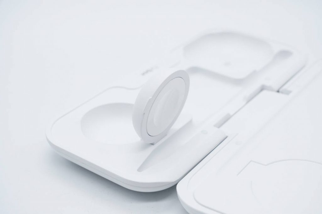

The Watch charging bracket can stand upright and be folded at an angle of up to 90°.
The upper is the wireless charging area with a wireless charging icon, and the left and right sides are recessed for more convenient storage.

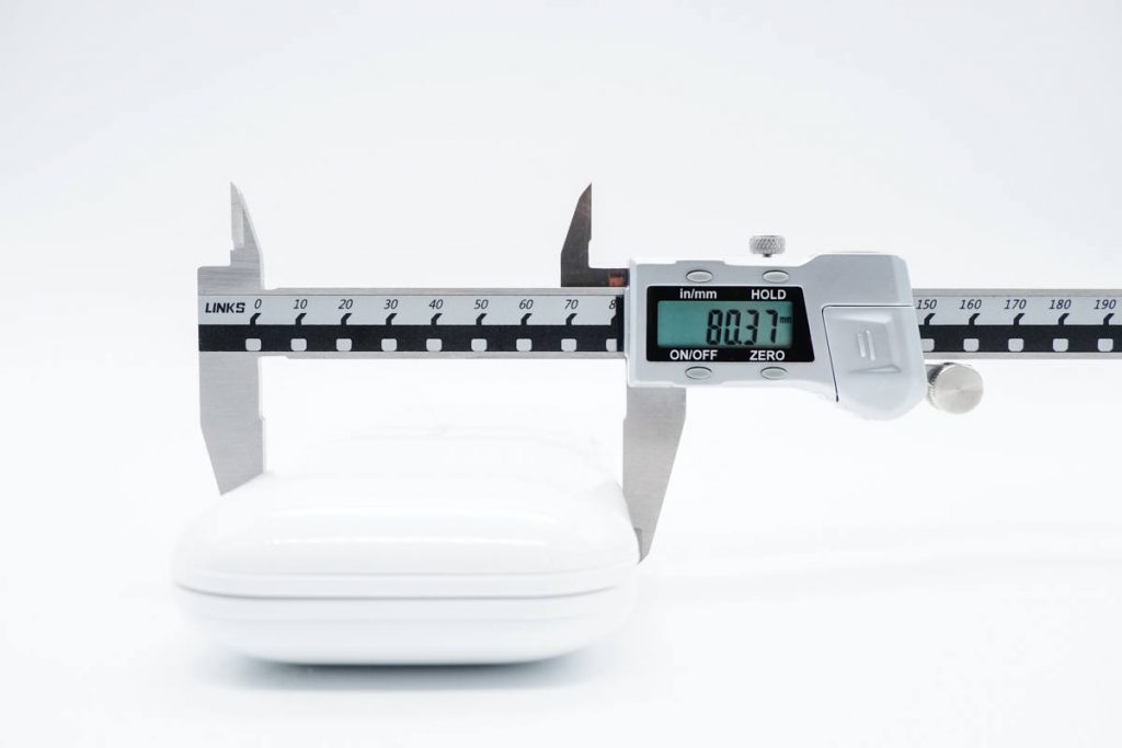

Its size is about 184.3 X 80.37 X 32.67 mm (7.25 X 3.16 X 1.28 inches).

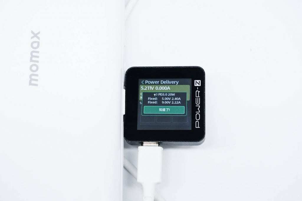

The ChargerLAB POWER-Z KM002C finds that the USB-C port supports AFC, QC3.0 and PD3.0 charging protocols.
It supports two fixed PDOs of 5V2.4A and 9V2.22A.

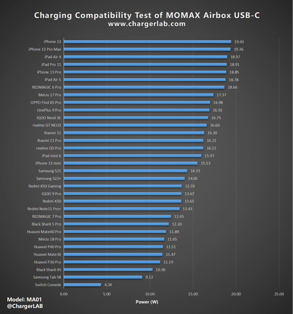

Here comes the charging compatibility test of MOMAX Airbox. The Apple devices can be charged at the maximum power level.
ChargerLAB's histogram shows the charging power of each product directly. The Apple devices have the highest power.

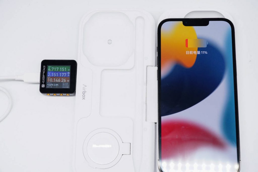

Let's test whether the MOMAX Airbox supports simultaneous charging and discharging.
The test shows that it can be charged through the USB-C port while charging an iPhone wirelessly, working normally. It supports simultaneous charging and discharging.

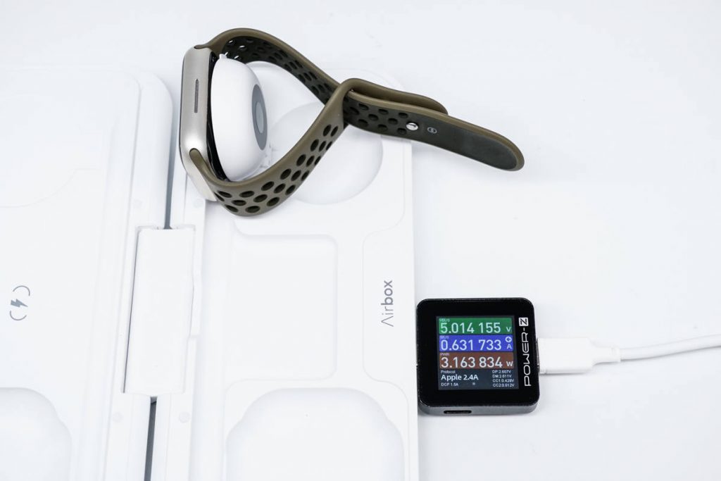

Remove the phone and place the Apple Watch on the station, and it is tested to charge normally.

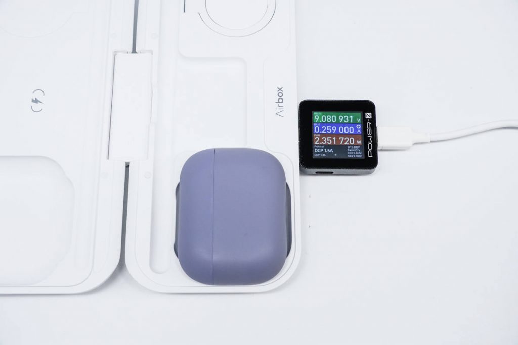

The AirPods Pro can also be charged in the wireless charging area.

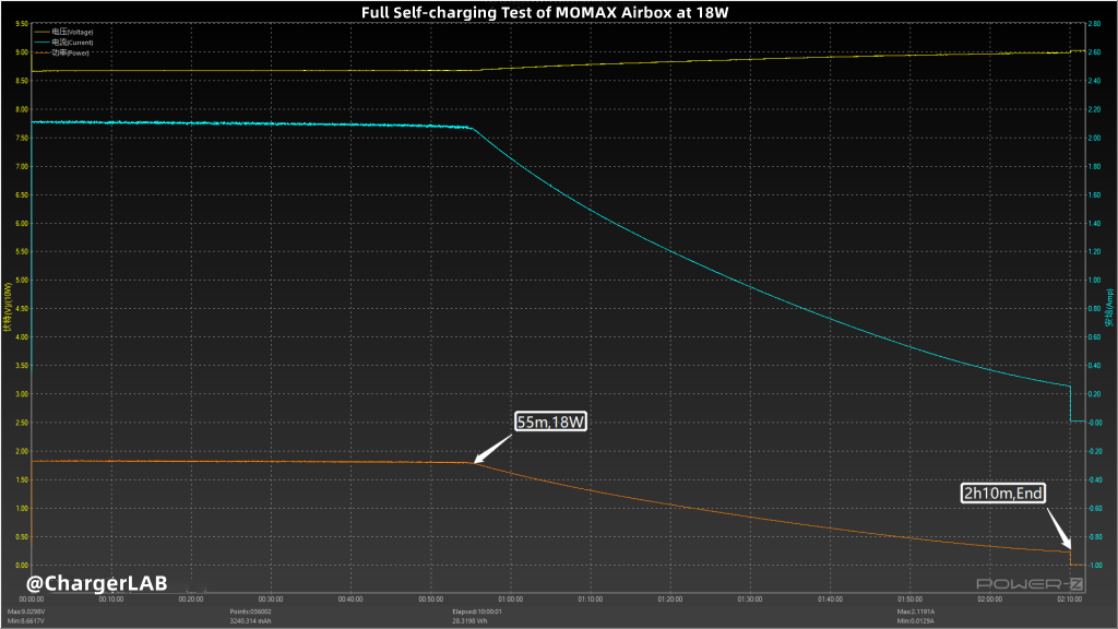

Since the Airbox can be used as a power bank, we had a full self-charging test, using the Apple 20W charger to charge it.
The input power was about 18W before 55 minutes. The charging ended at 2 hours and 10 minutes with a maximum power of 8.66V 2.11A 18.31W.

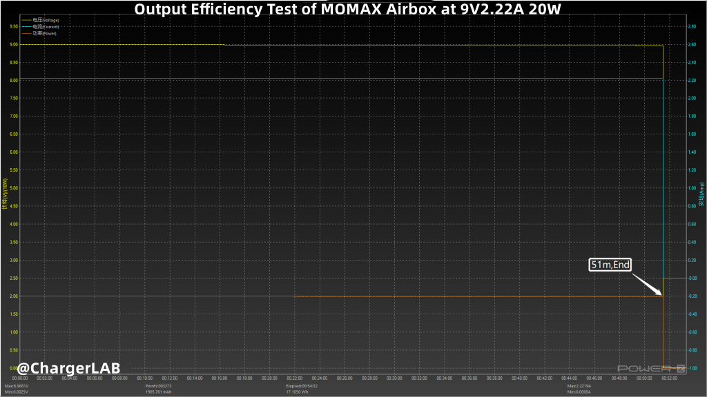

Then, make the power bank output at 9V2.22A 20W and end at 51 minutes. The actual battery energy discharged is about 17.105Wh, so the efficiency at 9V2.22A 20W power output is about 17.105/38=45.01%.
The output efficiency test is to make the Airbox be in a limit state. The output power will not continue at a 15W and 20W output and will inevitably decrease with the increase of phone power. So the above output efficiency is for reference only. The output efficiency in daily use will be higher than in the test.

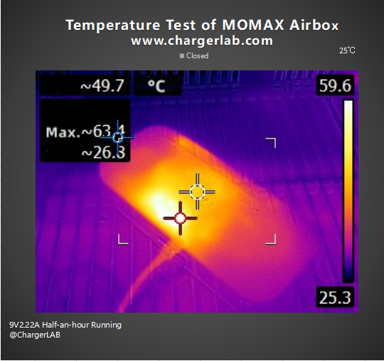

We'll put it into a 25°C thermotank throughout the test and let it run for half an hour with the power of 9V2.22A 20W.
When closed, the maximum temperature of the power bank's surface was 63.4℃ (146.12℉) after half an hour.

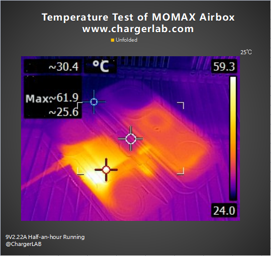

When unfolded, the maximum temperature of the power bank's surface was 61.9℃ (143.42℉) after half an hour.
