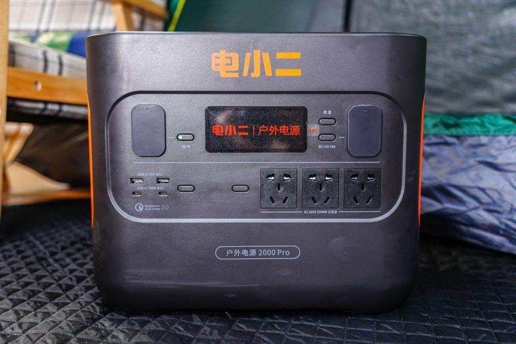

Jackery 2200W Portable Power Station 2000 Pro continues the colors of black and orange. With the 94V-0 flame retardant and multiple protection mechanisms, it's pretty safe in an accidental outside collision.
All the ports are in full view of the front. Let's have a further look.

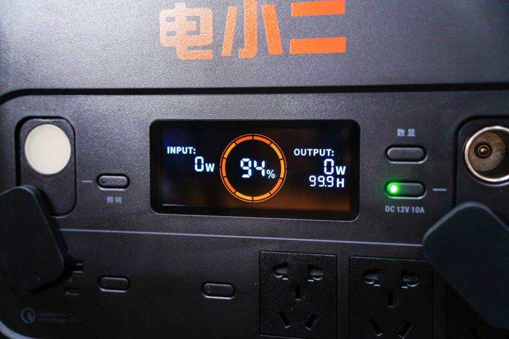

In the center is the display, which shows the real-time input and output power, remaining battery and battery time remaining.
The new battery management system of the chip can effectively ensure the safety of use and real-time monitoring outside.

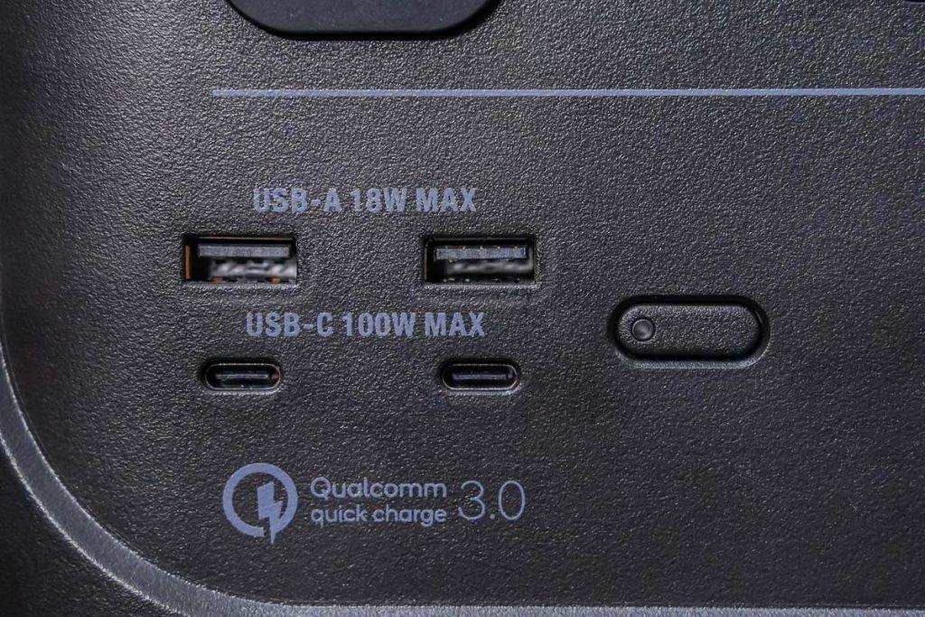

The two USB-A ports support up to 18W output. And the two USB-C ports below support up to 100W PD output, which can directly charge digital devices such as phones, laptops and cameras. The independent switch is on the right and the label shows it supports QC 3.0 fast charging protocol.

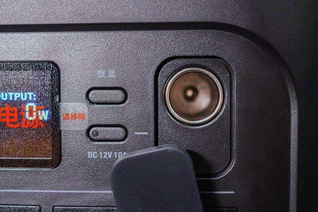

The right side of the display is the protected car charger port, supporting up to 120W. And these independent switches make it safer to use.

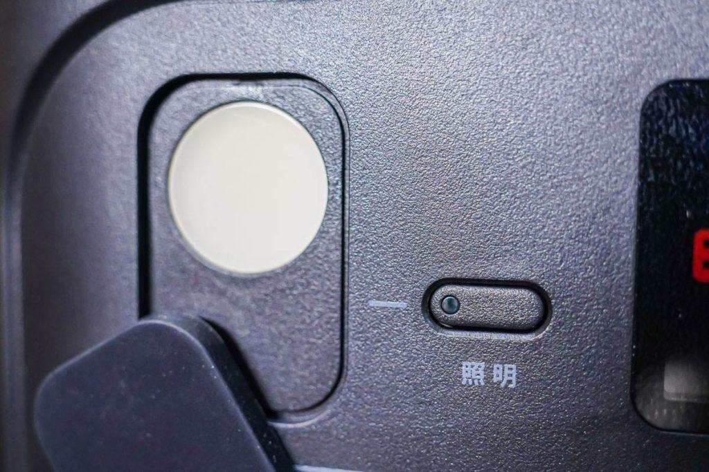

The protected LED lighting is on the left of the display,  with an independent switch that can adjust for brightness. In an accident, it can be set to continuously flashing to facilitate search and rescue.

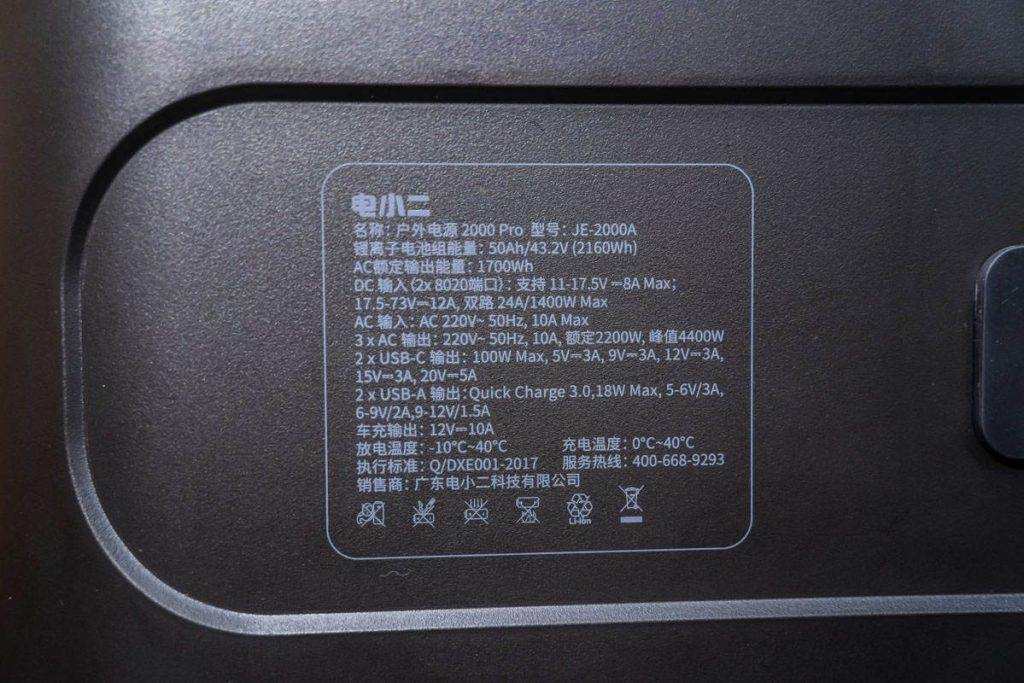

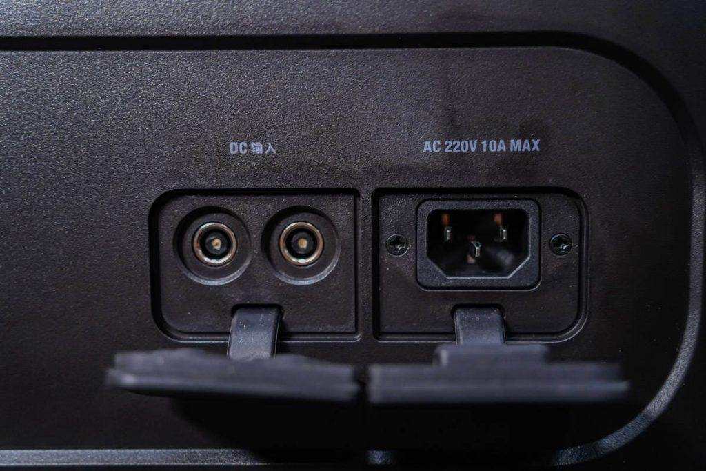

Specifications are printed on the left side of the back, and the right side is equipped with a DC input port and an AC input port.
Review of Jackery 2200W Portable Power Station 2000 Pro (2160Wh Solar Generator)-Chargerlab
The 2000 Pro has a battery capacity of 2160Wh, 50Ah 43.2V. Four temperature probes can monitor the real-time maximum temperature of the battery core and will automatically cut off power when the temperature is above the safety line.

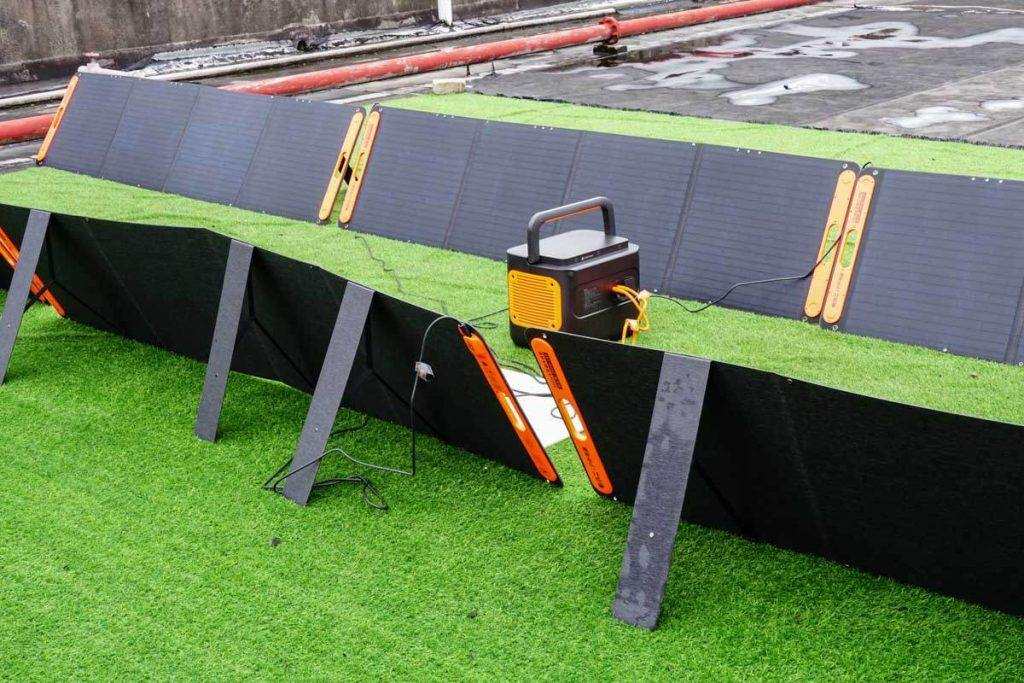

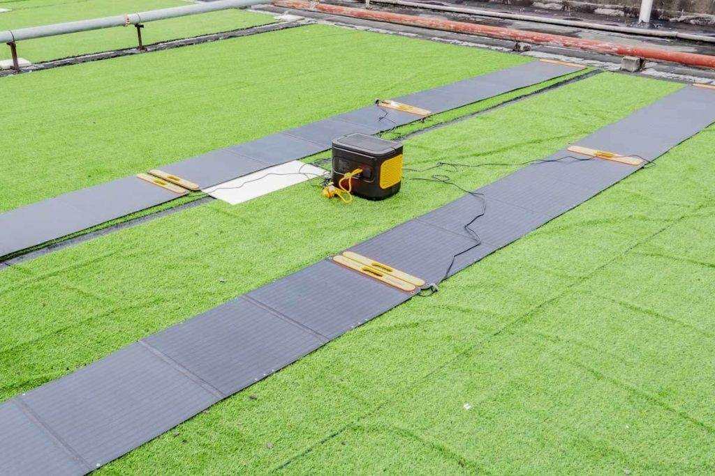

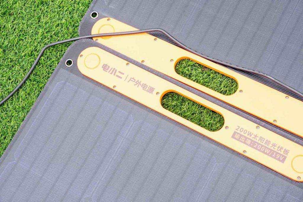

With the included adapter, six 200W solar panels can be used to power the 2000 Pro at the same time.
The back of the solar panel comes with its folding bracket, which can face the sun at the best angle outdoor to maximize the efficiency of solar charging.

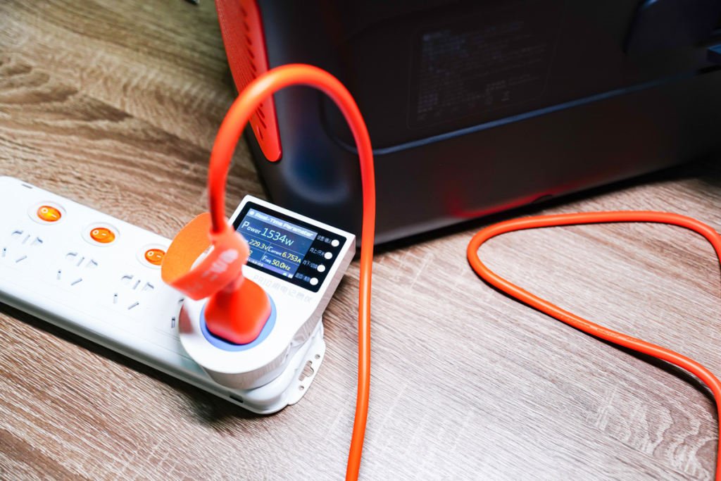

It supports multiple self-charging methods. Using the included cable to directly connect to the outlet with the AC port on the 2000 Pro, the tested charging power can reach 1500W +. The 2000 Pro also supports car charging input and comes with a cable for in-car charging in the package.

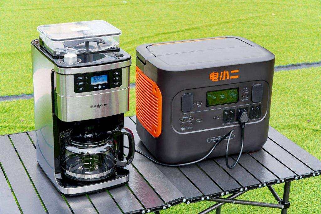

Even the outdoors, the 2000 Pro will be able to charge the coffee machine, as you can see that the power reaches 940W, which can fully meet the normal working conditions.

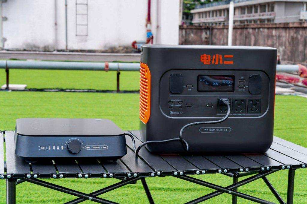

It also supports the induction cooktop.

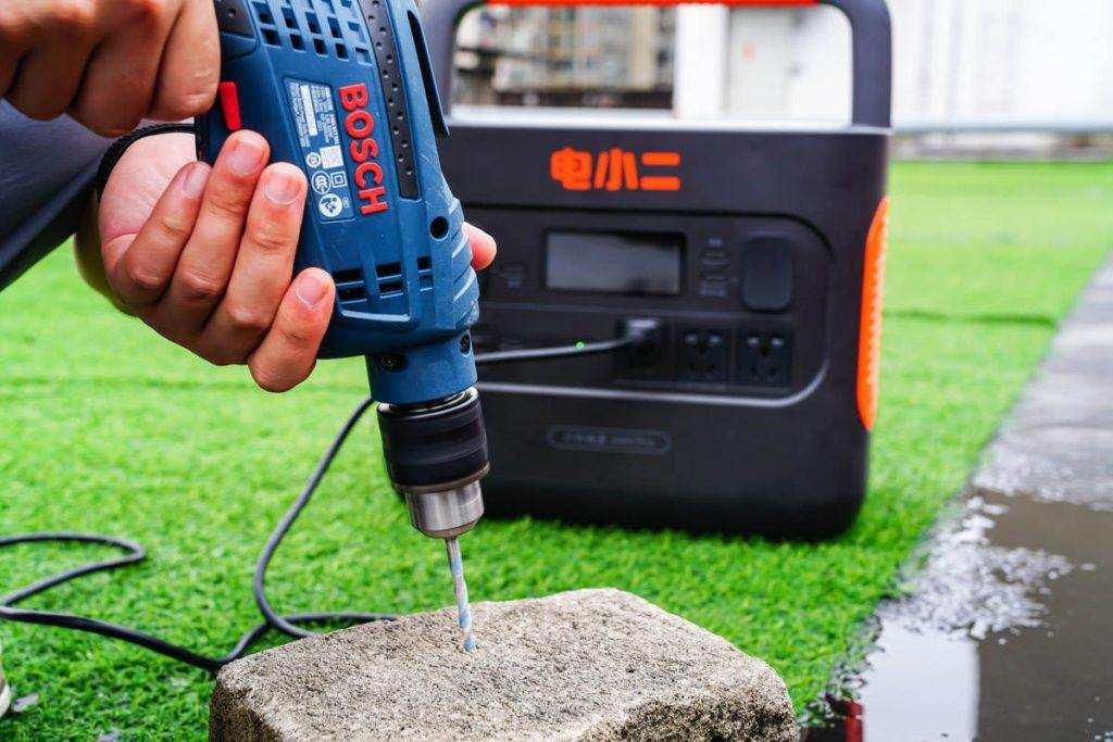

Electrical tools are also applicable.

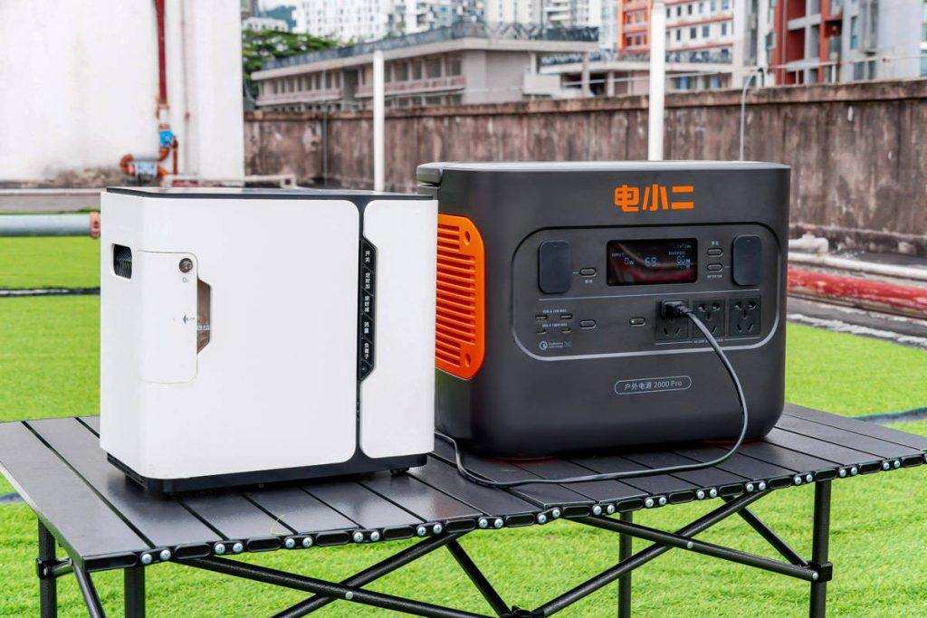

Even an oxygenerator can work.

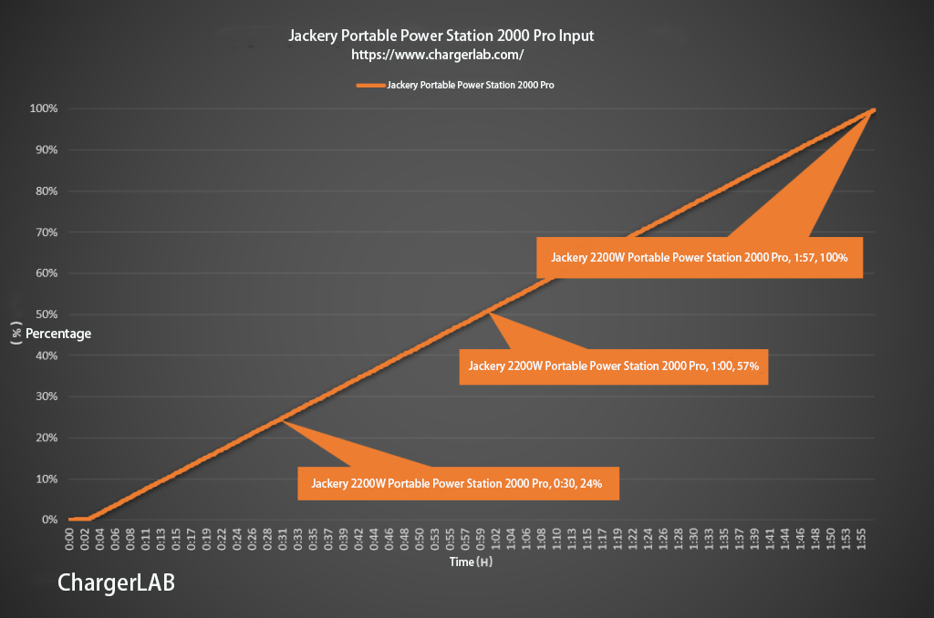

Here is the self-charging time-testing data of 2000 Pro.
This chart shows that it can reach 24% in half an hour, 51% in 1 hour and 100% in just 1 hour and 57 minutes. This charging speed is one of the fastest in the whole field, making it a good choice for travel.

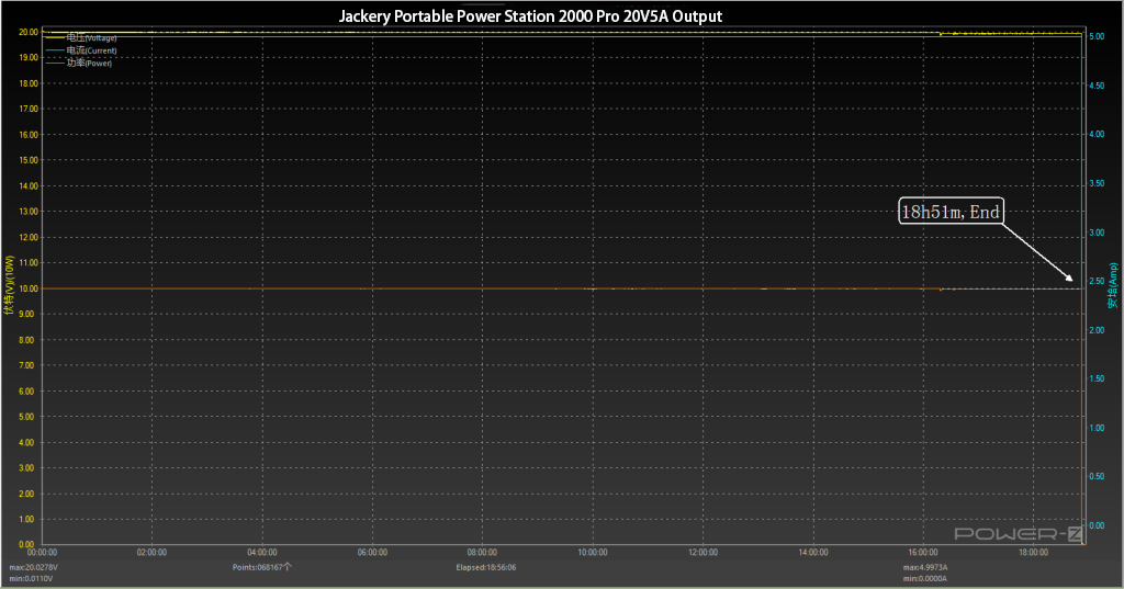

The 2000 Pro has a battery capacity of 2160Wh and supports a rated output power of 2200W. The output power is often different in the face of other power-using devices and cannot be quantified. So we chose to test through the USB-C.
Using USB-C, it ended in 18 hours and 51minutes. And the output energy was about 1881.7139Wh. When charging your laptop, the power will decrease as the laptop battery power increases. So the actual time is certainly much longer than 19 hours.
