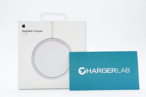

In September, the iPhone 16 series was released, along with the new MagSafe that can support 25W. The appearance has not changed much; it is thinner and lighter, and the cable has been replaced with a woven cable. Next, let's take a look at its charging performance.
Review of Apple 25W MagSafe Charger-Chargerlab
It comes in a white box with the Apple logo and product appearance.
