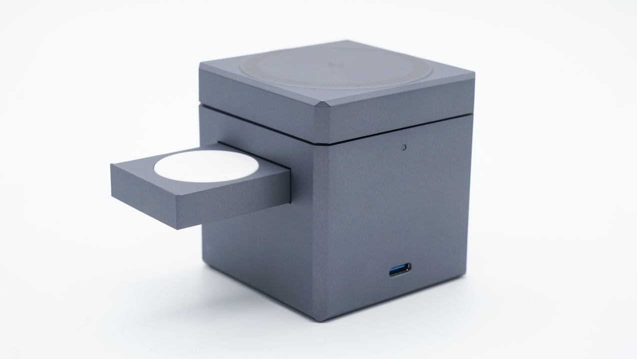

The wireless charging panel for your Apple Watch is hidden on the side and supports fast charging for compatible models.
Review of Anker 3-in-1 MagSafe Charging Cube (Y1811)-Chargerlab
Just press the button slightly and it'll pop out, just like a SIM card slot.
You can adjust its angle up or down to get the best viewing experience, and the adjustment range can be up to 60 degrees.

The LED indicator and input USB-C port are on the back. After connecting to the power supply, it'll light up in white, but it‘s always on only when the AirPods is charging.
