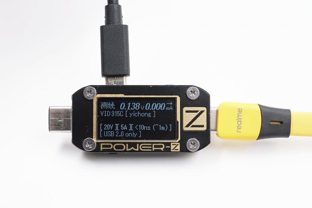

Use POWER-Z KM001C to read the cable information; we can find it supports 20V 5A 100W charging power, USB 2.0 only.
