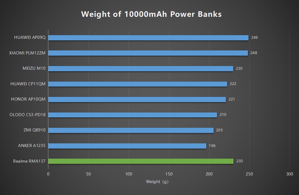

It weighs 230.2g/8.1oz.
It is relatively heavy in the 10000mah-range power banks.
