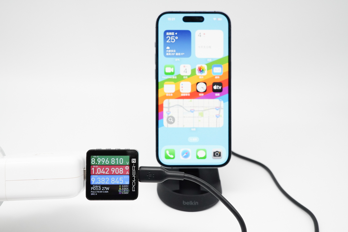

Without upgrading the system to iOS 17, the charger output power is only 9.00V 1.04A 9.38W, and the phone does not support Qi2 15W wireless charging at this time.
