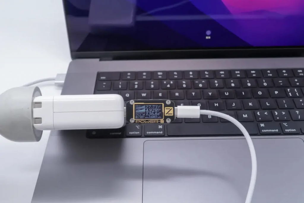

ChargerLAB has tested this charger before. It can only work with MagSafe 3 cable to provide 140W fast charging for the MacBook Pro. And the MagSafe 3 cable brings us back to the classic MagSafe era of the MacBook.

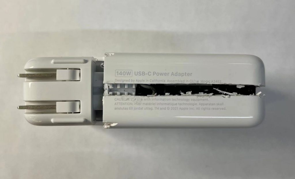

Except for charging, ChargerLAB has been trying to figure out the evolution of this charger’s components all the time. So, we got another new 140W charger in 2022 and took it apart again. And we did find some updates. The model remains A2452, but the GaN IC inside the charger has been changed from GaNsystem to Navitas.

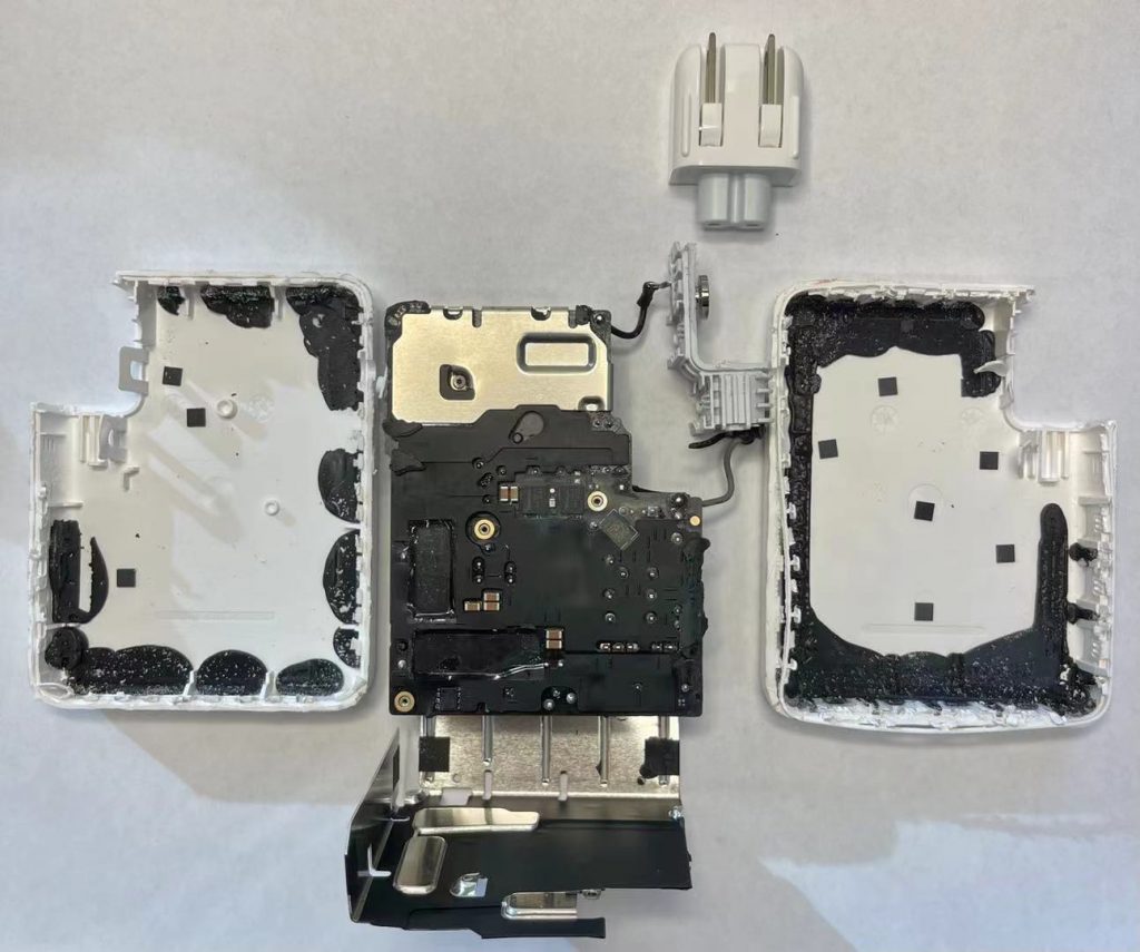

After taking it apart by cutting machine, we can see the internal components haven’t changed significantly, compared with the previous charger. The circuit topology and component positions are very similar.

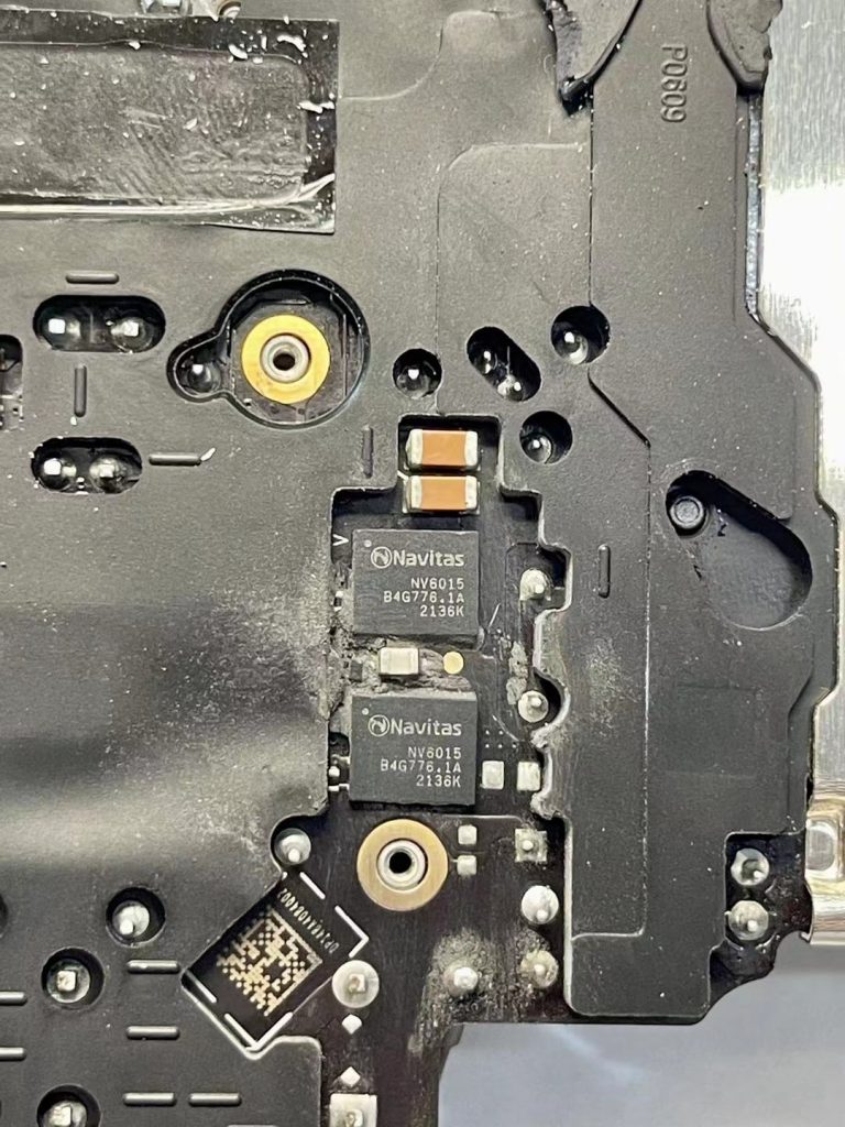

We can clearly observe two GaN power ICs in the LLC topology from Navitas and adopt the SMD package. The Model is NV6015. It’s different from all previous models on the market. So, we guess it should be the customized model from Navitas for Apple.
We will publish more in-depth and detailed analysis of this quick product and technology update.
