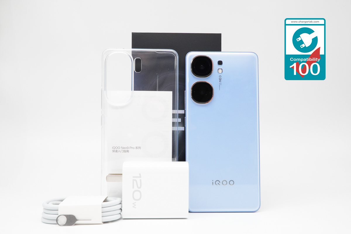

Not long ago, iQOO unveiled the iQOO Neo9 Pro, featuring the flagship Dimensity 9300 chip, which, judging by the performance of vivo's smartphones with Dimensity chips, is expected to deliver top-notch gaming experiences. Of course, we got our hands on this product at the earliest opportunity.
Afterward, we created a ChargerLAB Compatibility 100 video for it. Through the video, we aimed to offer viewers a full understanding of its capabilities. Now, we're presenting this information in written form to provide a more detailed insight into its charging compatibility.

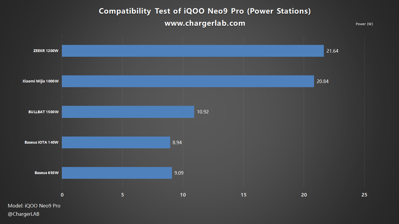

Plotting the charging power data into a bar graph, it can be observed that the charging power for the iQOO Neo9 Pro remains between 8-22W.
