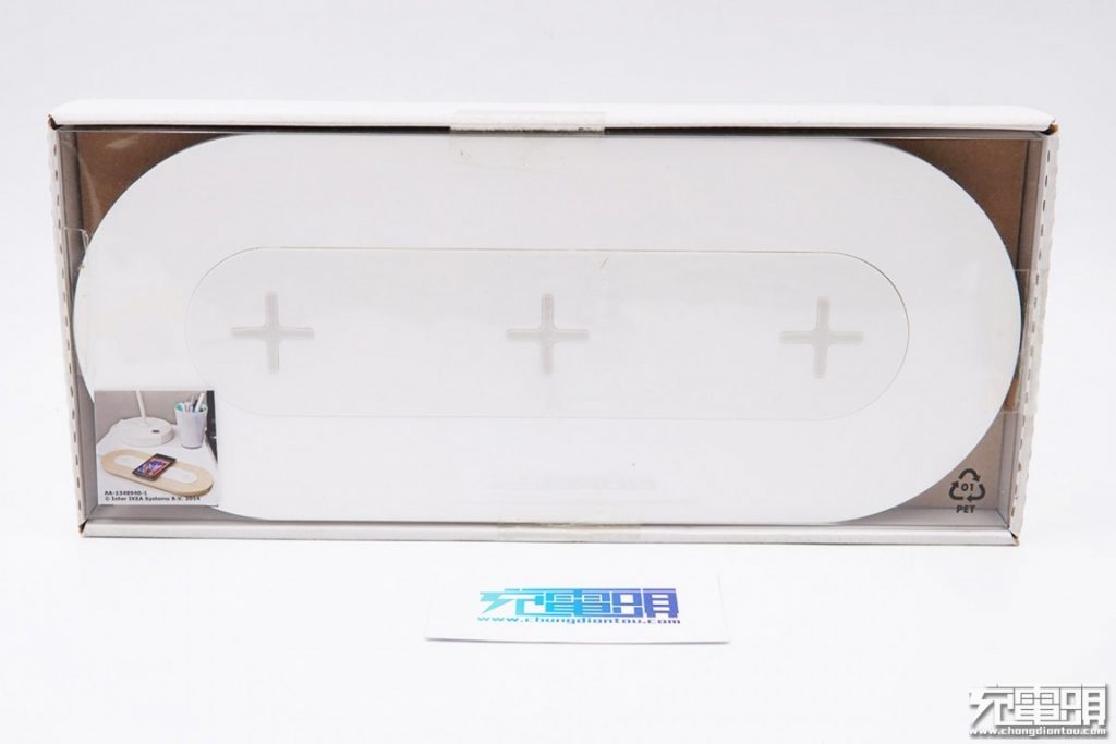

It comes with IKEA's minimalistic cardboard box with clear lid.

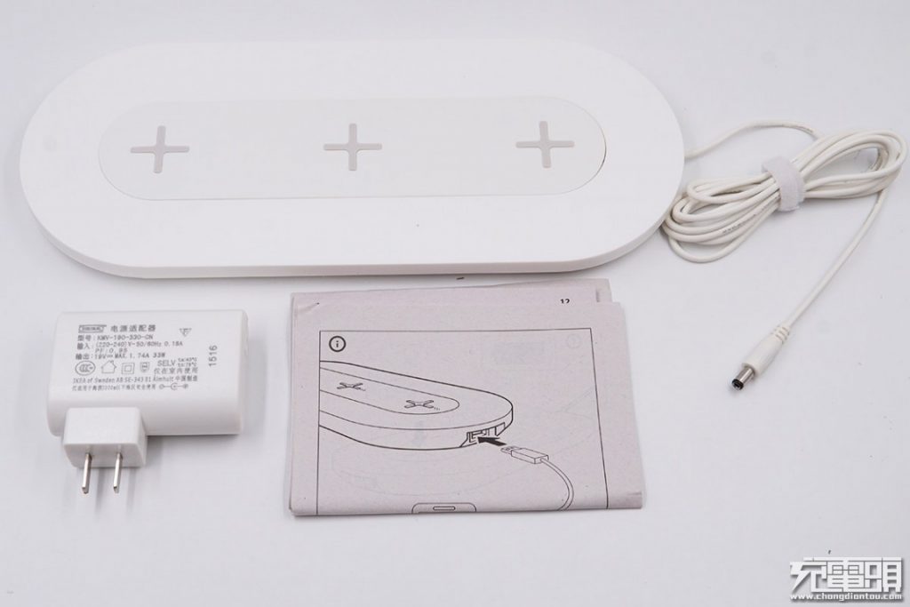

Package contents: wireless charging pad, power adapter, user manual, and installation guide.

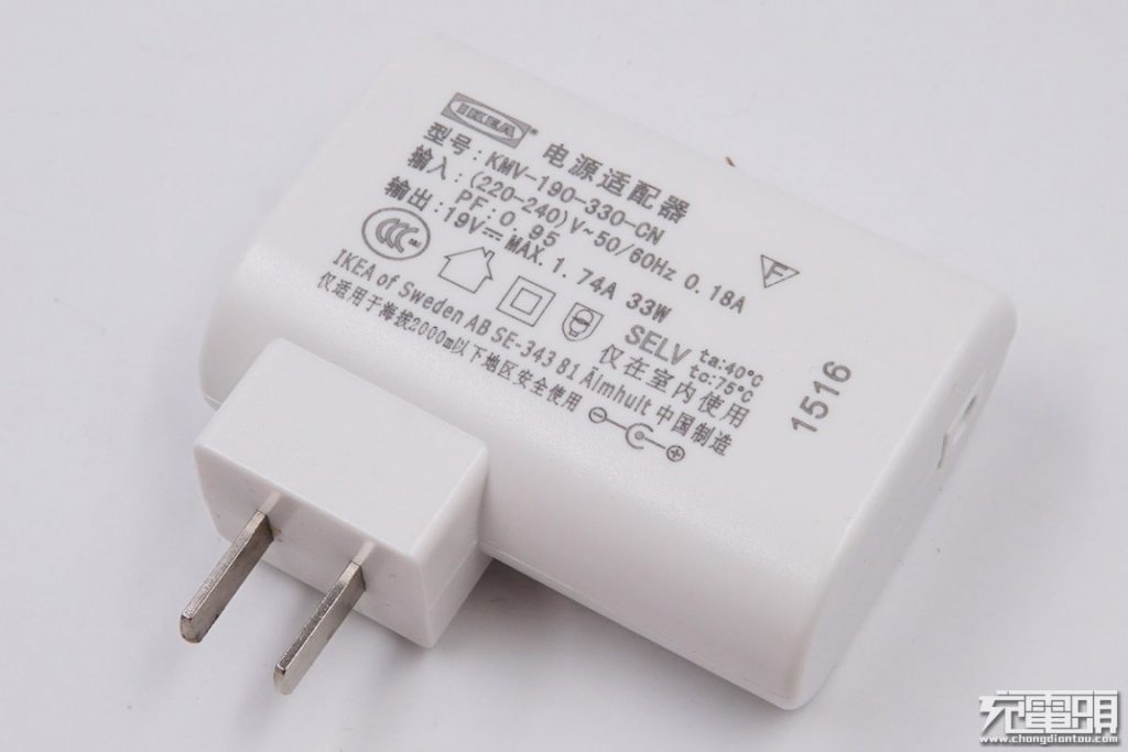

IKEA NORDMÄRKE Triple Wireless Charging Pad Teardown Review-Chargerlab

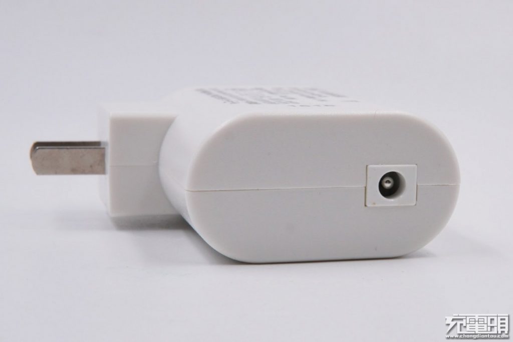

The included power adapter. Model: KMV-190-330-CN. Input: 220-240V, 50/60Hz, 0.18A, PF: 0.95. Output: 19V (Max), 1.74A, 33W.
It has a DC barrel jack, sadly not a USB-C port.

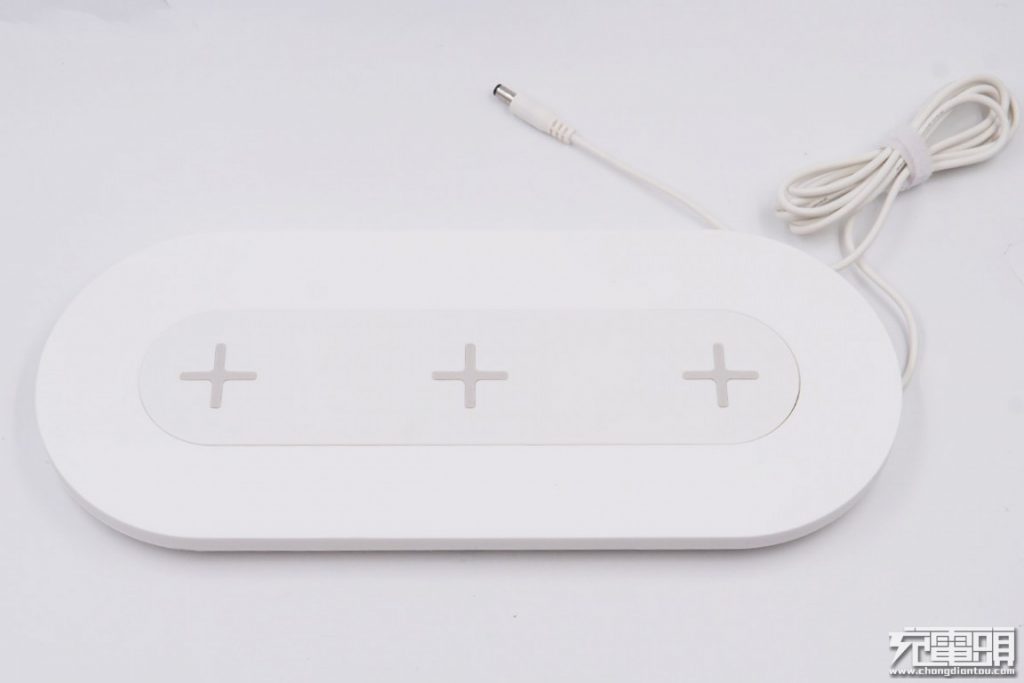

The NORDMÄRKE has a pill-shaped form factor with integrated cable design.

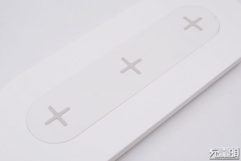

There are three wireless charging areas on top, and the three crosses indicates the center position of the wireless charging area while keep your phone on the right spot.

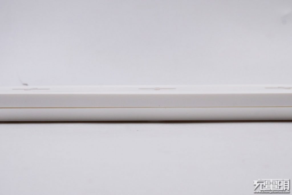

Taking a look at its sides.

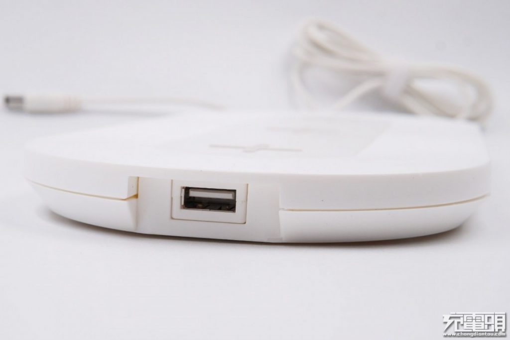

Extra USB-A port for charging output.

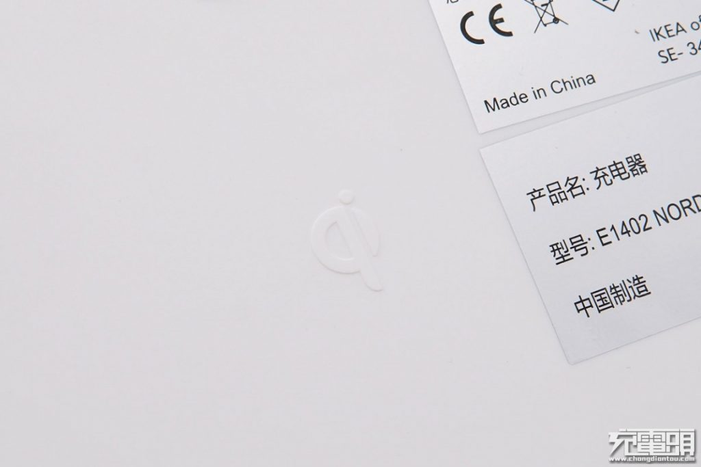

It is Qi certified.

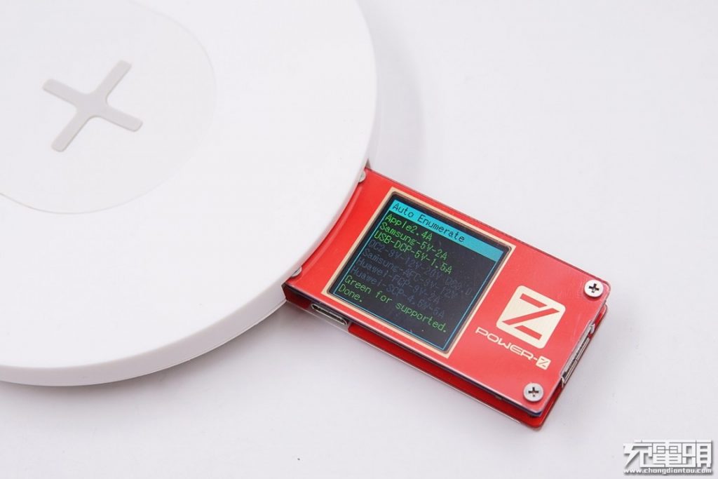

With ChargerLAB Power-Z KT001 USB tester, we know that its USB-A port supports Apple 2.4A, Samsung 5V2A, and USB-DCP-5V-1.5A.

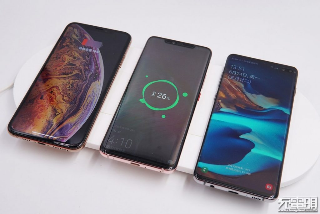

It can charge three devices wirelessly at the same time while charging a fourth device through its USB-A port.
Using the wireless charging aging tester, we read a "PFF" which means it passed the 5W test but fails the 7.5W test and 10W test. So it only supports normal 5W wireless charging.

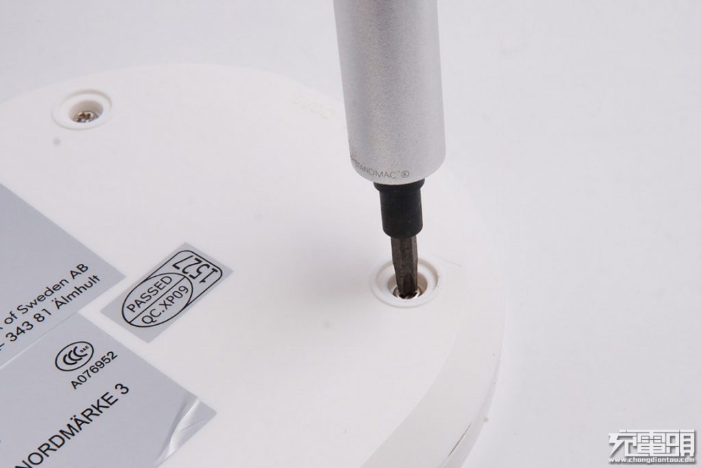

Remove the rubber pad on the bottom and remove the screws.

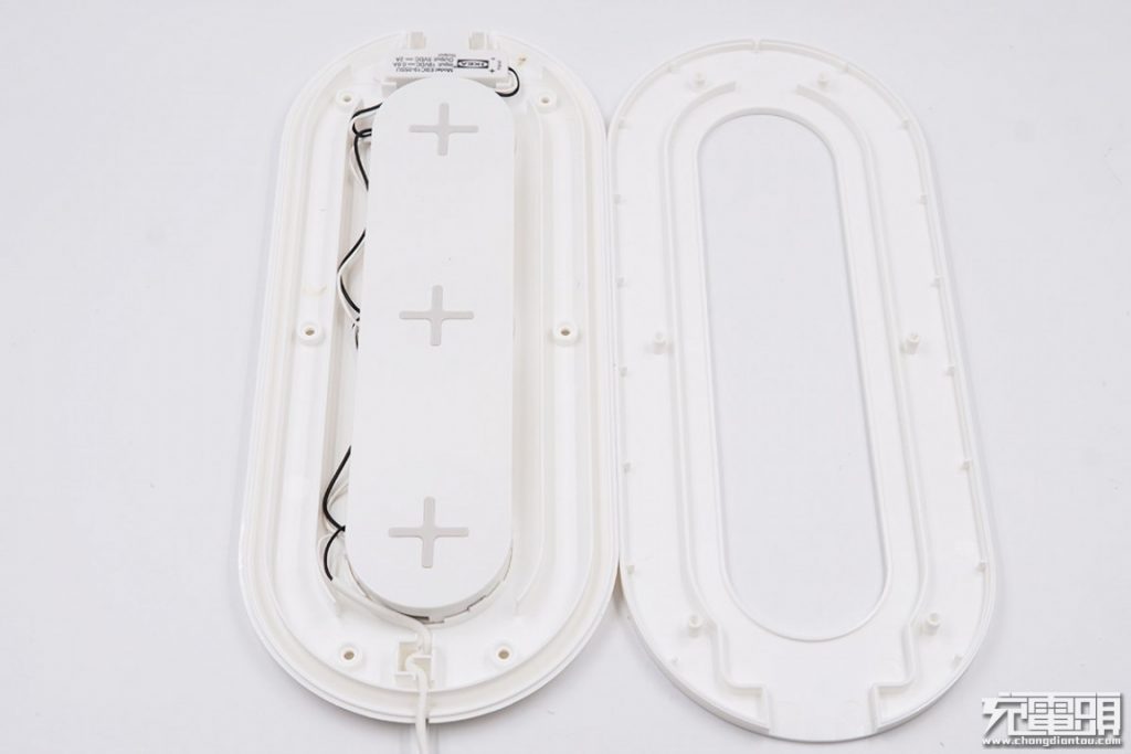

Remove the top cover.

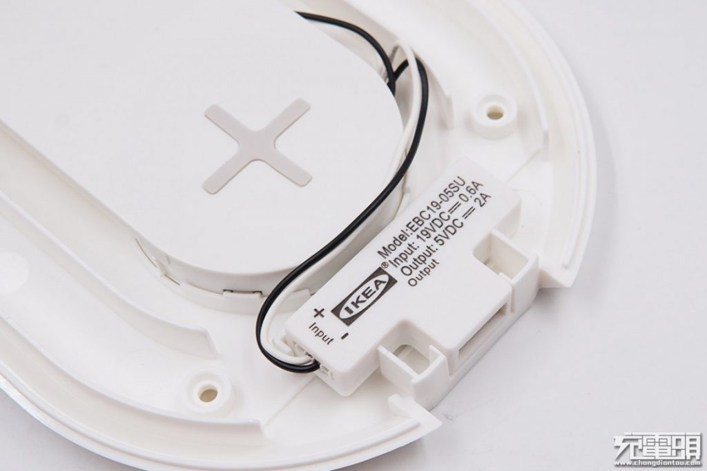

The USB-A port is capable of 5V2A charging.

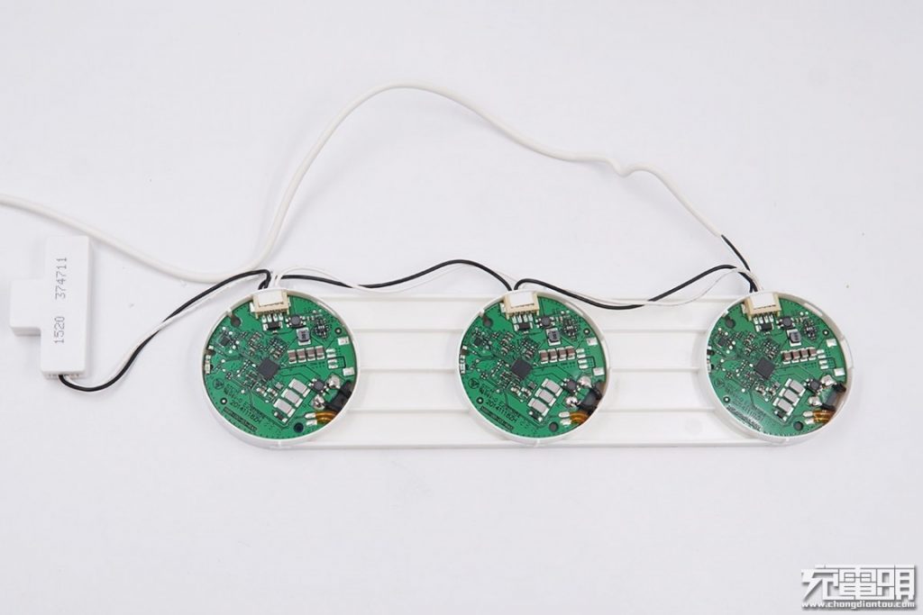

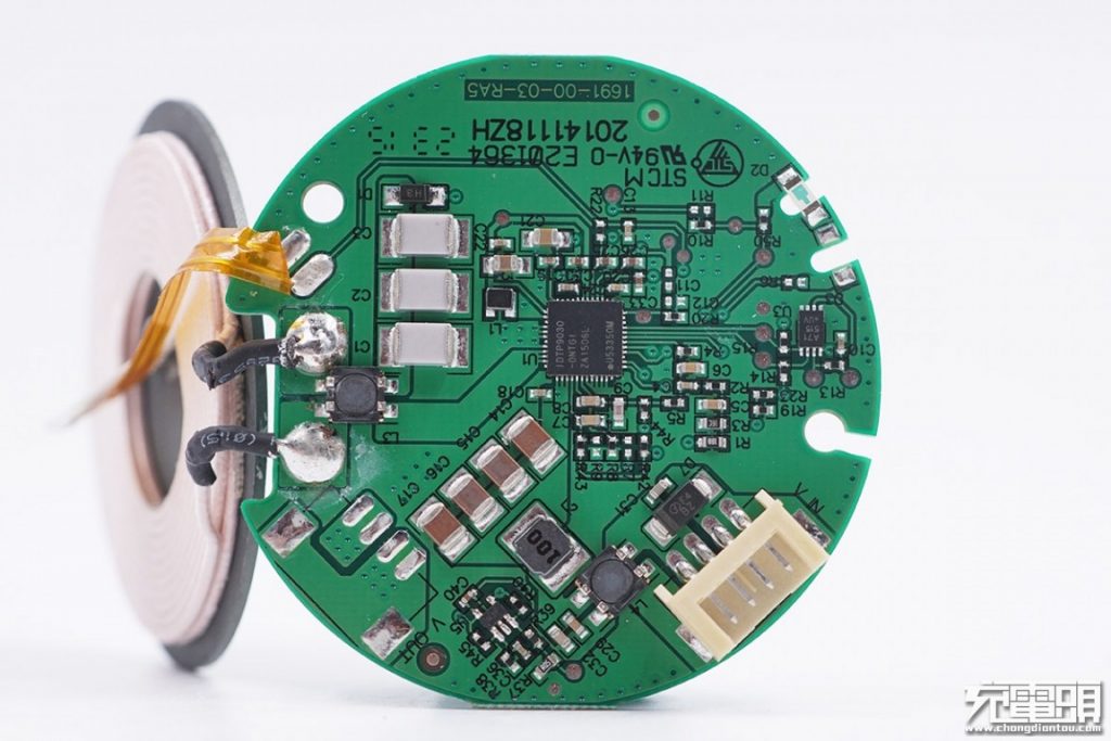

Remove the back cover and we can see that there are 3 independent PCBA wireless charging transmitter modules inside, which are connected in parallel by wires.
The three PCBA modules are exactly the same.

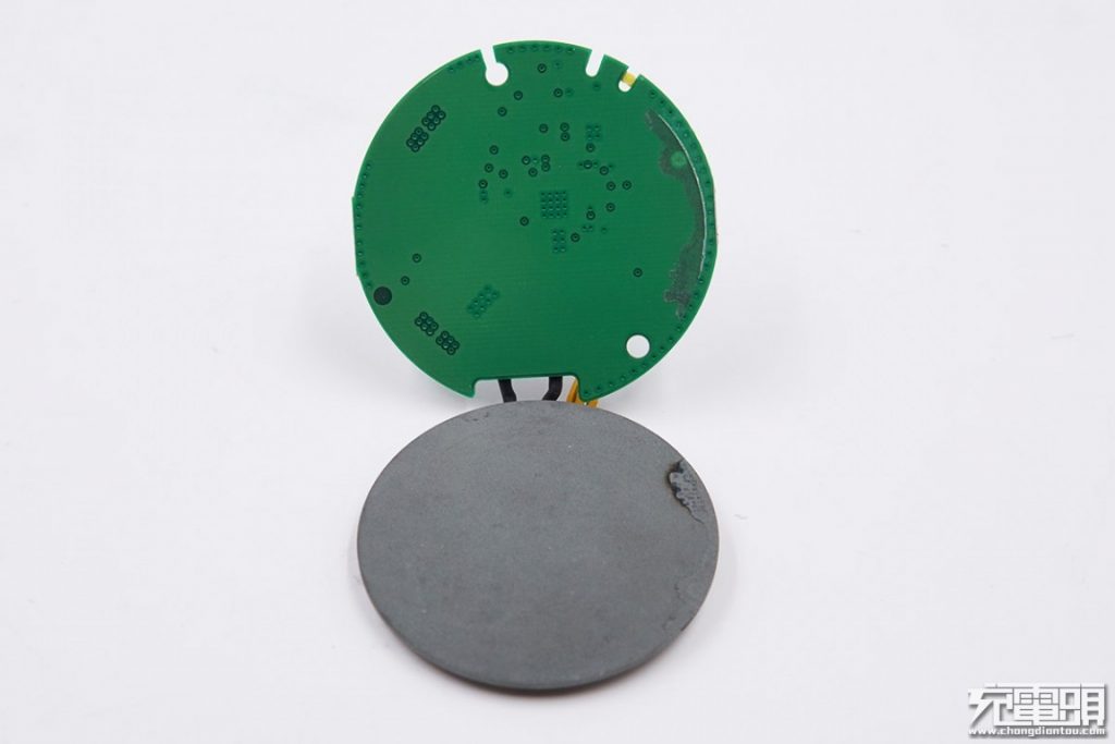

A wireless charging module includes a PCB circuit board, a coil, and a magnetic isolation piece.
There is no information behind the PCB and it is stuck to a magnetic shield.

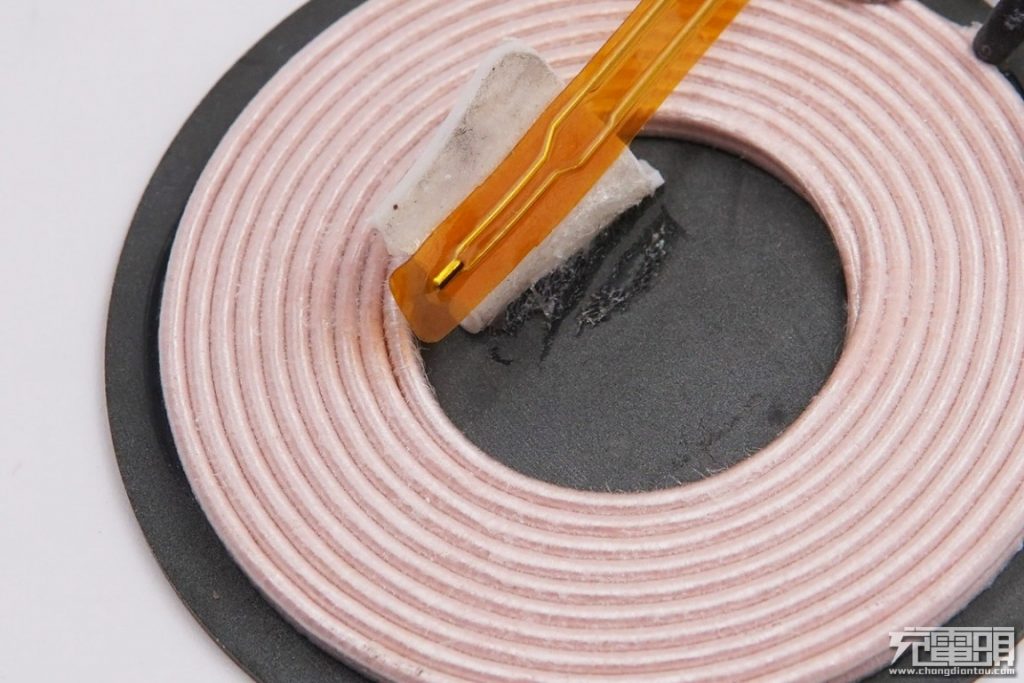

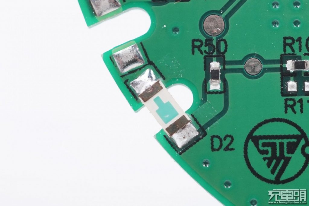

A temperature probe is attached to the center of the coil to monitor the temperature rise during operation.
The coils adopt a double-layer structure, and the coil stubs are protected by heat-shrinkable tubes.

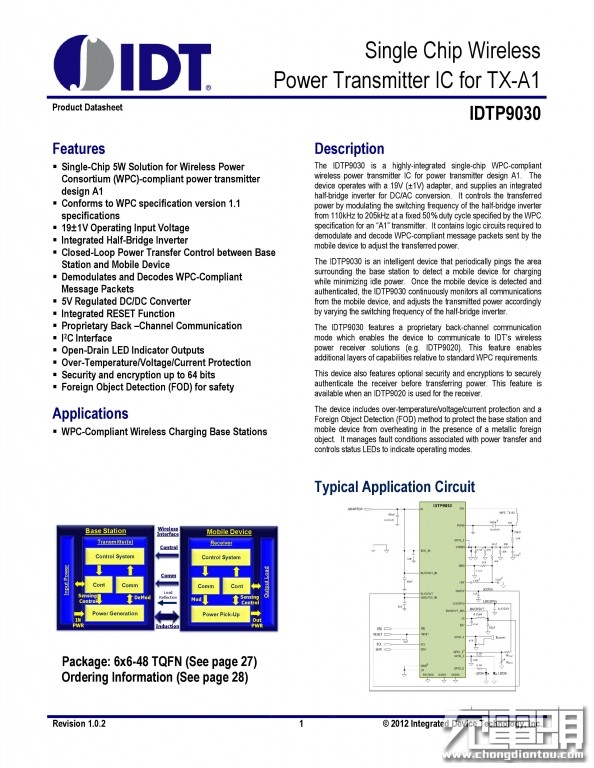

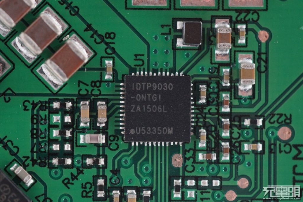

The IDT P9030 is a highly-integrated single-chip Qi standard-compliant wireless power transmitter IC for power transmitter design A1. The device operates with a 19V adapter, and supplies an integrated half-bridge inverter for DC/AC conversion. It controls the transferred power by modulating the switching frequency of the half-bridge inverter from 110kHz to 205kHz at a fixed 50% duty cycle as specified by the Qi standard for an “A1” transmitter. The transmitter contains logic circuits required to demodulate and decode Qi-compliant message packets sent by the mobile device to adjust the transferred power.
It is a true single-chip for wireless power transmitter solutions. With 5W specification, and up to 7.5W wireless power transfer in proprietary mode, it packs features including main controller, signal demodulation circuit, MOS driver and power MOS to minimize circuit design and reduce component count.
Detailed specifications of the IDT P9030.

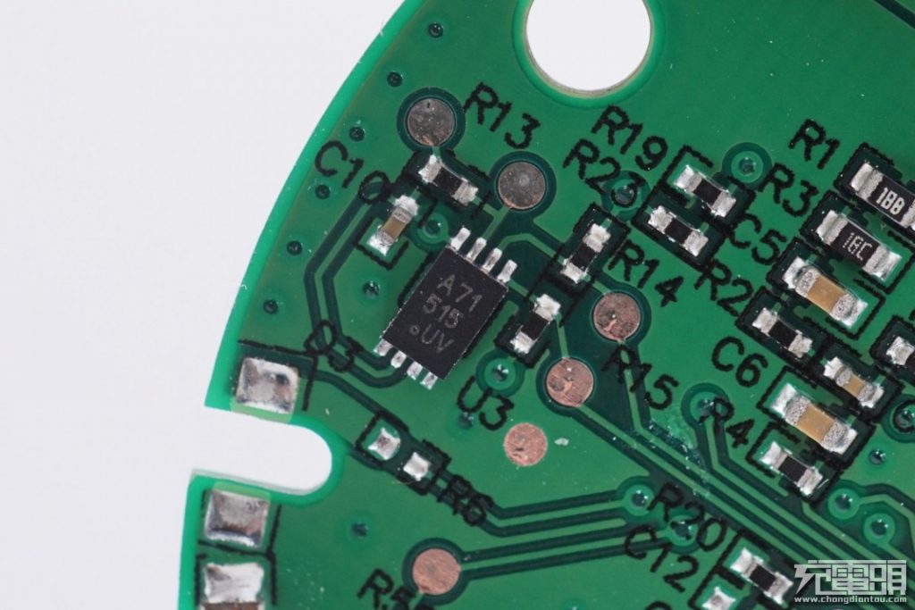

A flash memory chip to store wireless charging configuration data.

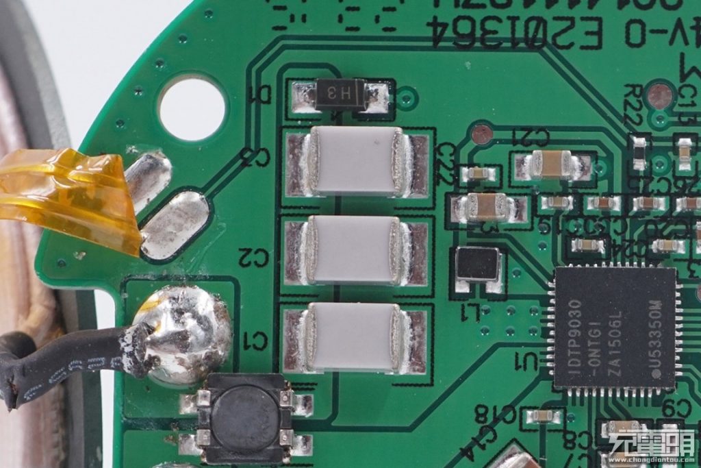

Three NPO ceramic capacitors.

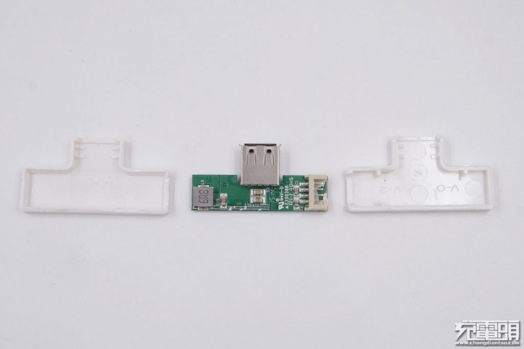

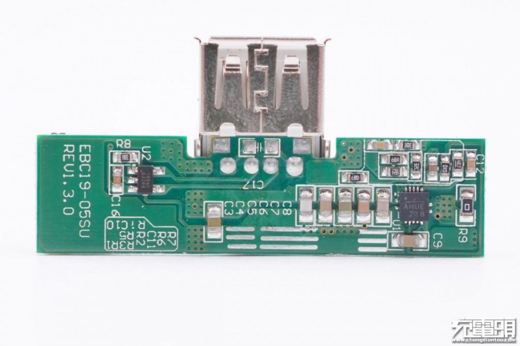

Looking at the USB output module, the PCBA board and the USB female socket are distributed in a "T" shape.

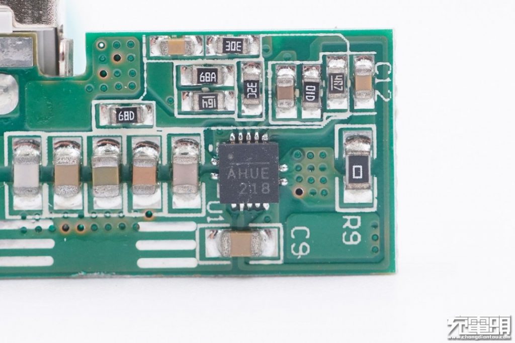

The chip with "AHUE" letter code is an MPS MP2312 2.1A high efficiency synchronous buck converter for USB port 5V output.
 Detailed specifications of the MPS MP2312.

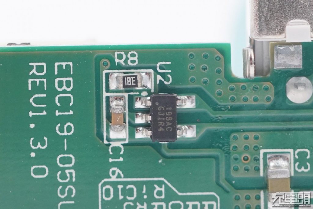

The chip with "198AC" letter code is a USB automatic identification IC.

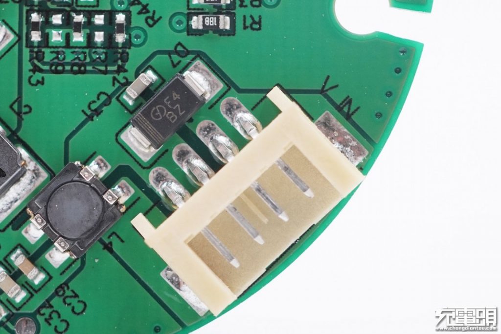

Close-up of the cable socket.

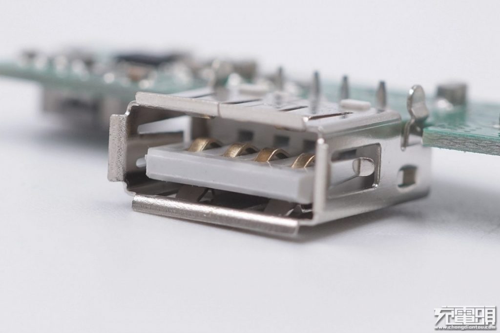

Close-of the USB female socket.
