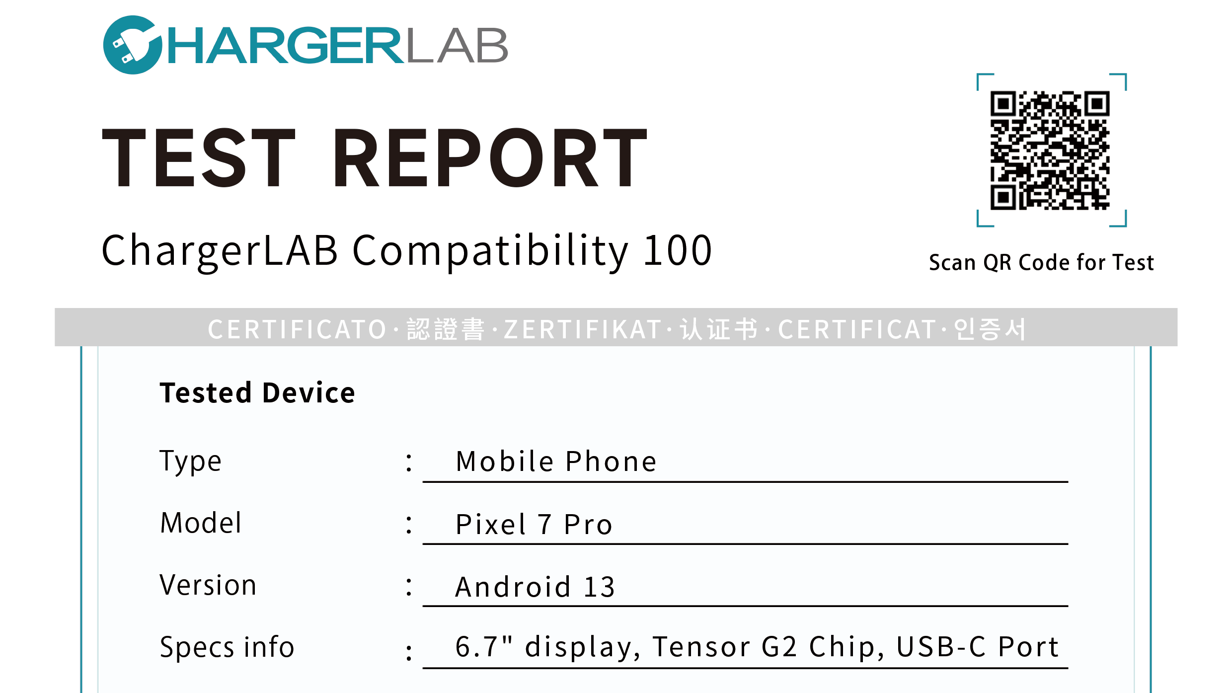

Charging Compatibility Test
The compatibility test segment provides a clear understanding of how the device charges with different devices. ChargerLAB will use 100 charging devices to charge the Google Pixel 7 Pro, allowing everyone to have a comprehensive understanding of its charging compatibility.

Overall, the Google Pixel 7 Pro performs well when paired with its original charger and cable, delivering the advertised 23W charging power, which is highly recommended. In terms of third-party chargers, ChargerLAB tested 80 different models and found no instances of low charging power or incompatibility issues. Most chargers were able to achieve power outputs of 20W or higher. However, it is worth noting that only one Xiaomi Wireless 10000mAh Power Bank exhibited compatibility issues. It is advisable for users who own this model to be aware of this issue.
While the charging power of this phone may not be as high as that of well-known brands like OnePlus, Xiaomi, or realme, its compatibility performance is commendable, and it can still be considered a "fast charging device".
