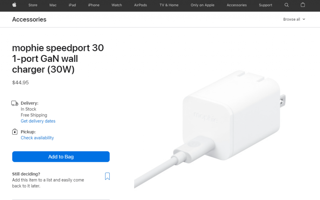

As a strategic partner of Apple for many years, mophie has launched a portable 30W GaN wall charger for iPhone, which has passed Apple's certification and is now available in the Apple store.

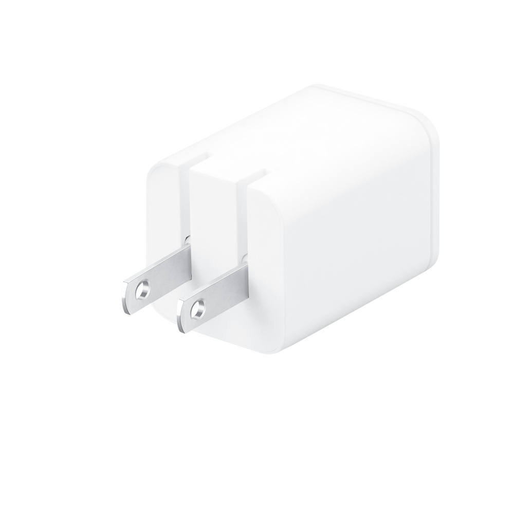

It adopts a white and frosted fire-resistant shell, with compact size.

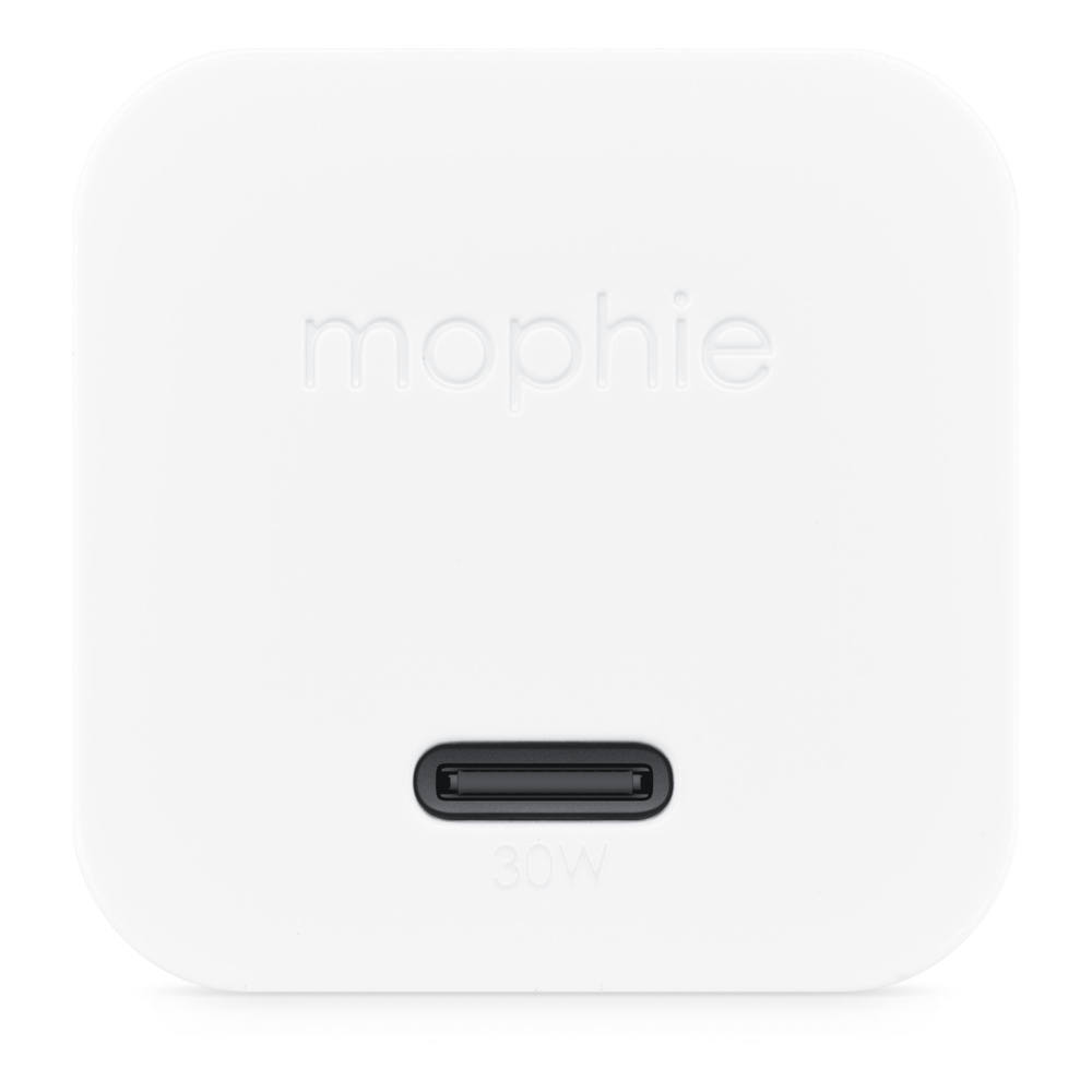

The glossy charger printed with the "mophie" logo and "30W, has a single USB-C port.

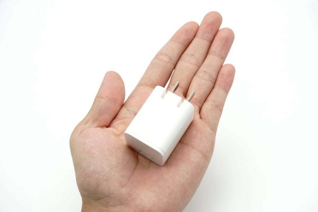

Its size is about 40.67 X 30.94 X 30.92 mm (1.60 X 1.21 X 1.21 inches), with the volume of 38.91cm³ (2.37 in³) and power density of about 0.77W/cm³.
The weight is about 48.8g (1.72oz), 56% smaller and 51% lighter than Apple 30W charger.

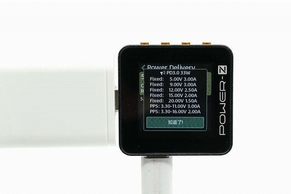

The ChargerLAB POWER-Z KM002C finds that it only supports PD3.0. And it also supports five fixed PDOs of 5V3A / 9V3A / 12V2.5A / 15V2A / 20V1.5A and two PPS of 3.3-11V3A / 3.3-16V2A.

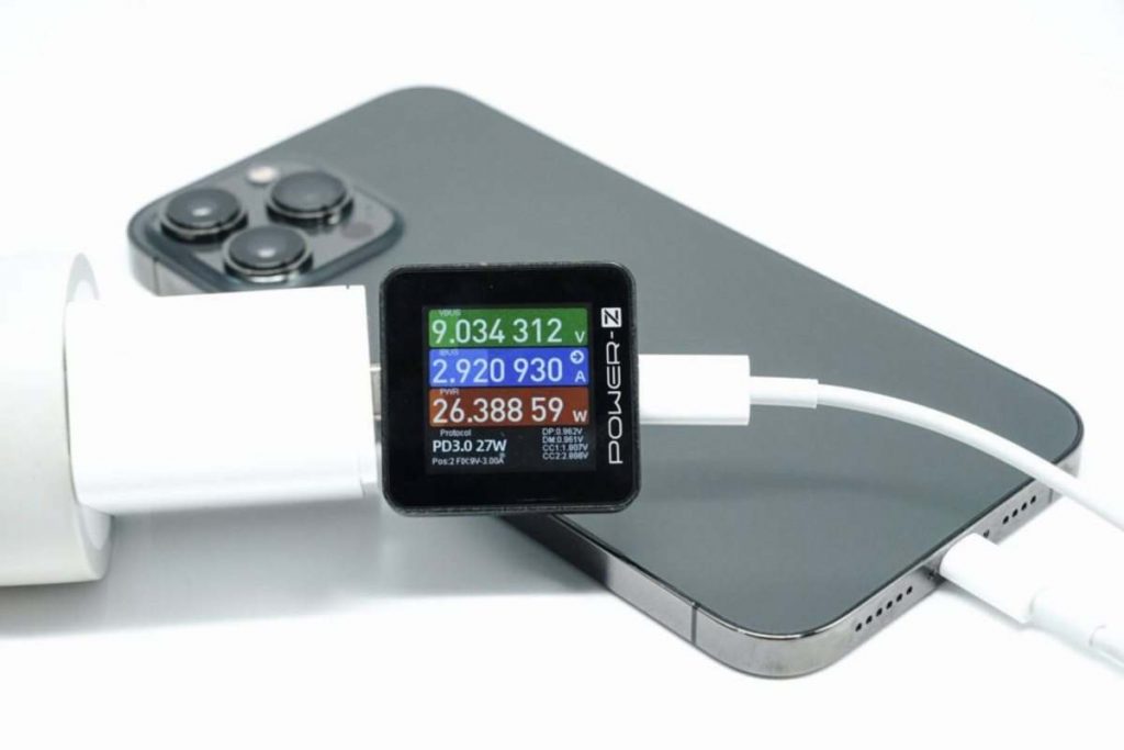

When charging the iPhone 13 Pro Max, it triggers a handshake of 9V PDO with a power of 9.03V 2.92A 26.38W, reaching maximum output power of the phone.

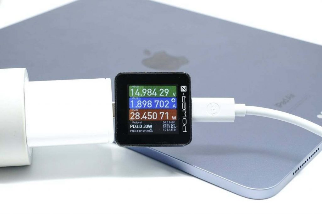

When charging the iPad Air 5, it triggers a handshake of 15V PDO with a power of 14.98V 1.89A 28.45W, reaching maximum output power of the charger.
