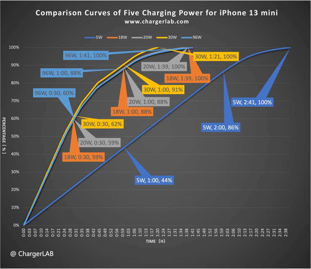

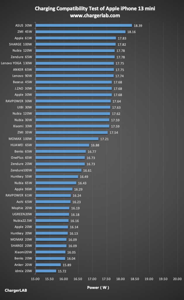

Since we published the charging compatibility test of Apple iPhone 13 Pro Max, many people are asking to see the same tests of other models, as well as the charts. So, we will release the compatibility test and its detailed data of all the models, including iPhone 13 mini, iPhone 13, iPhone 13 Pro and iPhone 13 Pro Max. Let's go.
Here is the comparison chart. We can see most of the 20W+ charger can perfectly support the fast charging. And the 30W charger will No.1, which save approximately 20mins than 96W.
