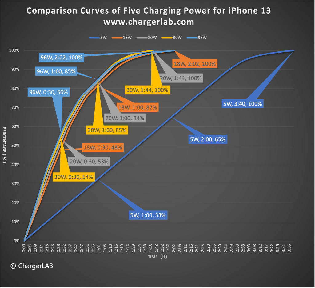

Since we published the charging compatibility test of Apple iPhone 13 Pro Max, many people are asking to see the same tests of other models, as well as the charts.
So, we will release the compatibility test and its detailed data of all the models, including iPhone 13 mini, iPhone 13, iPhone 13 Pro and iPhone 13 Pro Max.
Let's go.
Detailed Data & Charts | Charging Compatibility Test of Apple iPhone 13 (20W-100W)-Chargerlab
We can see the fastest charger to fully charge the iPhone 13 is Apple 20 & 30W power adapter, which is quicker than 18 & 96W power adapter.
So, there is no need to prepare the high-power charger. 20W & 30W is pretty enough for iPhone 13.
