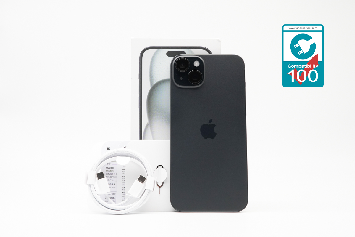

Equipped with the largest battery in the entire series and a 60Hz refresh rate display, the iPhone 15 Plus unsurprisingly has the best battery life among all models in the iPhone 15 series. However, what about the charging compatibility? Is it still the best? With the fourth installment of our ChargerLAB Compatibility 100 tests for the iPhone 15 series, which is also the final one, we will provide answers to this question.
Charging Compatibility Test
ChargerLAB will conduct a comprehensive test on the compatibility of the iPhone 15 Plus, evaluating its performance with a selection of more than 100 charging devices. These devices include Apple chargers, third-party chargers, power banks, and portable power stations, aiming to cover the majority of users' charging scenarios.
Apple Chargers
First, the iPhone 15 series has specific pin requirements for USB-A to USB-C charging cables, and even cables from the same batch may experience charging issues. So for now, we are only assessing the charging compatibility performance when paired with USB-C to USB-C cables (with some margin of error).
