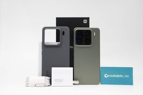

90W Wired + 50W Wireless | Charging Review of Xiaomi 15 Pro-Chargerlab
The box contains the phone, a 90W charger, a USB-C cable, a phone case, and some documents.
