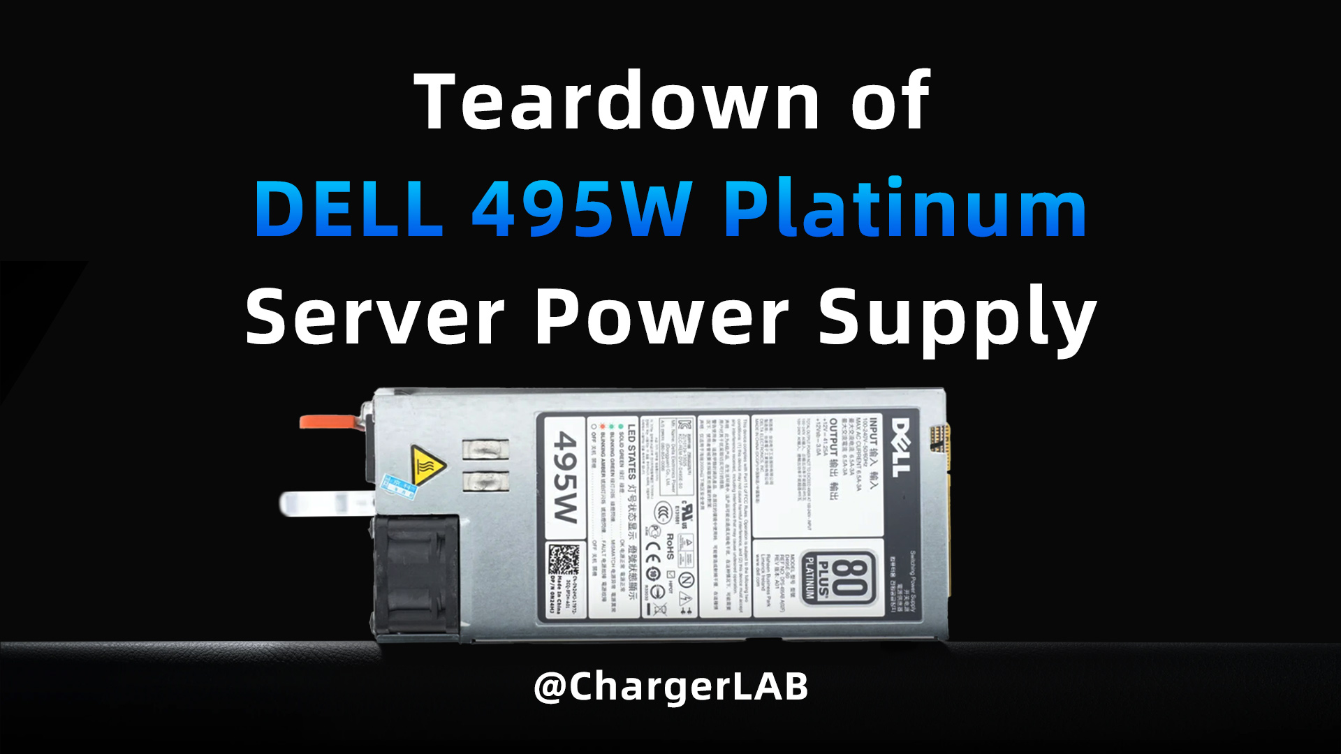

Today, we got a server power supply from Dell. It has passed the 80 PLUS Platinum standard and supports up to 495W. We're curious about the internal components of this power supply. So, let's take it apart and see how it differs from the laptop power adapter.
Model: D495E-S0
