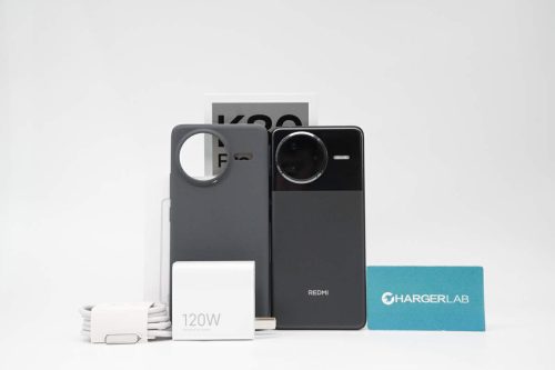

With the release of the REDMI K80 series, ChargerLAB got the REDMI K80 Pro as soon as possible. It is equipped with a 6000mAh battery and 120W wired fast charging. At the same time, it is equipped with Qualcomm SM8750-AB Snapdragon 8 Elite and has strong gaming performance. Let's take a look at the performance of this phone.

The box contains the phone, a 120W charger, a USB-A to USB-C cable, a phone case, and some documents.
