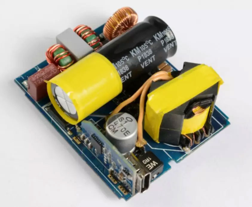

45W-ACF-Conventional Transformer
1. Dimensions: 48mm*38mm*18mm
2. GaN: 650V/200mΩ + 650V/200mΩ
3. NCP1568 (controller) + NCP51530 (driver)
4. NCP4306 (Synchronous Rectification on the Secondary Side)

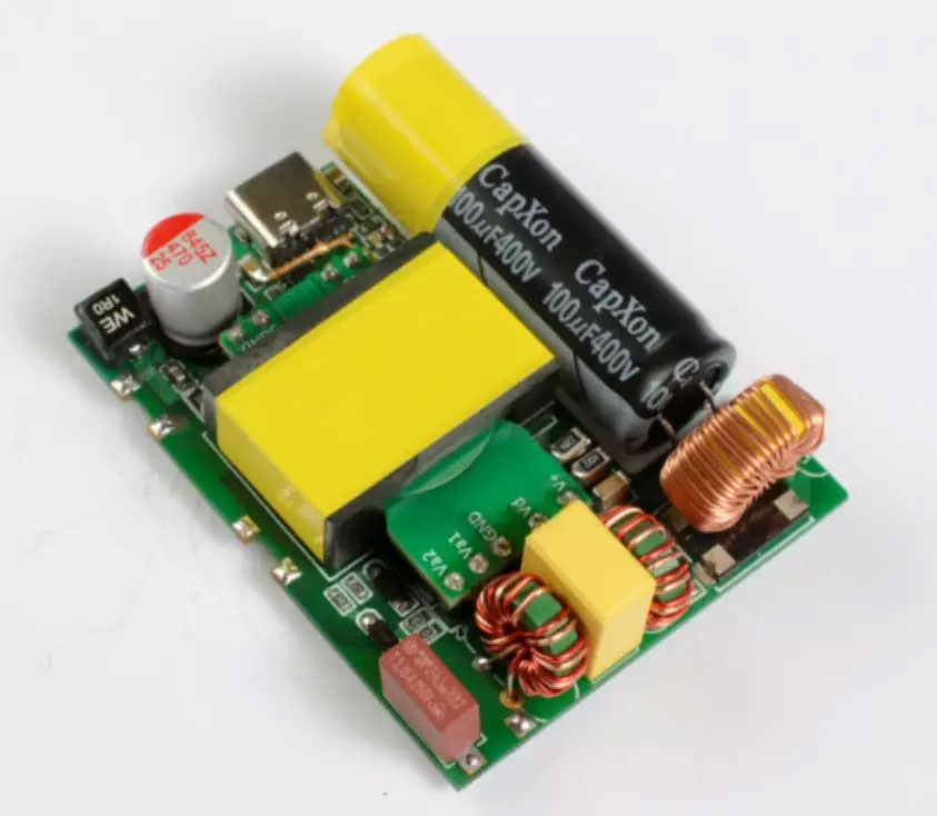

65W-ACF-Planar Transformer
1. Dimensions: 55mm*44mm*13.5mm
2. GaN: 650V/200mΩ + 650V/130mΩ
3. NCP1568 (controller) + NCP51820 (driver)

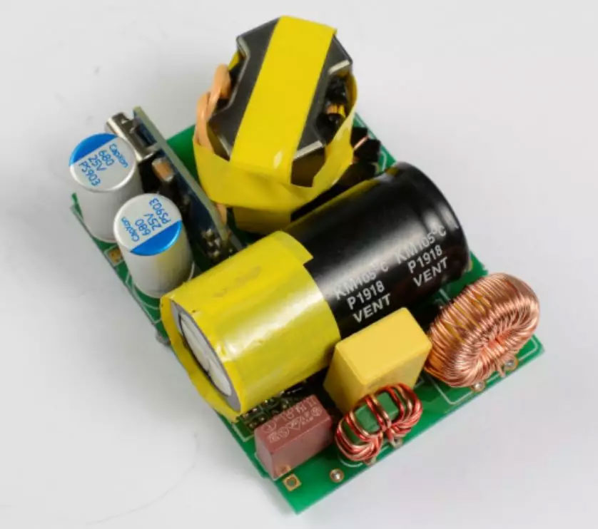

65W-QR-Conventional Transformer
1. Dimensions: 51mm*38mm*21mm
2. GaN: 650V/130mΩ
3. NCP1342 (controller) + FAN3111E (driver)
